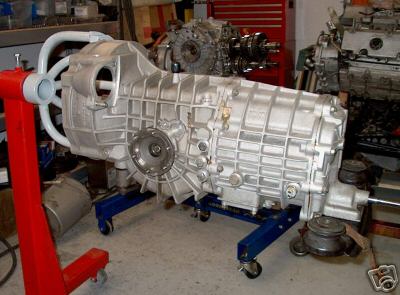

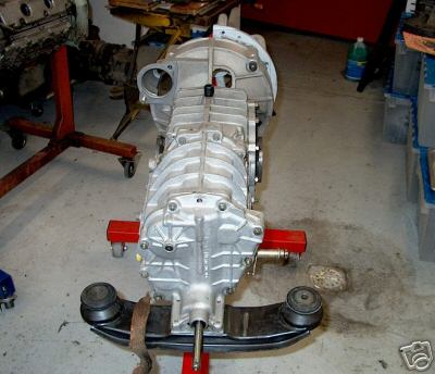

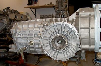

With some luck and help from a couple of friends I scored this 930 with LSD and short ratio R&P for an excellent price. Should be on the way to me next week for the Lola.

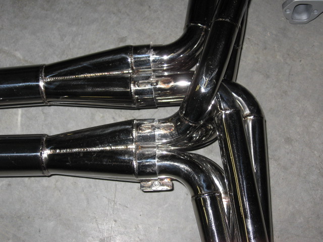

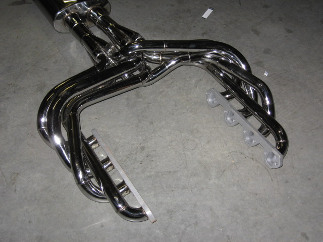

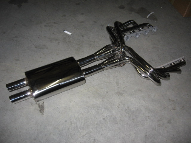

The RCR fairy brought some headers to me for the Lola and they are very very nice! Just delivered them yesterday at my work and I unpacked them for a picture.
My garage is getting "cleaner" with three of my Z motor blocks out of there, so I'm hoping to put these on the engine with the 930 and adapter plate in the next couple of weeks. Very nice work on these, they look great and I like the flange that runs down the entire side of the head as opposed to a non-connected indivdual pipe deal. I had a set like that once and they were hard to get to fit, I bet these will bolt up with little drama.

Re: Build Diary - RCR Lola T70 Spider
Beautiful tubes!
Are they polished SS or chrome?
I wonder how long they'll remain shiny?
Polished SS 304.....I personally like SS to turn gold and burnished looking...
Randy,
Keep polishing and they will stay shiny....want to add some to your order???

Mike, I called Dan and he said it was cool to run crossovers, he was okay with it when it was his turn to drive.
I'm with Fran on the headers. I hope these don't remain shiny, but get that nice SS heated look over time. Right now they are polished as RCR delivers them. I hope to avoid coating them for heat issues, but we'll see how they sit with the Lola rear clip. The Lola is quite a bit lower than a GT40 and we need to see how they fit with all the other bits that are going to be in there. I think it'll be okay, but want to test fit first.

Wipe them down regularly with WD40 and the heat will bake them to a lovely golden hue.

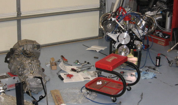

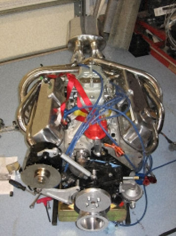

Well, work has started back on the Lola. Summit and Jegs are in full effect on my credit card bill, and things are happening. I've a new motor for endurance racing and that motor is getting dressed up with all the bits it needs, as well as getting mated with the 930.
The motor is a Ford 302 with Edelbrock heads, air gap manifold, and just got a 650 Demon carb. We're not expecting more than 300 hp with the motor but I am expecting it to last a long time and not consume huge amounts of fuel. It will also be quite drivable I think in the car and the hydraulic cam will fit decently with the 930 ratios.
Headers on are, Demon 650 is on, new alternator attachment scheme (and yes it is anchored in three places now and has a nice turnbuckle style adjustment). Later today when I've got some help the 930 is going on the plate and the assembly is going in the car.
We're behind on caging this thing, some due to delays on my end and some with my cage builder, but it is supposed to go down to Steve next weekend if my schedule allows. Steve is an SCCA Tech Inspector, as well as fabricator. Not only is he a fantastic fabricator, excellent racer, but he can issue the car a SCCA Logbook as well. All important steps in making this car something that is hard to do - a licensed street drivable car as well as a logbooked race car.

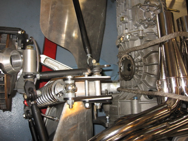

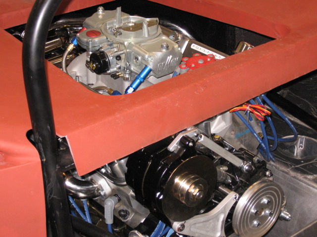

Six more hours have passed and the motor has wires, 930 box, mounts etc. and is in the car. We pulled the mounts off the chassis from the Audi position, put them on the motor, set the motor in place, measured, measured, measured to make sure all was square, and marked the mounts. Out comes the whole thing, drill holes, bolt in motor assemble, and there we are - motor and transaxle in the car.
We got the motor really foward this time. The front crank pulley is only about 1" from the lower part of the chassis. Very square, and the motor is much lower than it was with the Audi transaxle, the pan sticks out of the bottom of the chassis about 1/4" and is about perfect as far as I can tell. Air cleaner nicely centered in the deck opening.
But.
It is too far forward. I thought to call Fran and tell him what a great job we did putting in the motor. I should have called about some guidelines on fitting the 930.
Have a look at that picture below. On the RCR cars the motor plate area for the starter should be flush with the BACK side of the chassis. Mine is front with the front side.
So, we get to do this all over again and push the motor back. If we don't a starter will not fit there and unfortunately I didn't have a starter to put on the motor or I might have seen that. Lesson learned - call someone who might know. Motor fitting shot down about 3 hours I suppose, but it'll be faster next time. Maybe the new position will line up with the Audi mount plate holes........
