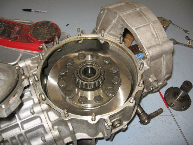

Here are a couple of pictures that might be interesting. One of the bolts on the 930 box is captive and you have to remove the side plate to get it into position. I think when the box and motor come apart for installation of the clutch I'll use studs to mount the box and avoid this issue. The other one is of how close I've got the assembly to the lower part of the chassis. Alternator again is my bane as it is way too high and I need to mount lower.
Ron

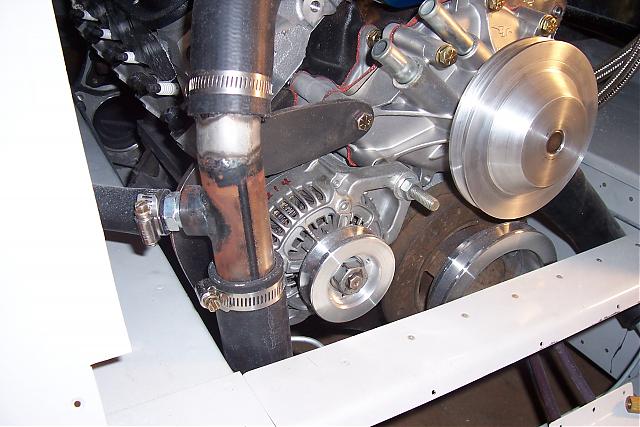

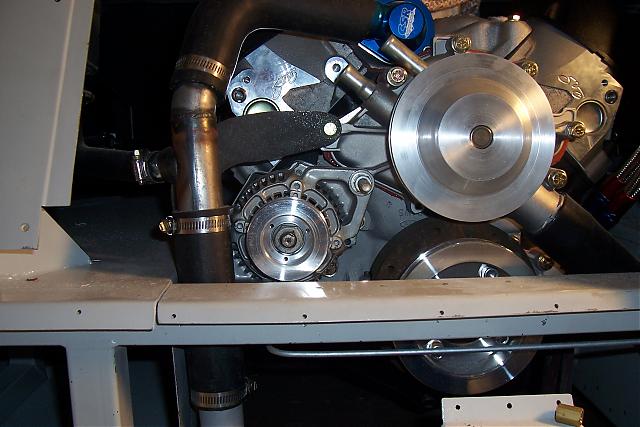

Your Lola is looking great. I used a Ford shorty water pump and a top pully that is dished to the engine side placing the alt. and belt back further. Would that buy you anything? It gave me a few inches more to work with. I also used a GEO alt. that is very small which gave me additional room. Nice headders!!!
Steve

Uhhh, you might want to drill some holes in that water pump pulley and stick some bolts in it, it'll help turn the pump! Just kidding!
Thanks for the shots there. I like that alternator setup - I might be able to do something like that, let me look. And what pulley set did you use? I had a dished set but it would not fit on the shorty water pump, the pulley would hit the water pump without a ton of spacers.

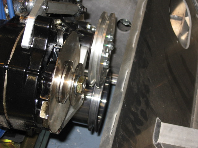

I had to make the water pump pully but just as I was finishing it I found one that would work from Zoops. I left out the bolts so I would have less rotational mass!! I tried to use the March set you have and it would have caused a very large bulge in the firewall so I made the one you see. Zoops makes a set for the Ford shorty pump you are using. I will see if I can find a link to send you. Your car is looking great.
Update:
Just went to Zoops and they don't make a pulley like mine. I can send you the dimensions if you would like to have one made. The crank and Alt. pulleys are March, I can send you the #'s if you would like. Sorry Also, if you want the year and model for the Alt. let me know and I will get it to you.
Steve

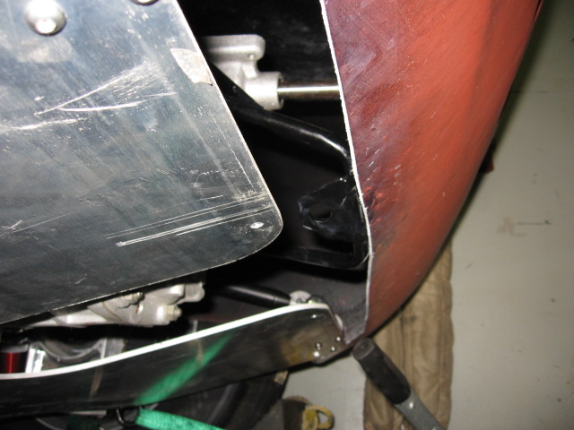

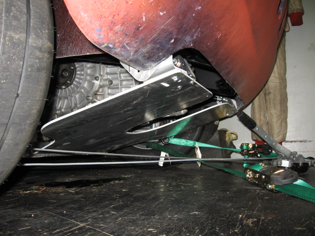

Well, it has been a long time since an update. I was to have the car at the cage guy I'd waited a long time for but that isn't going to work out. He had a serious family issue that isn't going to be resolved in the near term therefore I'll need to formulate another plan.
I did shoot some pictures of the car on the trailer though, around the rear area that shows how things are setup for transaxle and rear clip, it looks good. The rear clip is about 1/2 pushed back from where it will end up but that shouldn't pose a problem. The shifter for the back of the 930 will need to be shortened a tiny bit, but not by much. The headers have TONS of room under the rear deck, about 3" or more, so that is not a worry. Quite happy with how all of that went together and it should work well.
Ron

Malcolm's Avatar
Malcolm

hey Ron, is that ali sheet the start of a diffuser?
Malcolm

Ron Earp's Avatar
Site Administrator
Posts: 3,998
Re: Build Diary - RCR Lola T70 Spider
It is the standard RCR ally piece that fixes the rear clip and is bolt to the chassis and also supported by adjustable stay rods. We are going to put some vertical pieces on it as a diffuser and simply copy a "supercar" diffuser design as best we can. Why not, it's there and is perfectly suited for that duty.
R
