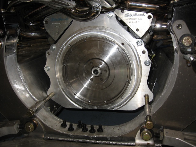

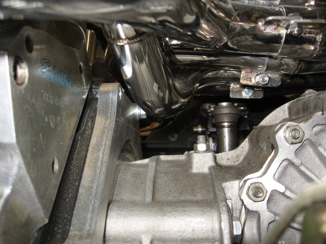

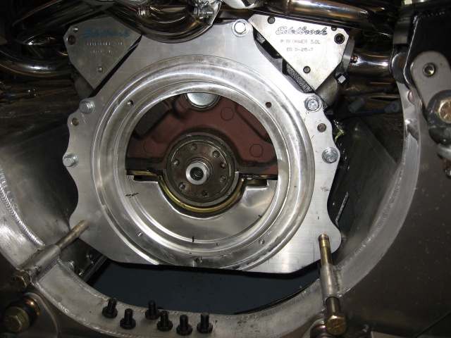

Well things have calmed down with travel, sickness, and other family events and a bit of Lola work was done. We removed the transaxle today and put on the proper adapter plate that RCR supplied to replace the old one. Also put on the flywheel and so as soon as I can round up clutch parts we'll be ready to bolt the transmission back on and move on with stuff.
Also spent time routing water pipes, replacing all the header bolts with good stuff, and replacing all the suspension bolt hardware with some high quality standard hex head bits. The allen bolts were fine, but I could see me getting into a situation and not having a proper tool or proper access.
Man, this is one hell of a stiff chassis as we noticed while jacking the car around today.
Tomorrow I plan to do the fuel system up and decide once and for all how I'm going to route it and what hardware to use.
Please to be back working on the car after a long break (needed from working on cars at all after last race season!).

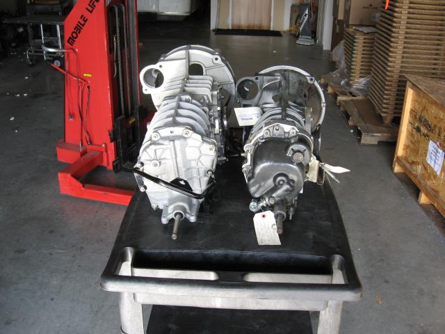

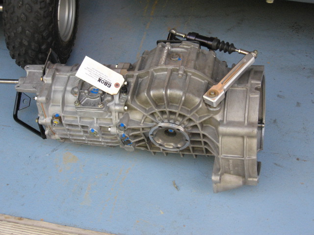

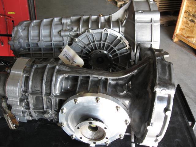

I’ve recently received my 930 box back from Gbox. Gboxweb.com specializes in Porsche boxes and their vendor representative on GT40s.com, Ryan Zielinski, is a frequent poster on the site.
The main reason I sent it to Gbox was for a robust slave cylinder conversion. But, while it was there they disassembled the box completely, inspected it, replaced a few bits, and gave it a clean bill of health. This particular box has the rare 8:41 R&P, or 5.12 ratio, that is highly desirable for a racing standpoint. I was impressed with Gbox’s service on my 930 as the box came with a full report of the inspection and procedures performed. The box ended up to be in good shape with some wear on the 2/3 synchros, so, they were replaced when they were in there.
Gbox also rebuilt my buddy Ed's 915 box, in fact, both went to and from Gbox at the same time. Ed’s 911S box needed a complete rebuild from about 100k miles of hard street use and Gbox performed that service as well. Man is that box small compared to a 930, but looking good now1
The slave cylinder conversion is shown below in the pictures and is a nice piece. It has a billet arm and a pull slave arrangement mounted on heim joints along with a reinforced anchor point. Looks like it’ll do the job and I think Gbox will be offering this as a kit since it requires no real machine work to the box itself. Thanks for the work Ryan, quite impressive!

Looks great Ron!
That Clutch Release arm looks stout as all get-out..
Now that you have the starter issue figured out and your transmission is ready to go - You should be ready to race in no time!

Hey Ron, just check out your thread and saw the clutch lever stuff that Ryan did, looks really nice. I have the slave bolted to the case but that looks much more robust.
Hope things are rolling, get some pictures up so I can check out the trans and axles etc.
