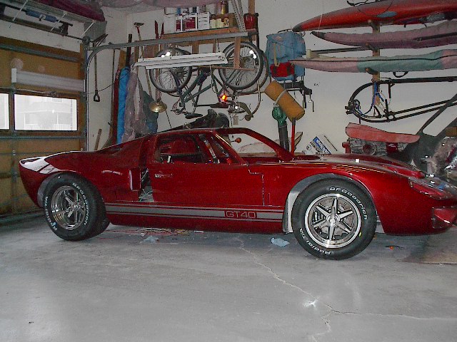

Time for me to start a build page. My car arrived yesterday at about 4:00. The quality of the body is outstanding. The part lines are tiny and the panel alignment is dead on. The chassis and frame are works of art. Here are some photos of my GT40 in its new home:

Way to go! Another RCR GT40 has made its way to it's new home. Congrats!!
Now, tell us your build plans.
