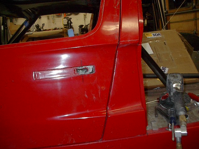

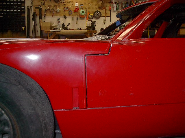

I have finally gotten back to work on my car. Fran got the hinges to me a couple of weeks ago and I have finished mounting and fitting one door. The other door is mounted but not fitted yet. The gaps are pretty good. It took quite a bit of patience to get the doors properly trimmed but I am happy with the results. Here are a couple of shots:

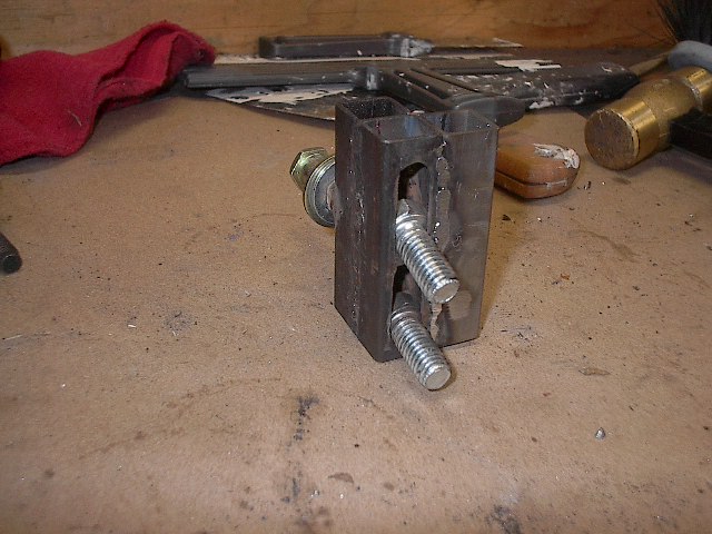

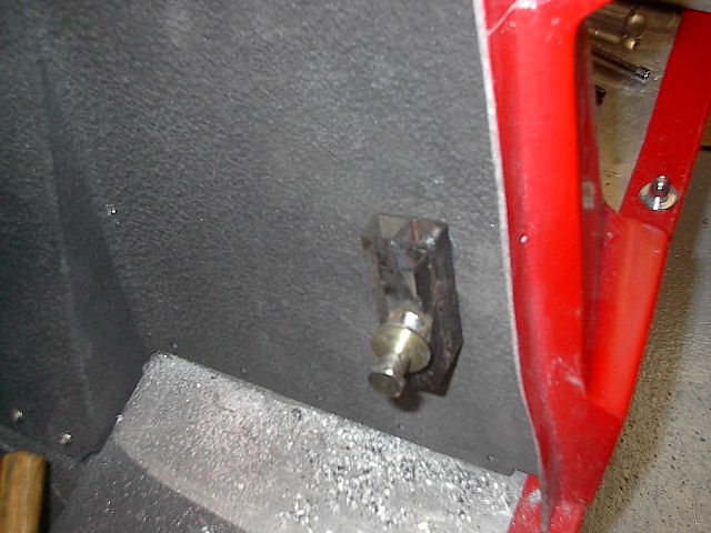

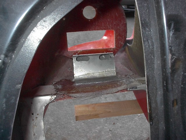

I had to shim the door striker out 2 inches so I built the shim to allow adjustment. The shim has a vertical slot and the firewall has a horizontal slot for full adjustment. Here are some shots of the striker:

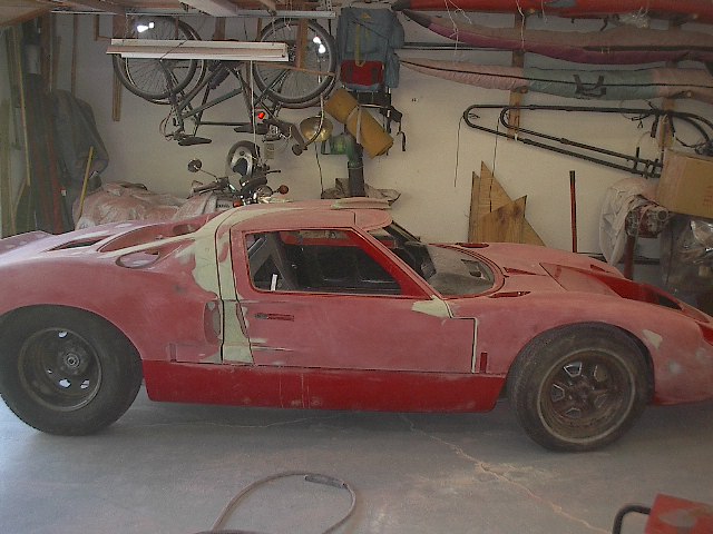

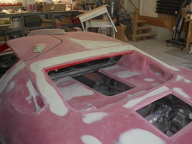

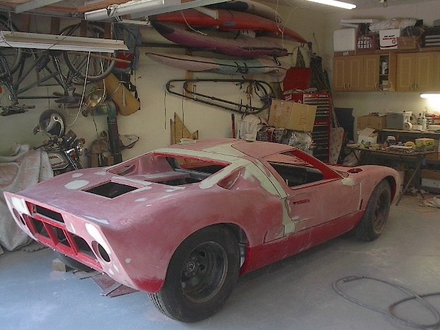

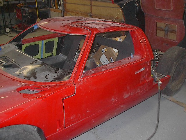

I have not posted for a while but I have been hard at work. I have most of the bodywork done. I should have the car in primer within a week. Here are some photos of my progress on the bodywork.

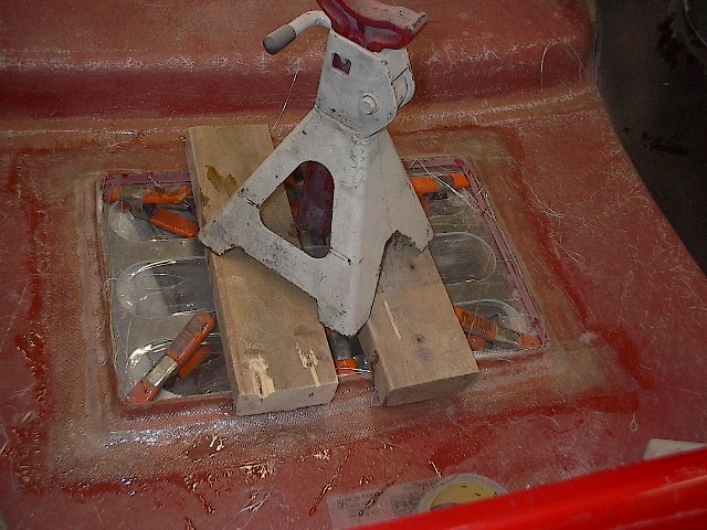

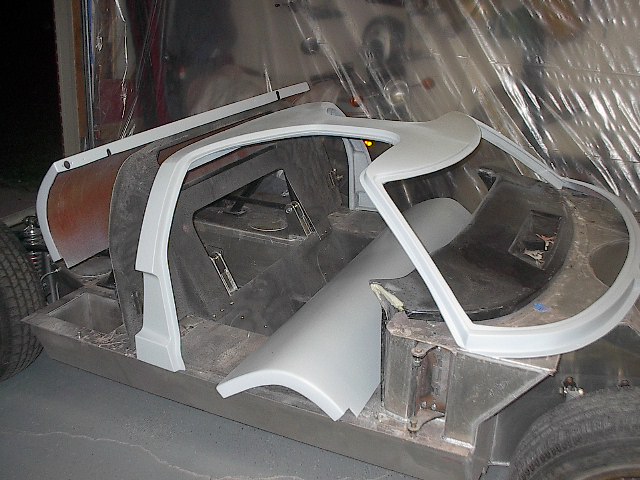

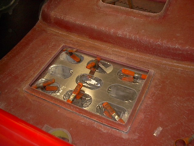

I decided to modify the rear deck so that the plate would sit flush. Fran supplies a cover cut from plate but the deck is taken from an original car so it is set up for sheet metal. I cut out the lip and reglassed it to get a deeper recess. Here is a shot of the progress:

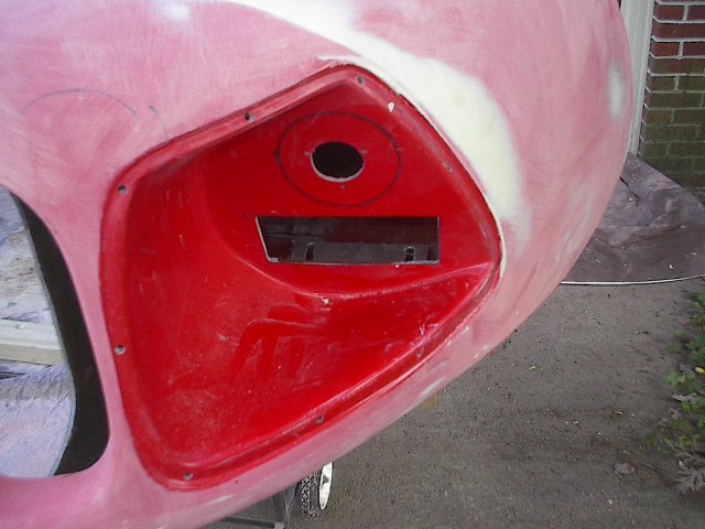

I also did the cutouts and fabricated a mount for the fog lights. Here are some pictures (the front clip is upside down in these):

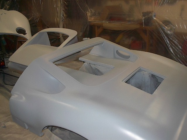

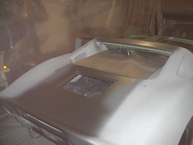

I finished priming the car. Here are some shots:

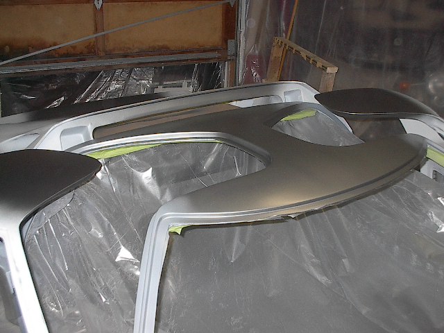

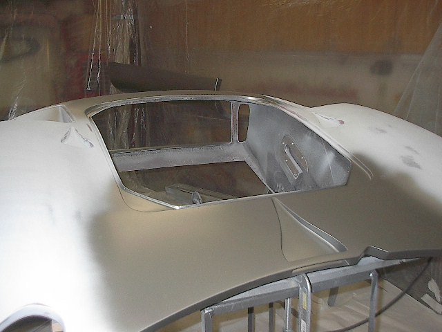

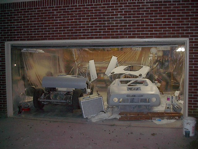

I started painting today. I put down the silver for the stripes. Here are a couple of photos:
