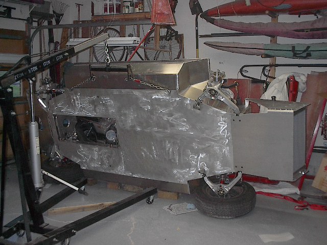

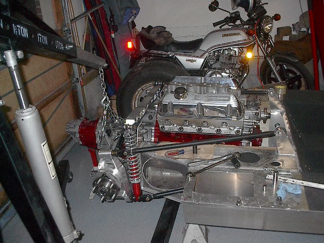

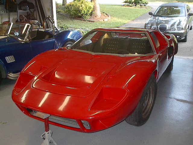

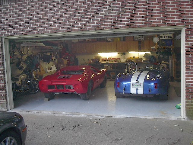

Time for me to start a build page. My car arrived yesterday at about 4:00. The quality of the body is outstanding. The part lines are tiny and the panel alignment is dead on. The chassis and frame are works of art. Here are some photos of my GT40 in its new home:

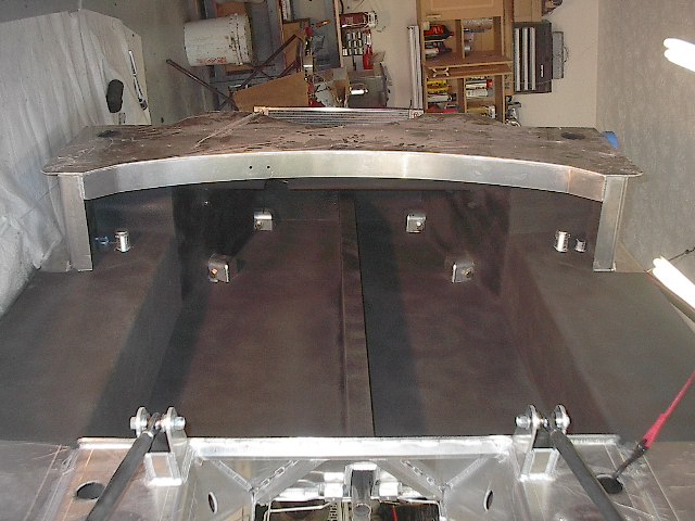

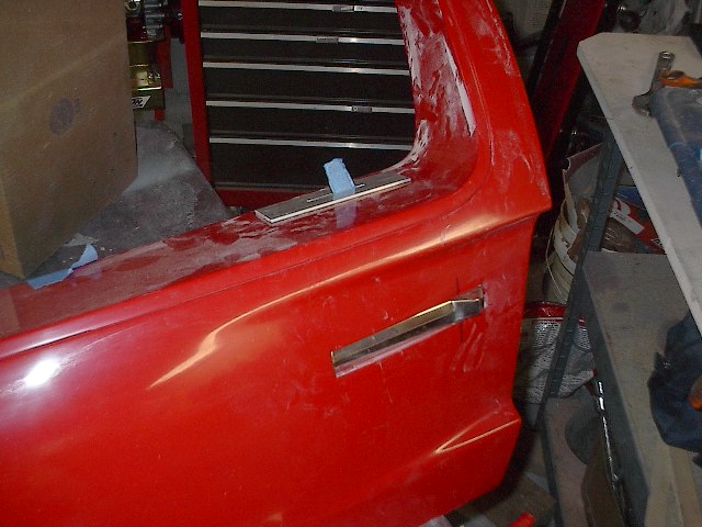

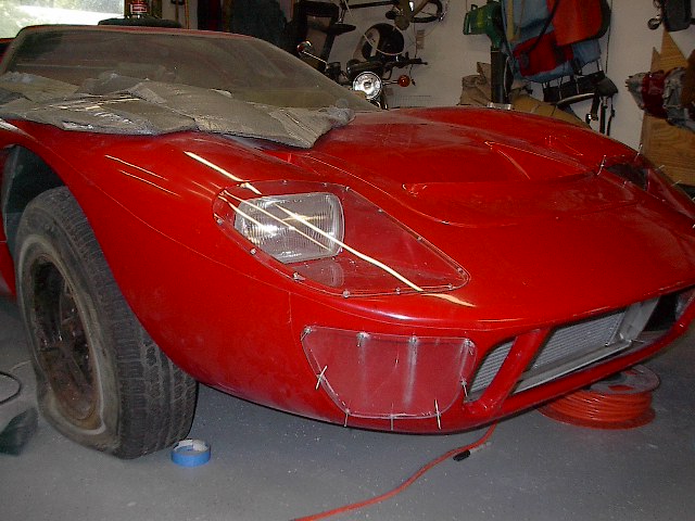

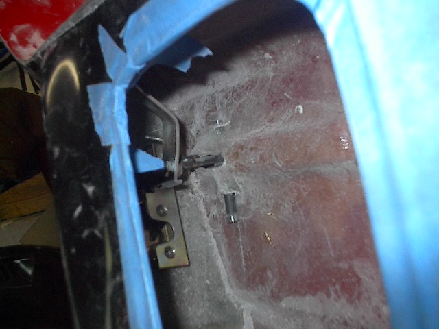

I have not posted for a while since I have not felt that I have had much progress. I have started with some of the details that are very time consuming. I am waiting on some parts to move on to big items. The UPS and Fed Ex men have been very busy delivering packages from Jegs, Summit, Bolt Depot, etc. What I have accomplished is mounting the door hardware, body cutouts, and fitting lights and the light covers. These all require much more time than I would have thought. Here are some pictures:

How much air pressure are you running in your tires? It looks a little low. Seriuosly, As I said before, I am very interested in what you have had to buy from other places. Keep good records for us all! It looks awesome.

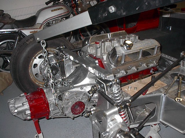

Naked Car

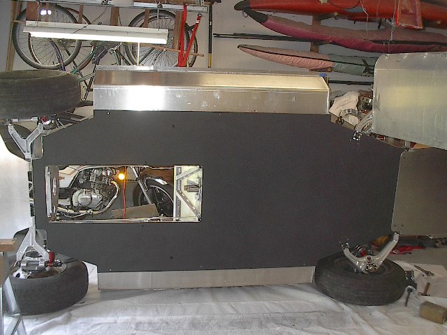

I stripped the body off to prep the chassis for under coating. I am going to try Lizard Skin on the car. It is supposed to be a spray on insulator and sound deadener. I hope it is durable enough to be an undercoat as well or I will use truck bed liner on the underside. Here is a pictures of the chassis being scuffed for the undercoat.

Aluminum still oxidizes and I plan on driving this car a lot so I wanted some protection. I also plan on using it in the summer with AC so I want as much insulation as I can get.

I got my undercoating on the car this weekend. I used Lizardskin. It sprays on like a truck bed liner but it is a sound and thermal insulator and is fire proof. It is a water-based product so it is easy to clean up and it has some form of ceramic particle in it for the insulation. I am pretty happy with how it applied. I will probably add some additional felt based thermal insulation on the rear bulkhead and the tunnel since they will be the biggest heat sources. Here are some photos:

It uses a special gun. I think any undercoating gun might work but I bought the gun that they make. It is set up to siphon up a hose or out of a cup. It goes through material so fast with the cup that you could not keep up with it. Using the siphon it goes through the material slower but you are not constantly refilling the cup.
I am looking forward to seeing how it works. It is hard to believe that something only 0.0060 could be a good insulator but we will see.
