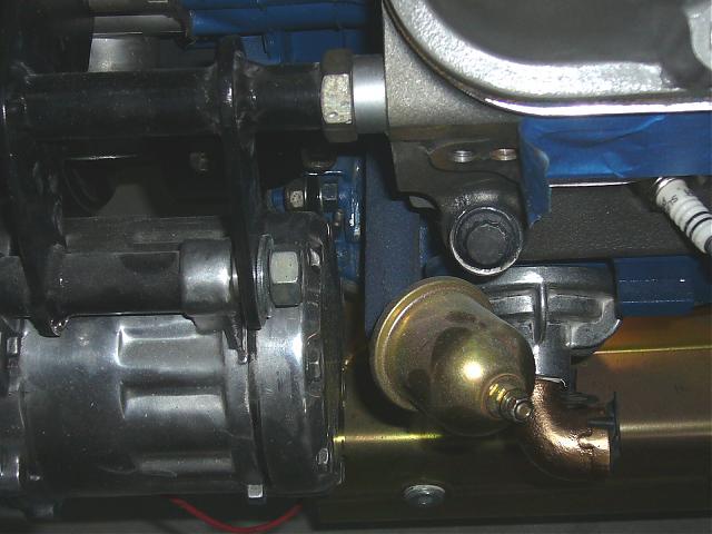

Excellent job!! Everyone says the AC compressor has to go on the right side. Does it interfere with the oil filter? What if you went with a remote oil filter system? What size is the condenser?

The condenser is just a little smaller than the radiator.
I believe that Vintage Venom put his compressor on the left side, but he is using different front trim than I am. I am using an Explorer pump and cam cover. This is the shortest trim available. I could not mount the compressor on the left side because of the lower hose on the Explorer pump that I am using. The hose prevents a low mount and the compressor would not fit in front of the head for a high mount. That left a low mount on the other side. There also was a handy boss on the block to bolt to on that side. I think you can work around the oil filter either way.
By the way I have moved my alternator since those shots. I need to post some new pictures of my front trim.

I was looking at that boss as well, but for a low mount alternator

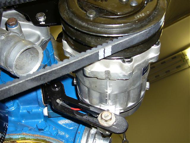

Correct Johnathan, I mounted on the LH side. I too have the shorty water pump with the pump inlet on the LH side. This was certainly a consideration, but I was able to work around it. It's tight..no doubt, but the hose snakes between w/o issue. see pics.

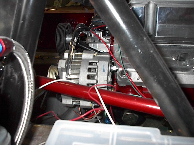

Rob, I think your pump is a little longer than mine. I am also running a serpentine belt. I do not believe I could mount the compressor on that side with my front trim. I don't think there will be two RCRs built the same.

No issues mate... of course there are no two the same. Just sharing what I did. However, I do "think" there "may" be enough adjustment in the RCR bracket to accomodate mounting with S-belt on LH side. Of course... w/o knowing how much shorter your pump is than mine... this is total speculation. From the pic you can see there is some, but not a lot of available room to move aft.
Looks like you did a very commendable job with fabrication of the tubular brackets. Only potential concern is the Alt height, for fear of clearance concerns with the bulkhead. If you have already considered this... then life is good, and good job on the fab work.

Rob, you are right on the alternator height. That was an old picture. I have already lowered the alternator and added an idler pully on the alternator side. I need to post a few new photos.

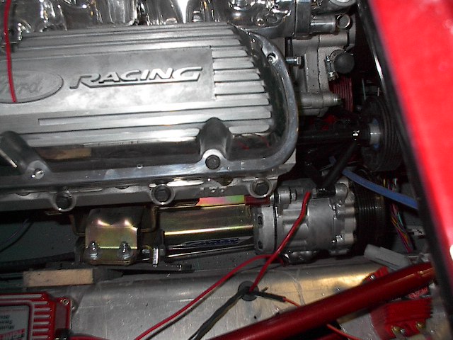

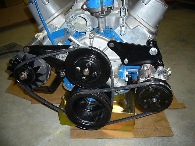

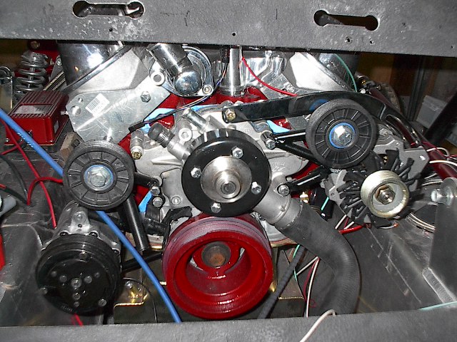

Here are some shots of my final front trim:
If you look close you can see the AC compressor is pretty far back. You can also see the alternator, which is shorter than the AC compressor just barely fits. Also the radiator hose is actually in the plane of the belt. I'll route the belt over the pump and down onto the alternator so that the belt does not pass over the hose.
I did not like the way my other alternator bracket looked anyway. This sticks to my tube theme. The other one was too small to make using tubes and it looked cobbled together.
My entire bracket set came in just a little over 2 pounds without the alternator tensioner and it seems pretty stiff. I still need to weigh the alternator tensioner.
I also added a tube on the AC compressor side to keep the throttle cable out of the belts.

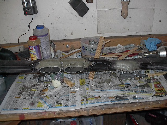

I have also modded my AC plenum from Fran. I wanted to add two center vents on the dash. I also mounted my evaporator before I had the plenum and the two did not line up so I had to add a bulge to the plenum. Here are some shots:

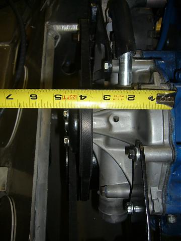

Rob, out of curiosity what is the measurement from the mating surface of the block and the cam cover to the furtherst forward part of the pulley grove on your water pump (in other words the front of the fan belt). The Explorer trim is 5.5 inches.

Sorry for the delay Jonathan.
I'd call it 4.00", or just a hair under, depending on the thickness of the pulley.

Rob, our front trims are going to be pretty close. I was measuring from the back of the cam cover and not the back of the pump. I believe that some of the cam covers are different thicknesses.

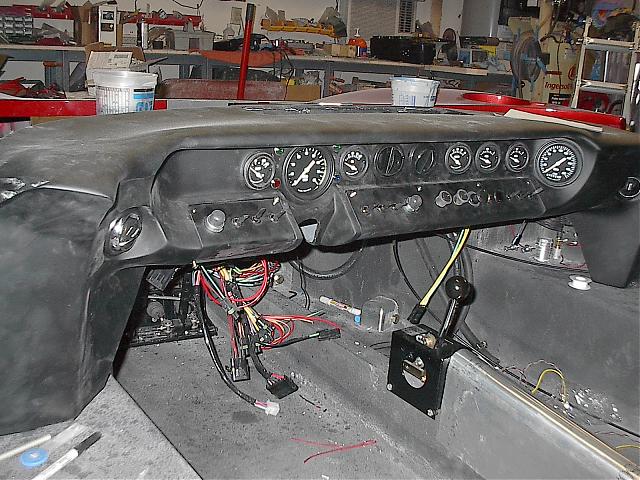

I have completed the mock up of all the AC system and the dash. I added hidden hardware to attach the dash.

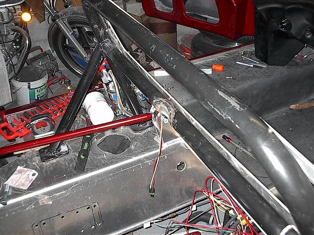

Man that photo of the dash really shows the dust. The paint is pretty good that is just dust. I have also put a C notch in the seat belt bar on the roll bar to give the distributor some more room and clearanced the frame for the starter. The motor is nearly ready to be reinstalled.
