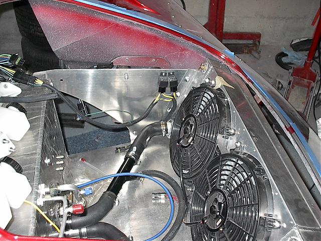

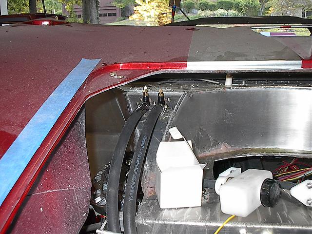

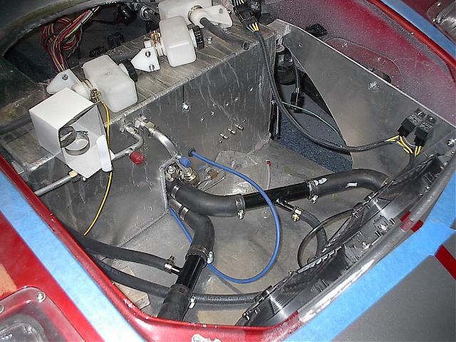

I got the replacement part from KEP within two days as promised. The transaxle is now mounted and I moved on to plumbing the car. Here are some shots of the cooling system:

In the last shot above you can see the bulkhead fitting I made for the heater lines. It has two bleeds in it that are very helpful in getting air out of the heater. Here is a handy trick for getting coolant into the system. Hang an IV bag:

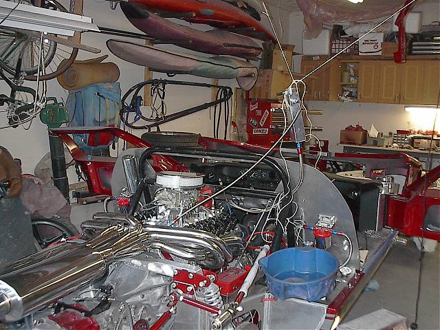

After the coolant I moved on to the oil system. I went to add a dipstick and that took a full day. The bung was obstructed. I though I could just bend the dipstick tube but the stick would not pass through the bends. That meant dropping the pan and welding in a new bung. Then I primed the oil system and discovered that my AN fittings were leaking. I ordered a replacement fitting from Sumit and the FedEx man left it on someone else’s porch. I finally got impatient and went to a local store to get the part and TODAY I STARTED THE ENGINE.
It absolutely sounds like no other car I have ever heard. I love the sound of the cross over pipes. It sounds like an indy car.

Question regarding the heater hoses. I noted the "T" fittings for the heater hoses to connect to the radiator tubes. I plan to use the same system. Don't yet have the fittings. Did you obtain the "T" fittings from Fran, a third party vendor, or fabricate them yourself???
Chuck
CESLAW is offline

Another question, this one related to your radiator fans. Referring to the picture posted February 2007, I note four brackets on each plastic fan shroud secured with a bolt to the aluminun shroud. I also note some sort of device connecting the two fans together. I have the exact same fans with my RCR, but there was no hardware whatsoever with the fans. No clips. No brackets. No nothing. Did those little bracket / clips come with the fans or did you find another supplier?

The black plastic brackets came with the fans. The aluminum fan shroud I fabricated.
