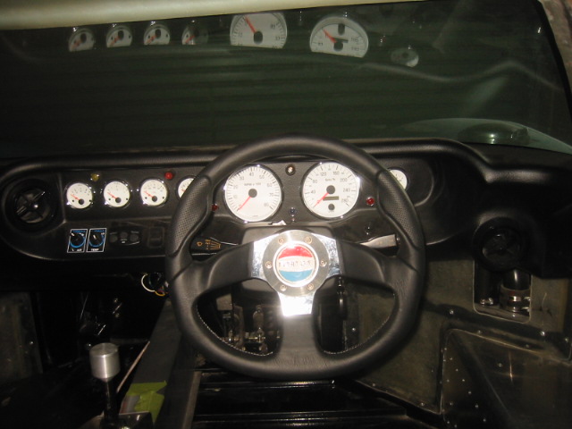

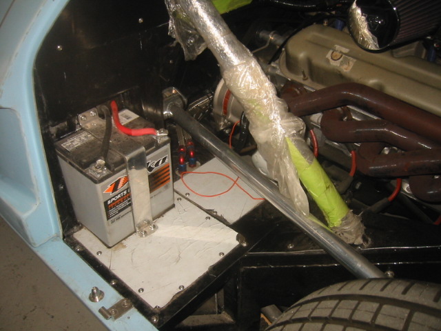

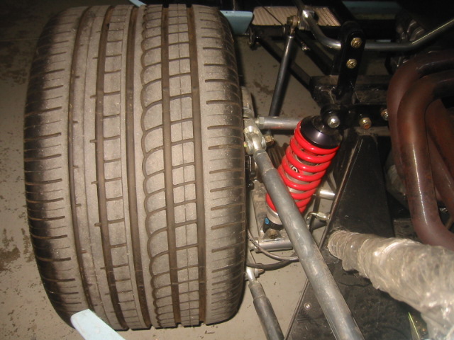

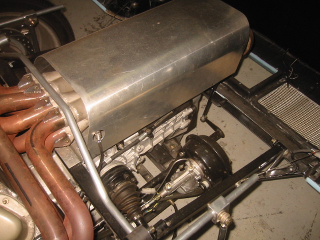

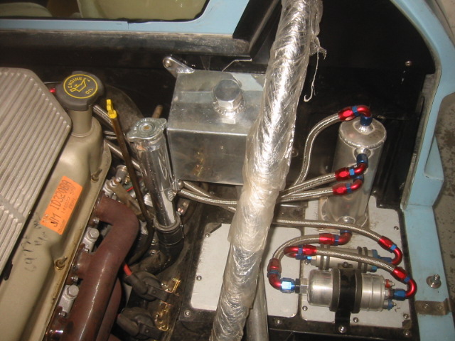

Well,finally got to a DRB "sausage sizzle" and sat in my car,even had the engine running and tried out the clutch.
Seats should be back from upholsterers next week and hopefully will be doing the noise and brake tests the week after.
Dual brake and clutch vacuum boosters are fitted and getting closer every day.
Hoppy

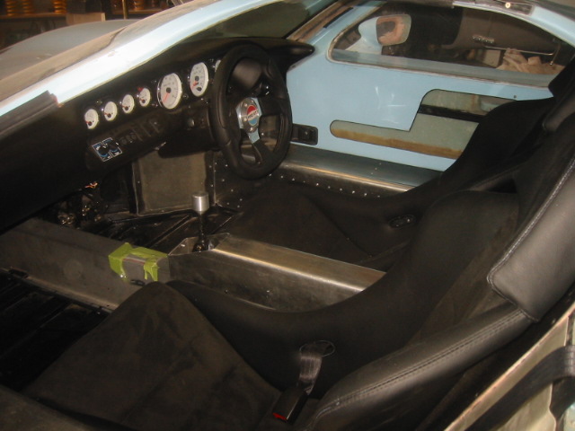

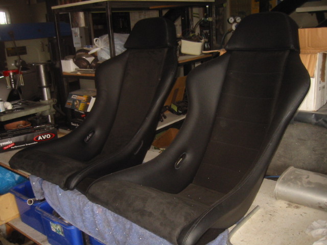

Seats are back from upholsterers (painters and upholsteres cannot be believed when it comes to completion date).
Ready for the final tests and inspection early next month.

Hoppy,

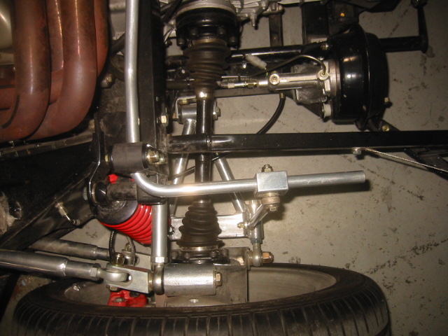

Is that a vacuum booster down near the transaxle? What is it doing?
Dalton

Hoppy,
I know you are getting really excited. I know I am. My completion is drawing near as well. Soon you will be cruising and grooving.
Is that a booster I see on the shifter mechanism at the rear. Send me some pics of it from the rear perspective if you can, or post them here. If it is, you have given me an idea with my hybrid shifter that I am working on. Working on the model caused me to tear up my knee last week. So I now have time to work on it.
DRB#5

Dalton,
I broke my left ankle many years ago and when I was looking at getting a GT40 I soon realised that the "fun factor" would quickly be lost if I was caught in traffic with the heavy clutch and Tilton set up(floor mounted instead of hanging pedal).Looked at a Triptronic but was way to hard to adapt so decided to go for a power assist type set up,it reduces the operating pressure from 25kg to 10kg which gives the clutch a small Japanese car clutch pedal feel.
Bill,
I am looking forward to getting home in Feb,when the car should have the plates on and registered.Then I can sit down with the painter.
This is the only other picture PR has sent me of the clutch vacuum booster set up

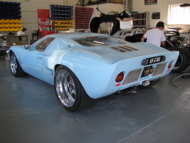

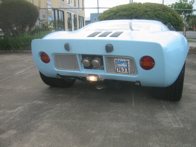

A sight to behold,my car with the trade plates fitted going to the police station to get its VIN which it received this morning.
Final inspection an noise/brake tests on Tuesday.
PR reports that the brake and clutch power assist set up is beautiful to drive with.

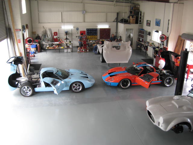

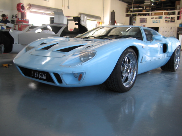

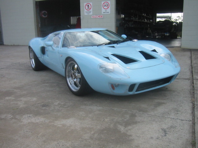

Well I drove my car yesterday for the first time and will have to make an appointment with a surgeon to have the smile removed from my face.
Found myself just wanting to "play" with the gears,accelerator,brakes and steering.
Even though the interior is only two seats and a dash the overall experience was an assault on the senses.
Totally impressed!!
Have an appointment for the final QT inspection on the 11th of March so should be registered then.
DRB has expanded its operation and has moved the fabrication and fibreglass shop next door so now the original building is just for assembly and servicing.

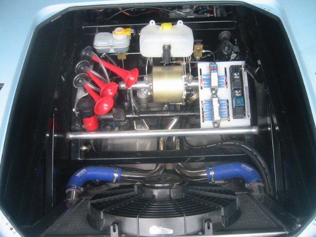

Would you be willing to share some more details regarding the remote booster you are using for the clutch operation? Application, source(s), sizing, etc. Any information would be appreciated.
Thank you kindly,

Hi Andy,
The booster for the clutch is just a brake booster installed in the clutch control rod so it works the same as power brakes.
It is a PBR VH44 which is the normal power assist unit,either twin or single used on the DRB's and standard on many Fords and Holdens here.
The clutch is nice and light to use,the only problem is if you rest your foot on the clutch pedal a bit before operating it the booster builds up vacuum and when you push the pedal it will over travel.I am getting a positve stop fitted to prevent this.

Finally finished with Queensland Transport and am street legal.
