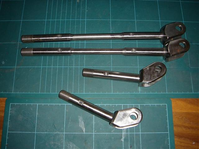

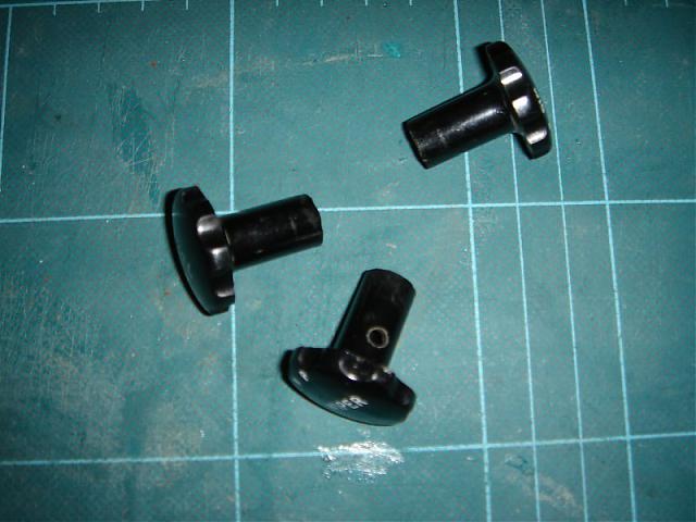

Oh... and billet steel has its place....

Beautiful pieces you've assembled for your car/motor!! Intake and exhaust valves are sort of on the small side for 300hp, I think. Depends a lot of cam and head, it might take a pretty good cam to get the power of out it. I also suppose it depends on if you are shooting for 300 gross hp, aka 1960s ratings (K code, 271hp, A code, 225hp), or a modern SAE 300 hp. There is a good sized difference there.
However, your build and blueprinting is worth something and might make up some of the SAE/Gross numbers as well. I'd be interested to see what it comes out to on the dyno - no matter what I bet you'll be pleased and it'll be a fantastic drive!

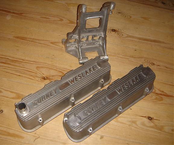

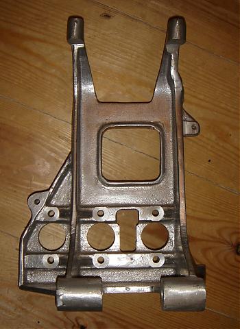

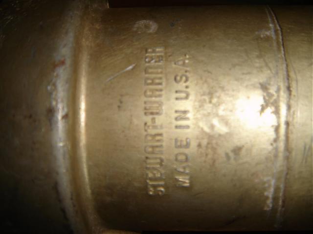

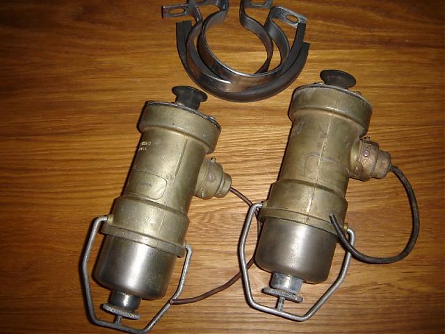

Got hold of two of these from a friend across the pond.....

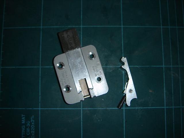

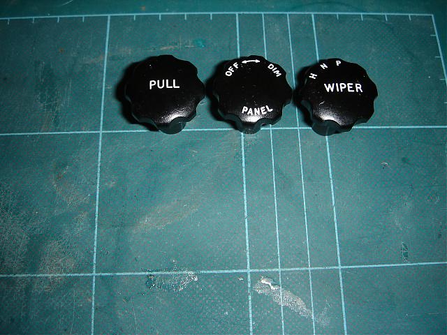

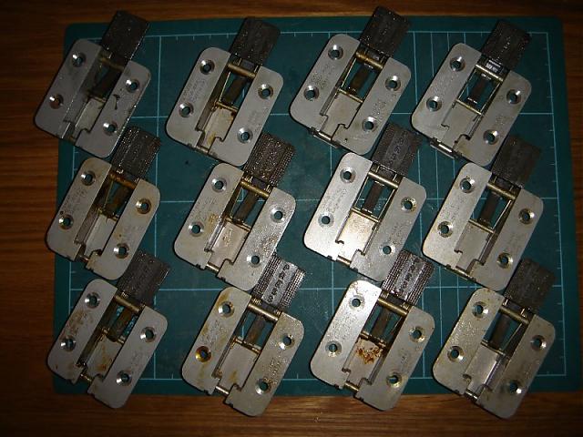

Hartwells and dash knobs..... and thats grease on the Hartwell latches and WD40 not rust.......I think I ordered to many ;-)
Engine was supposed to be delivered today but was delayed (AGAIN) so the coffee is on hold...... glacial progress.......
Andy

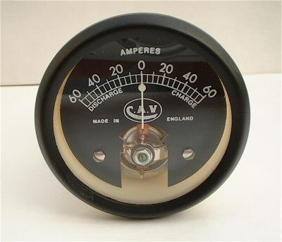

NOS CAV Ammeter
