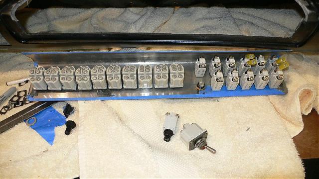

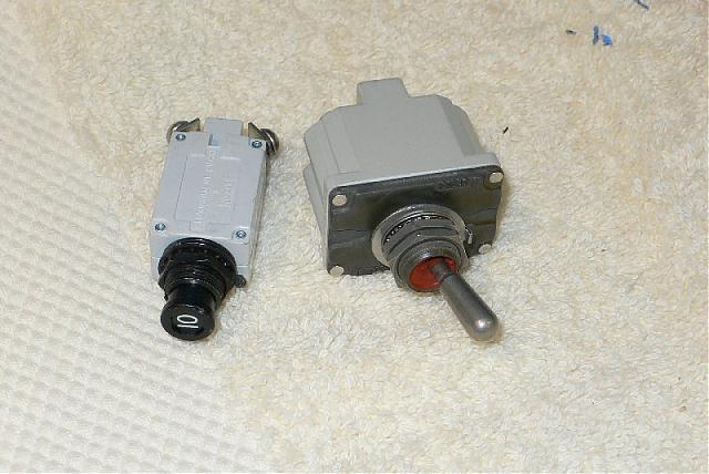

Some Work on the car, started the second panel and breaker wire job. Pics of the Eaton switches and Klixon breakers. First pic is the Centroid fuel tank sensor which replace the leaver style that come with the kit. Why, because I like them :-) The old gauges are still in the dash, new ones and the wire job coming next.
A long way to go and a short time to get there - Willy Wonka
Sandy

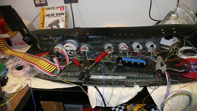

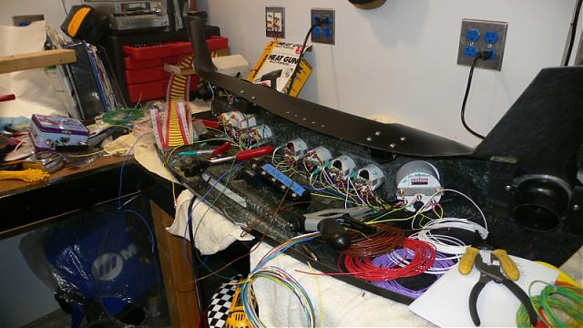

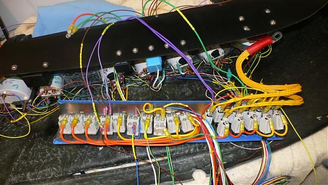

Here is the last couple from this evening work. Wired up most of the gauges to pig tails, then started on the small panel.
The funny thing is that I think every build has a picture like this of the wiring mess before it is cleaned up.
Jim - I love the Eaton Switches, very well made and worth the price for piece of mind. I will get into that mess of switches very soon

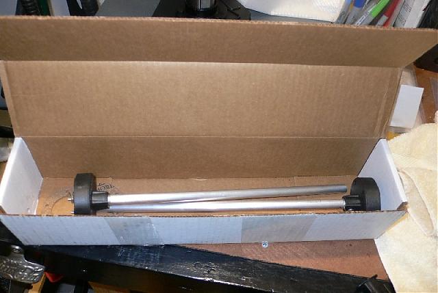

Actually did some work tonight, wife out of town, got some stuff from the UPS guy. Chose an easy job, make the air filter. The carb height is pretty close to the rear of the back window. Came out a little shy of 3" height at the middle of the float bowl. Makes for a small filter. Decided filter is out for now, got a Gaffrig Flame arrestor for marine applications. Problem is that they come in 2" 2.5" and 3". Well not exactly, they also include an extra .5" for a nice flange that protrudes from the bottom so add that to all of them. Called them and they sent me an extra lid that is flat and I made a hokie turn table with a screw in the middle of the lid fastened to a 2x4 (not sure what the metric version is...). Fired up the plasma cutter and made a new base by spinning the disk while plasma-ing. Came out better then expected. Pictures coming as it's after midnight, but here is what the Gaffrig looks like. Built out of all stainless and nicely polished. The mesh is actually 3 parts, Outer ring, inner ring and a coil of fine mesh. Seemed a bit on the restricted so I did a single loop of the inner mesh. Good for flow, Bad likely for the plastic rear window .

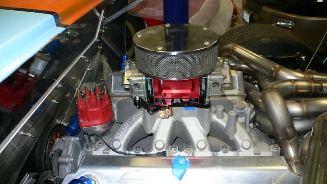

Fran -

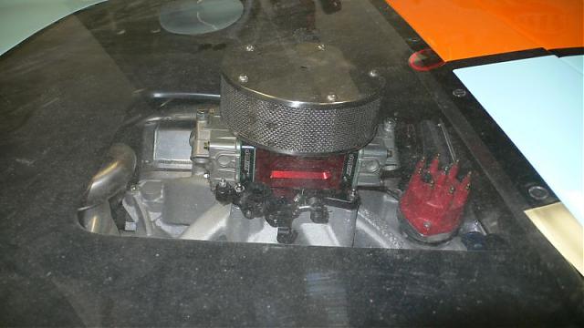

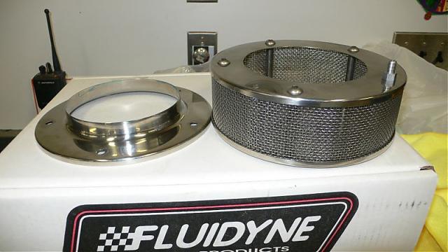

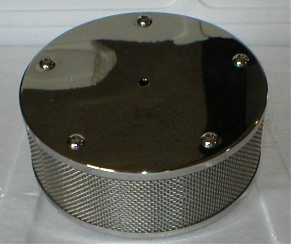

That is a Edelbrock Super Victor. I it is about and inch taller then the Victor Jr. No I don't have a 2" spacer under the carb
Here are the pic's from my hack job on the filter, oops semi-functional flame arrestor...

Check this out, it made an inertia dyno proven +11hp increase on my 470 HP 383 SBC !
It would be the perfect compliment to you're flame arrester.
Professional Products Online
(Airflo)
Scott

Interesting. I have a Piper Cross air filter on the Mustang that has that as part of the top lid assembly. That was the bad thing about removing the nice curved riser on the flame arrestor base I'm guessing it did some of that. It looks like it would have to be hacked to fit and might be too close to the top of the carb. The height is 2.5" and they say 3.3" is min. I like the idea...

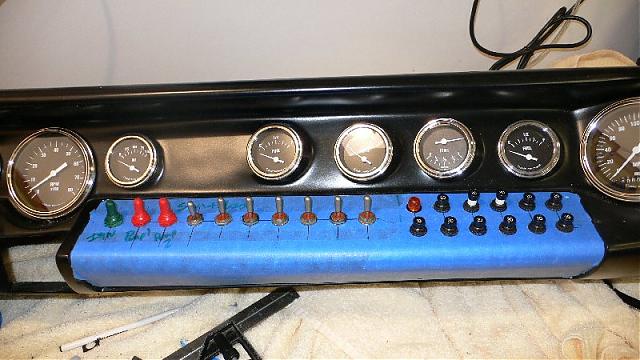

Another of the dash as it was in progress, can't see them too well, but the black block with the 2 allen screws on the left is the master relay (75 amp) which is fed by the master breaker far right (100amp can't see it at all) and the relay section in the middle which houses the starter relay, horn relay, electronic turn flasher (blue), fan relay and a spare. All wire Teflon and likely larger then needed. A rats nest for sure...

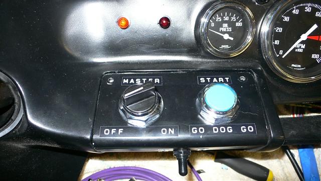

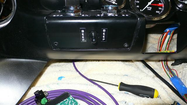

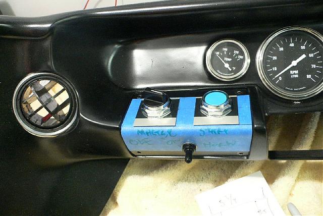

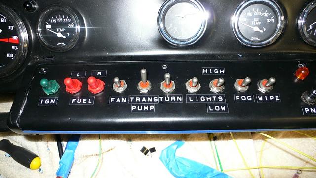

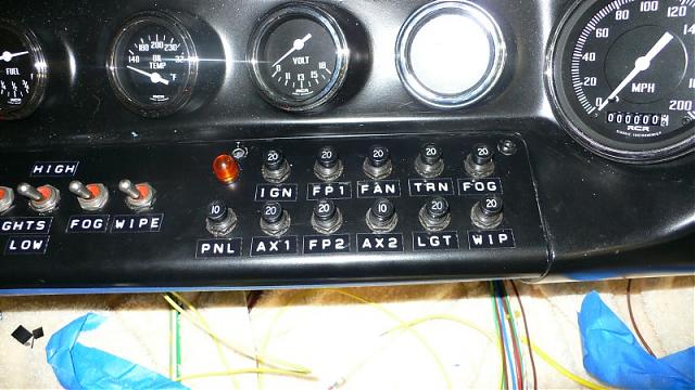

Here are some of the 'mostly finished' dash and labels. I didn't go the route that BillD did, just too lazy, I ended up just getting a Dymo Embossing labeler from Ebay and going to town.
Pic 1 Left Panel - Bottom of panel (squeezed in the horn button)
Pic 2 Left Panel - Master On/Off, and "Go Dog Go" (starter) button
Pic 3 Right Panel - Switches
Pic 4 Right Panel - Breakers
And no the 'Wipe' button is for the Window
