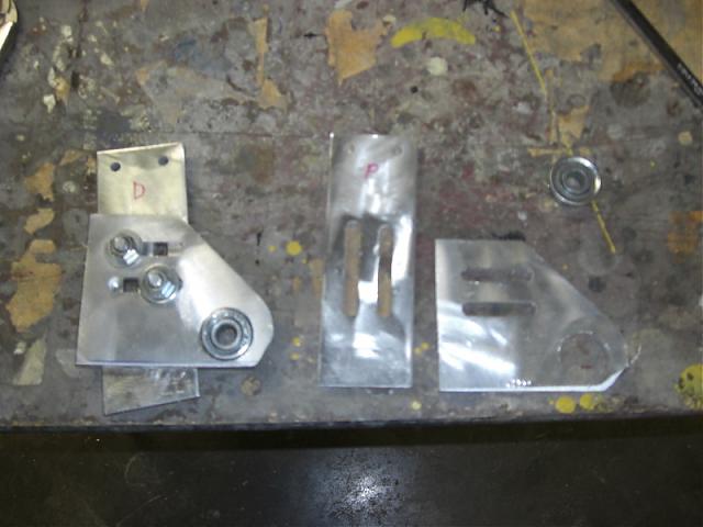

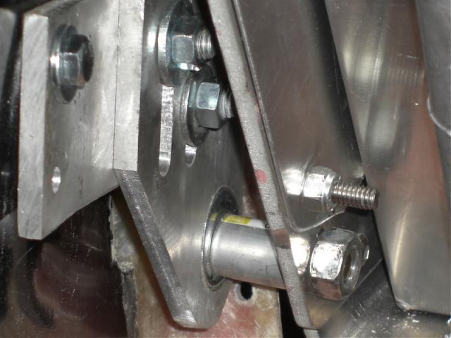

Hood hinge again the forth time is a charm.

Here is another. I found the bearings at the hardware store. Fully adjustable and rock solid. I used the same adjustment set up as Fran did for the rear clip.

One question/concern....Have you tried tilting the front end with the car on the ground? I notice it's on the skates, and am concerned about ground clearance. It would suck if you finalized the design and the nose hit pavement the first time you flipped it up.

I have had it off the skates and it opens fine. I didn't move the pivot point from the first 3 hinges I made. Now it needs some struts on it to keep it up.

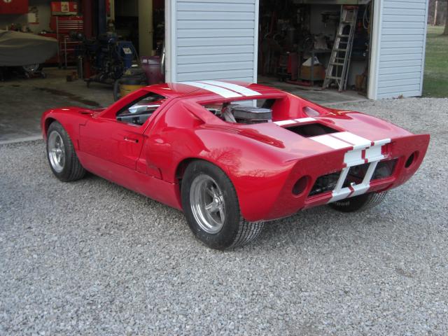

Maybe this will work.
ID:	28834  Click image for larger version

I was at Sears the night before I shot the stripes and seen a laser level there that was on sale. It has a magnet mount and worked perfect to make the tape line. I marked the cars center front and rear and lined the laser up with both marks. The laser level shows exactly where the line goes in the nostril.

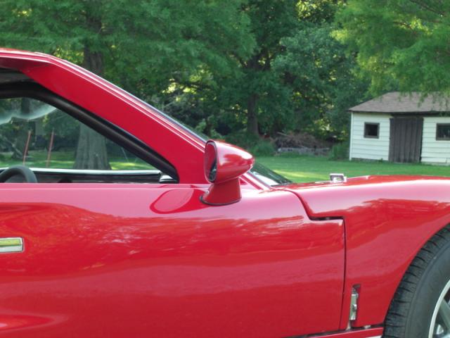

I went in for inspection 2 weeks ago. Ohio has changed the inspection process a little and one of the things they need to see on the car is 2 rear view mirrors. I have looked for some time for the right mirror and found something I like. I was at a friends house and next to his barn was 2 1978 Camaro Z-28 doors. I said hey what are you going to do with them mirrors. He said you can have them if you take the doors with them. The drivers side is remote.
Jeff Hamilton

I had to turn the gaskets around.

I hate this picture thing!
Jeff Hamilton
