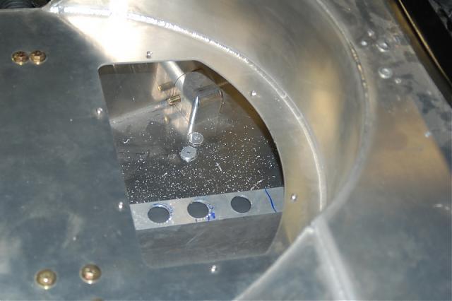

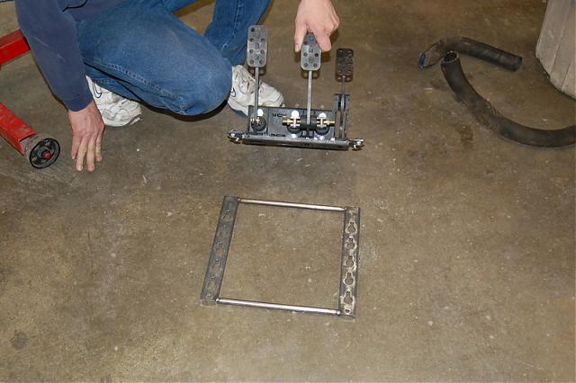

Well here is my new build thread. The wife is 5"2" and the pedals wouldn't work for her where I wanted them. I have a friend with a vertical mill and he can use it. After much debate he copied a shelf I had in the garage. The rod in the rear will be cut out after it is mounted.

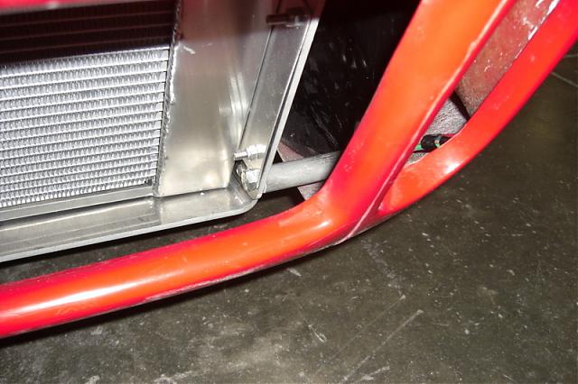

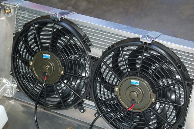

I got the fans mounted. I ground down a 1/4" bolt head and slid it into the mounting tab on the top of the fan. I bent aluminum flat stock to fit over the radiator and then drilled one hole in it to hold it on. The bottom is fastened with the mounts that came with the fan and 3/16" rivits.

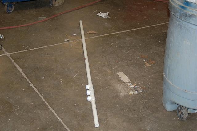

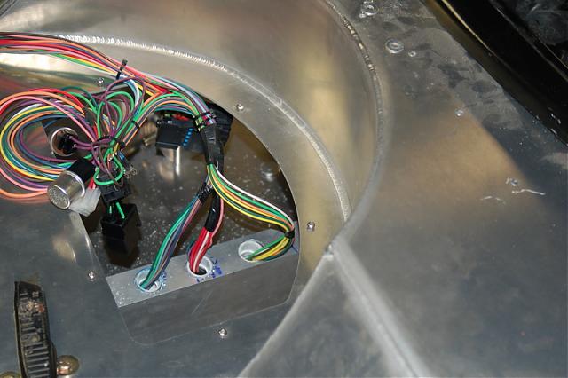

I decided to run the harness in the tunnel. I wanted to protect the wires as much as possible. I used 3/4" plastic pipe and 3 tees. The rear lighting harness and the motor harness would not fit in 1 tee. I ran the lighting harness in the rear tee and the motor harness in the middle tee. The rear light harness is longer than the motor harness so after you get the lighting harness pulled part way I inserted the motor harness and pulled them together. It gets tight in the 3/4" tube. I used the front tee for the front harness. After I got it all in I drilled the tunnel (while holding the pipe up to the top) and ran a bolt under the pipe.

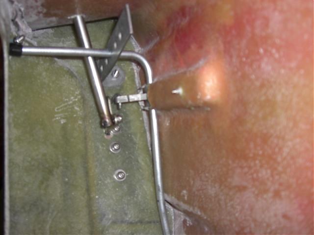

Door handles and latches are installed. I built several different ways that didn't work. I then applied the KISS method (Keep It Simple Stupid). I cut the door where the pivot bolt needed to be with a die grinder. I used about 18" of 3/8" fuel line. Measure from the bottom of the door to the handle and mark it. Slid the handle on the tube where it is going to ride then put my cordless drill on it and spin it until it spins freely. Bend a 90 in the tube about 1" over the handle. The tube is strong enough to hold it in position but if you really yank on the handle it will bend a little to fit the opening. I used 2 mounting clamps (one at the bottom that you can't see in the pic) and a tail pipe hanger. I don't think you need the tail pipe hanger but I was going to use it for the pivot for the inside handle. The wife came up with the idea of using a push button for the inside release. I used 1/2" SS tube now I need to find a button for the top.

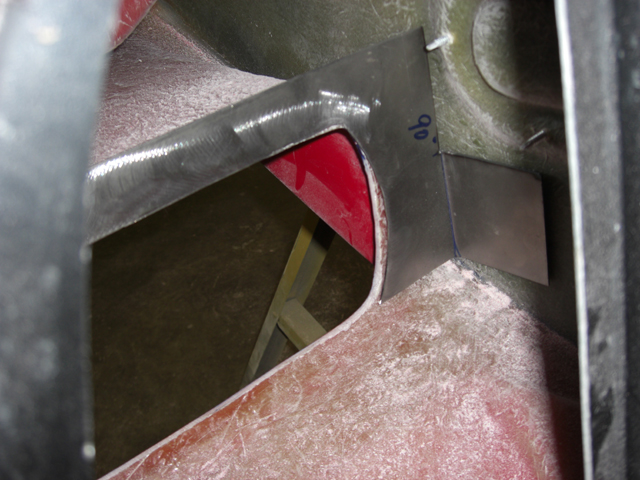

Re: Jeff's RCR40
Headlight install.

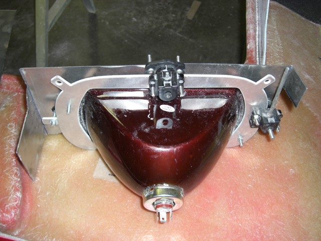

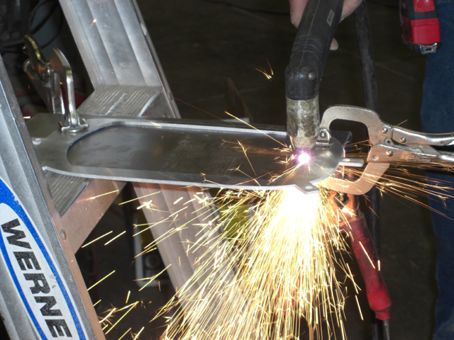

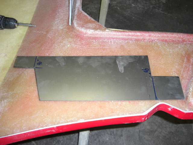

I found some 1993 Ford Escort headlights in the basement and stole the adjusters off of them. These are simple little adjusters but work well. I used 16 gauge (6"x18") and with some cutting and bending made it fit the car. Then I mounted half of the adjusters to it. I used the kit supplied aluminum to mount the other half of the adjusters to. Pictures are worth a thousand words.

That is the best set up I have seen so far. I would redo mine if it was not for the fact that I hope to only need to adjust mine once. Good work.

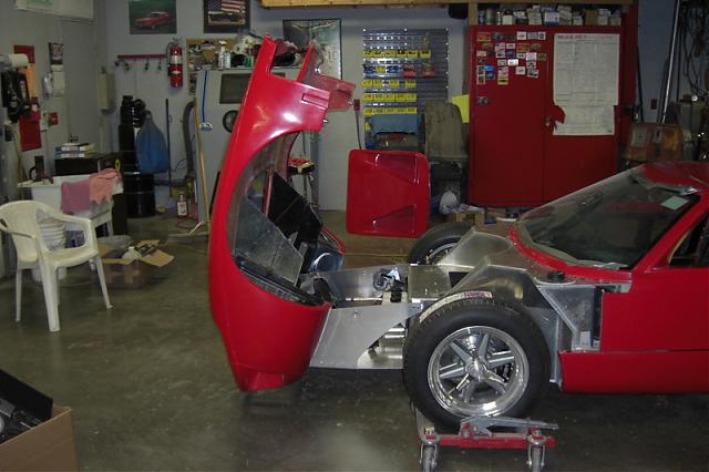

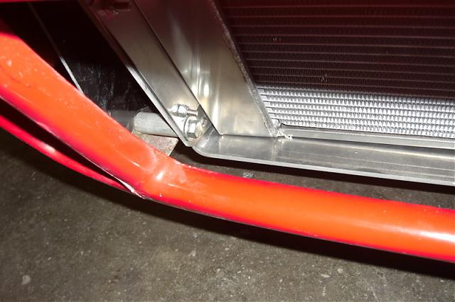

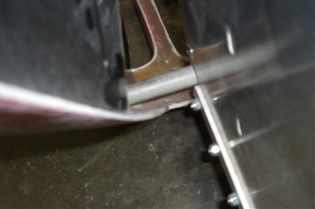

I stole Chris K's idea. I changed it a little and I'm not done yet. I like the his idea of the tilt front end. I drilled a 7/16" hole in front of the radiator and went all the way through the front end. I had the front adjusted exactly where I wanted it. I then cut some pvc pipe to make spacers. Works like a charm except I need to make it adjustable. I will replace the spacers after I find out how long they need to be.

Slick idea for the hinge, Jeff. Two questions for you:
1) Any reason to be overly concerned about the weight on the bolts/pivots?
2) What did you mean by "...except I need to make it adjustable?"
Thanks in advance,

I'm going to make a plate for the inner fender but it feels great just like it is. The inner fender is not flat at the mounting point. This makes the right front a little low and it shows at the spider. I want to mount a cage nut in the plate that will be mounted to the inner fender. That is the plan anyway.
Jeff Hamilton
