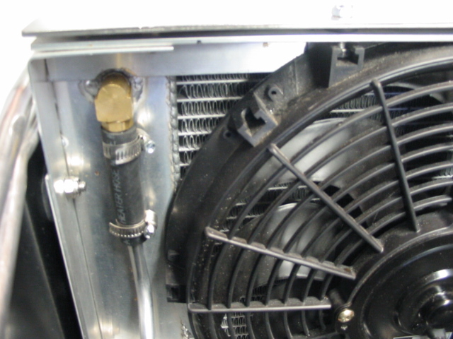

Radiator, Part II
A vent line was added, connecting the cool / input side of the radiator to the connection on the top of the expansion tank. This permits any trapped air to vent from the radiator. Three eighths inch aluminum tubing was used to fabricate a long, straight line, equal in length to the long coolant tube extending through the center tunnel. This was run through the tunnel on top of the two coolant tubes. Two additional aluminum lines were fabricated to complete the connections at the front and the back.
Three eighths inch hose was used to complete the connections. Be sure to use heater hose, not fuel line hose. It is available at most car part stores. Fuel line hose does not hold up well to antifreeze.
The drain fitting on the top of the radiator on the side where the coolant enters the radiator was replaced with a right angle and straight fitting. Teflon tape was used so it could be positioned tightly where we wanted it.
I found very little information regarding this subject. Carroll Smith describes this technique in one of his books. Some suggest using a smaller line, perhaps a quarter inch. Based upon our initial experience running the engine, this set up seems to work appropriately and the three eighths inch tubing should, hopefully, not be an issue.

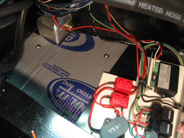

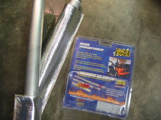

Tunnel Plumbing
Six lines run through the tunnel: two 1 ½ coolant lines, a 3/8” coolant bleed line, two AC lines and the fire suppression line. All the lines, except the fire suppression tube, were placed inside an insulating sleeve from Cool It Thermo, Inc. It had to be a thin sleeve since there is little extra space with which to work.
Before placing the lines the brake fittings adjacent to the tunnel were secured, since doing so after the pipes are in place would be a challenge.
Various holes were also drilled for the shifter and center console before the tubes were placed.
The copper line for the fire suppression system will be fed through the tunnel later. Since it is a small diameter copper line, it should slide easily through the tunnel.
Now that the tubes are in place there will be NO MORE DRILLLING on the tunnel.

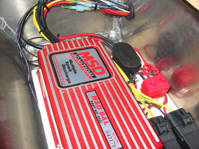

Chassis Wiring, Part I

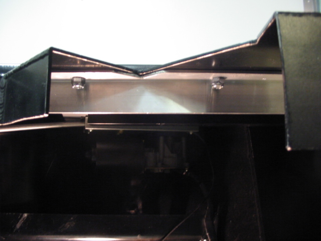

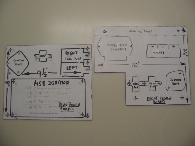

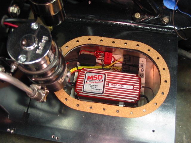

Rear Power Board
In an earlier post, we noted that an opening in the left rear tank was cut out and covered with an oval plate. This chamber was used for wiring components. The MSD ignition module, fuel pump relays and a central wiring point were mounted on a section of white half inch Star Board (marine lumbar) measuring 9 ½” x 8” inches. This rear power board was then mounted on half inch nylon spacers with 3/16” button head stainless bolts.
Star Board is a wonderful product. It is used like wood, but is chemical resistant and requires no finishing. It provides an insulated surface for mounting electrical components. The white finish makes components, particularly in a dark location, easier to see. (It is also available in black). It should not, however, be used in temperatures over 200 degrees, so it cannot be used in close proximity to the engine or exhaust system. West Marine is a good source.
A Jegs Terminal Block, 555-10521 provided a central wiring point. It was fed with an 8 gauge wire from the alternator post, which was then connected to the starter and battery through a 50 amp fuse provided with the wiring kit per the Painless directions. The 50 amp fuse was located as close as possible to the battery – starter junction. The Jegs terminal block was the common point for connecting fuel pump relay power sources (which are also fused closed to the relays), the dashboard power source, and any other electrical needs not running through the dashboard. Another 8 gauge wire runs from this terminal block to the front power board. This keeps the wiring simple and accessible. It also keeps the high current accessories separate from the dash wiring. This is likely over kill, but adds a safety factor for little additional cost.
Bulkheads
The fuel pump wires and ignition coil wires were fed through a grommet on the inside wall of the bulkhead. The fuel pump wires were connected with removable connectors. The fuel level sending units have screws securing the wires which are accessible through the access plate. The coil wires are also secured with screw terminals. All the wiring behind the bulkhead can be disconnected through the access panel. Thus the bulkheads can be removed without having to cut any wires, should that ever be necessary.

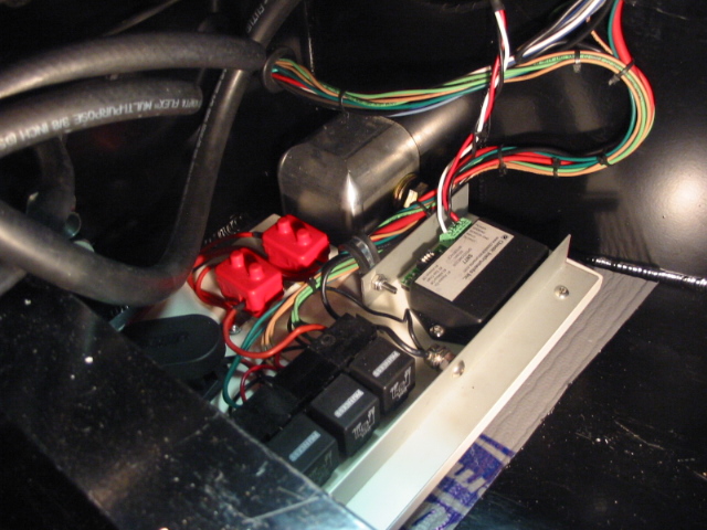

Forward Power Board
A section of Star Board measuring 10 x 8 ¼ inches, with a notch for the lower control arm housing, was used for mounting the speedometer transducer, high beam, low beam and driving light relays. It was mounted on the floor a couple of inches behind the right front firewall to provide adequate clearance for the fittings mounted on the firewall. It is easily accessed from above and the white panel makes for a clean and easily seen mounting surface. It was fed with an 8 gauge wire connected to the Jegs Terminal Block mounted on the rear power board by the MSD ignition.
The power lines to the fan and the lights are separately fused. A Jegs terminal block provides a convenient junction point. Be sure to use a jumper between the two different size studs on the Jegs terminal block, since they are not internally connected.
The one inch aluminum angle on the rear edge provided a convenient mounting location for another grounding bolt (which is separately grounded with a wire to a chassis ground, since we don’t want to rely on the mounting screws for a proper ground in this location). Another aluminum angle was mounted on the front edge by the speedometer interface. If there are any issues with electrical interference a cover can be easily fabricated and placed over the speedometer interface using these aluminum angles as supports. Hopefully that won’t be an issue.
The speedometer interface connections were kept separate from the main wire harness to minimize the risk of interference.
A means of securing this panel so it could easily removed was sought in the event future servicing of any of the accessories or removal of the lower control arm bolt would be needed. Nutserts seemed the ideal solution since no real stress will be placed upon them in this application. Four were used. Now the screws can be easily removed from above. Enough slack wire was left in the harness so that this board could be lifted up and out of the way for easy servicing. Before the panel was installed for the final time a section of thermo acoustical insulation was placed beneath it, then four half inch nylon spacers raised the panel to clear the hardware on the bottom side.

Is that MSD & relay setup going to get enough ventilation stashed away in that compartment?
jac mac is offline
Old 01-27-08, 09:50 AM   #132 (permalink)
CESLAW
3 Tenths
Join Date: Oct 2006
Location: Illinois
Posts: 378
Rep Power: 5 CESLAW is a glorious beacon of light
Re: Chuck and Ryan's RCR Build
Jac Mac
Good observation. Short answer: I don't know. But I have been thinking about ventilation options should heat be a problem The easiest: take the cover off. Vents could easily be added to that compartment as well. The more elaborate solution: add a small vent fan to that compartment (which I doubt would be needed).

Do you know what MSD stands for? My Spark Died... Don't ask me how I know....
Depends on how much exhaust pipe heat is in the general area. MSD boxes work pretty well in most engine compartments, so they are probably good to about 200 degrees. Also, DON'T LET THEM GET WET.. Again, don't ask me how I know about that one either....

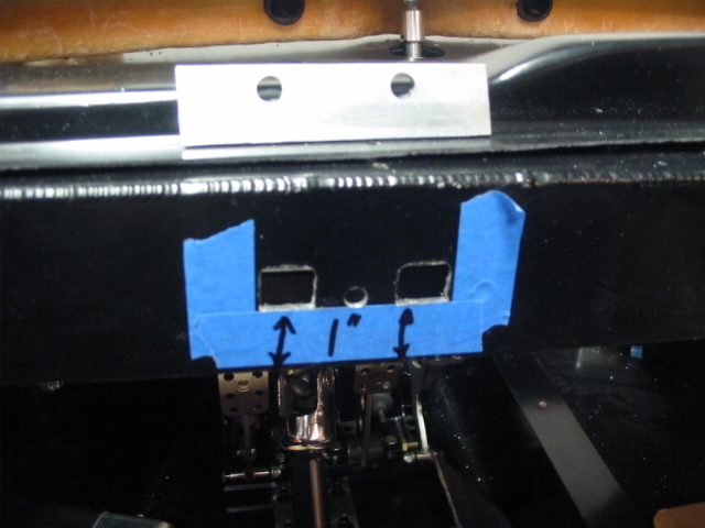

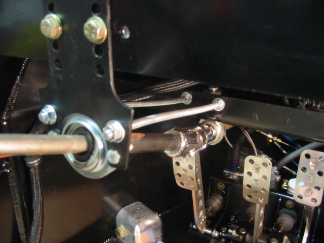

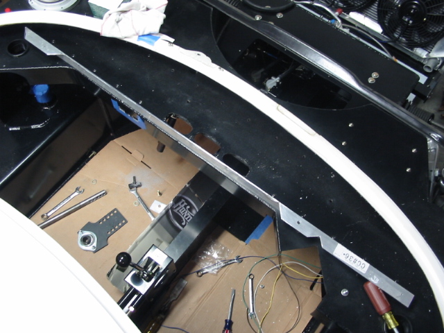

Dash Bracing
The nibbles and bites taken out of the chassis to clear the speedometer and vents as well as removing sections of the square tube supports on the underside had weakened the structure a bit. This was noticeable when one grabbed the steering wheel and pushed it up or down. Accordingly we fabricated a support, four feet long, from a section of aluminum angle, 1 ¼” x 1/16” thick. This was cut and trimmed to fit flush aft of the evaporator. Once secured with several ¼” bolts we noticed a significant improvement in the strength of the chassis. The up and down flex was greatly reduced.
The first picture shows the angle support bracket, cut to fit, resting on top of the chassis in the same position it was secured below the chassis. The second picture shows the right side of the bracket behind the speedometer opening.
The support bracket for the steering column had a bit of in and out flex. To eliminate the flex two lengths of 5/16 inch threaded rod, ten and a half inches long, were placed on either side of the steering support bracket to secure it to the chassis. This simple modification had a dramatic effect on the rigidity of the steering assembly. Don’t forget to tighten the tiny set screws on the steering column support, which are not easy to see.
To give us a bit of room for up – down and left – right adjustment of the steering column, the two holes for the bolts securing the bracket were enlarged, and made rectangular in shape. A backing plate was fabricated. This arrangement enabled adjustment of the column so that it is perfectly centered within the dash opening as well as permitting proper height adjustment. The top of the backing plate rests just below the bottom of the cross brace described above on the backside of the chassis. In the last picture the backing plate is setting on top of the chassis before it was installed.
