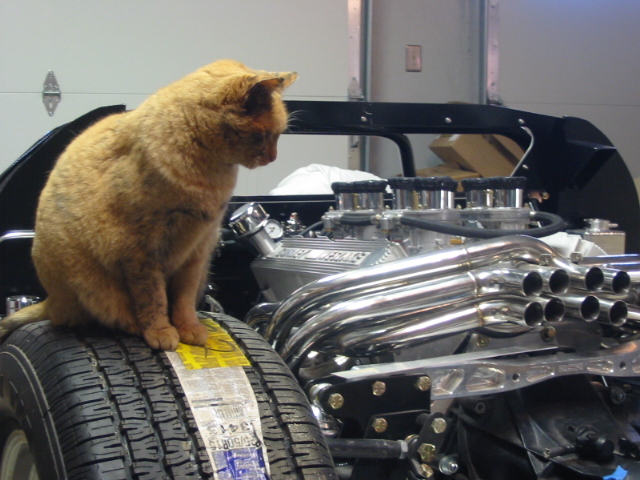

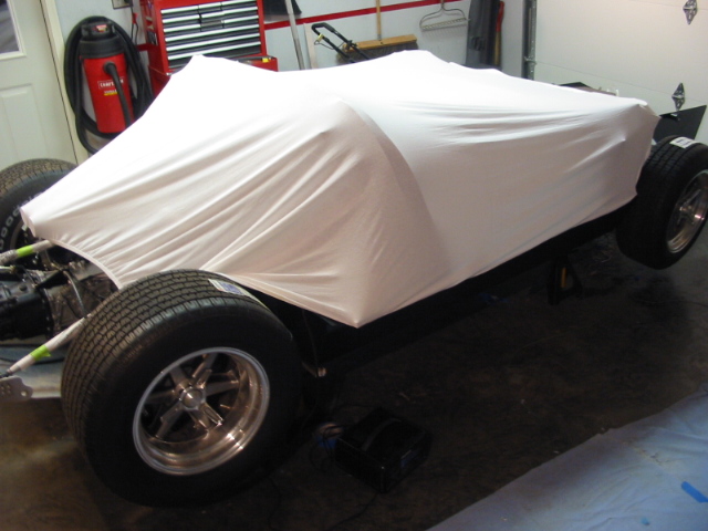

The Cover Up
The idea of cat paw prints on the freshly painted dash board or cat hair on the leather seats was more disconcerting than sitting through the presidential primary debates. A cover for the chassis while the car was under construction was needed. When Target had their January bed sheet sale a possible solution came to mind. As it turns out a fitted king size bed sheet makes an ideal cover for most of the chassis keeping dust – and the cat – off. The top sheet and the pillow cases are a bonus. The soft, 100% cotton won’t hurt anything. And they are cheap. The solution to the primary debates dilemma? The Speed Channel!

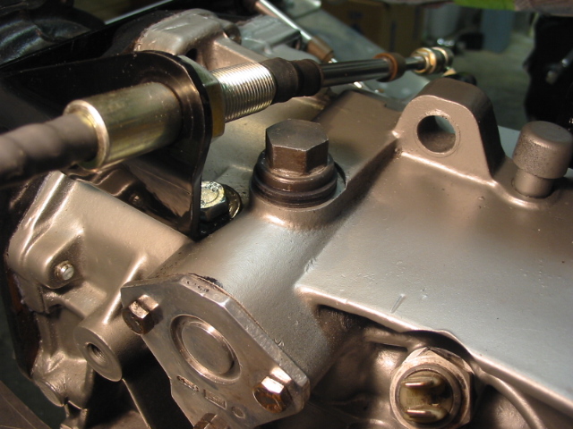

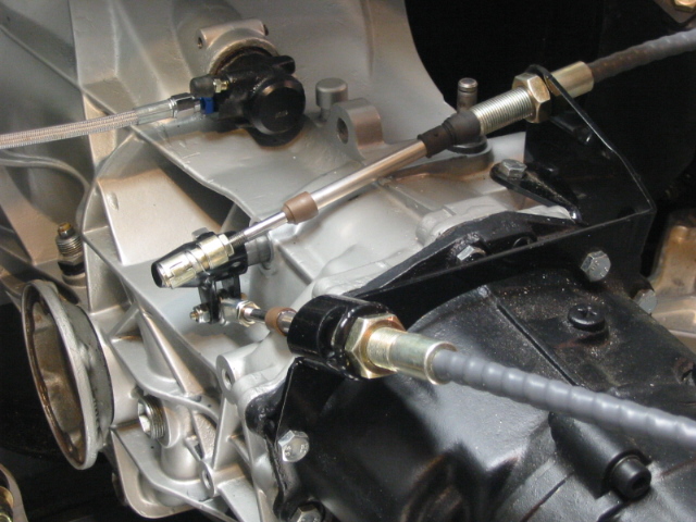

Clutch Slave Cylinder, Linkage
The new slave cylinder easily slid into place. A bit of anti seize will make future removal easier. The pin was hammered into place after we confirmed that the adjustment was appropriate.
The slave cylinder requires a sitting to match it to the -3AN clutch line. This is not a part you will find at your local NAPA or Autozone store. The fitting is a 12 mm to -3AN. We ordered it from Mesa Hose Inc., Costa Mesa, CA. Phone: 949-645-2661. Specify part Goodridge P/N 306-03-M121D / Sachs P/N SH1640.
Brake fluid was added to the reservoir and the line was bled. The slave cylinder is self adjusting, with a spring that keeps it engaged. After installing the cylinder and depressing the clutch pedal, we noted that it seemed to disengage the clutch in an appropriate manner with out any apparent need for further adjustment. It would seem that the parts supplied by Kennedy Engineered Products were designed to be compatible with the stock Audi slave cylinder without further adjustment. This was a pleasant surprise.

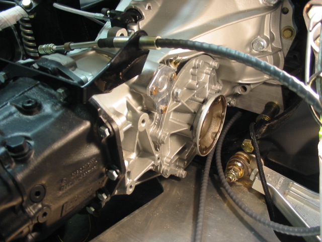

The shifter cables were installed utilizing the bracket and lever supplied by RCR. After trying several different options, we opted to simply run the two cables along the right side of the engine secured to the chassis, then beneath the right half - shaft, up and around to their respective brackets. A couple of clamps will be fabricated to assure the cables remain in place.
The shift mechanism was adjusted. The gear positions were quite evident making this task straightforward. Undoubtedly there will need to be some fine tuning of the shifter cables and, perhaps, the clutch, once the engine is fired up.

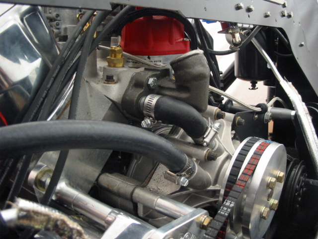

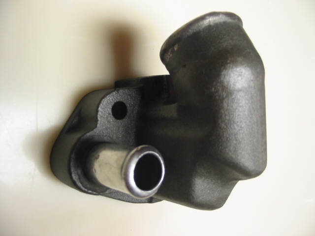

Thermostat Cover

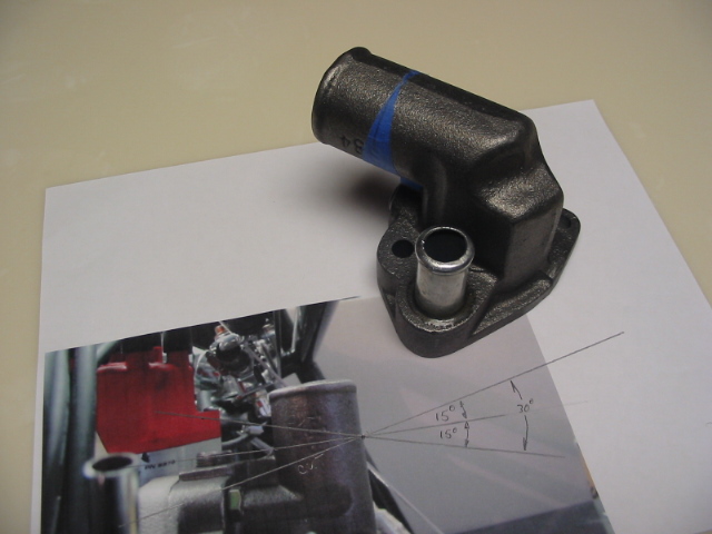

Finding a thermostat housing that would fit proved to be a real challenge. We finally settled on a generic cast iron housing (Stant 31418), cut out a notch and re welded it with a 30 degree backward angle. Below is a picture of the housing before the modification mounted on the engine with a straight edge demonstrating the clearance problem. A close up view after the end was cut off, welded, filed smooth and painted with ‘wrougnt iron’ engine paint is also included.
A 180 degree thermostat was used. A standard Ford 302 bypass hose was added.
The thermostat cover protrudes about a quarter of an inch inside the car, so a small ‘bubble’ will be added to the removable fire wall, similar to the bump to clear the pulley. A quarter inch section of the firewall frame was cut to clear the right angle hose coming from the thermostat cover. This arrangement is tight, but there is enough clearance to, hopefully, avoid any problems.

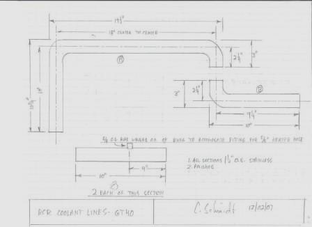

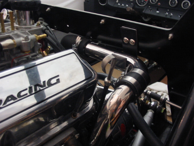

Coolant Hoses, Part I

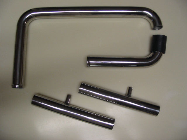

The output from the thermostat cover was routed to the starboard side of the engine and then down behind the alternator. The idea of running rubber hoses close to the exhaust manifold was not very appealing. A detailed diagram of the two sections of pipe needed for the coolant line was drawn up. While we were at it, we decided to also have stainless pipes fabricated for the front section, with connections for the heater hoses. The sections of stainless line were fabricated by Stainless Specialities http://www.stainless-specialties.com. (By the way, they fabricated the side pipes for our Cobra and did an exceptional job). John did an outstanding job. The shine on the pipes was mirror like and the bends were sharp and crisp. Stainless Specialties is an excellent resource for not only exhaust pipes but special projects like this.

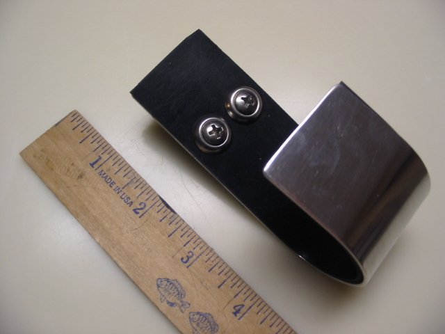

The long sections of stainless tubing needed support. Two brackets were fabricated from a seven inch length of 1 ½ aluminum stock bent in the shape of the letter “J.” Since the hose will move a bit with the motor, the stainless tubing was not anchored to the chassis but rather simply rests in the J brackets. A piece of rubber should prevent vibrations. The visible portion of the brackets was sanded with 1000 grit paper and then polished with Mother’s Billet polish, yielding a shine that rivaled the stainless tubing. One bracket is near the thermostat cover secured to the bulkhead and the second supports the lower most portion of the stainless tube secured to the chassis.
This plumbing arrangement required that the oil dip stick be replaced. Canton provides a dipstick for the oil pan ready to secure to an existing bung. It worked fine.

Now... what I really want to know is... where do I get one of those cool rulers with the fishies?
Rob

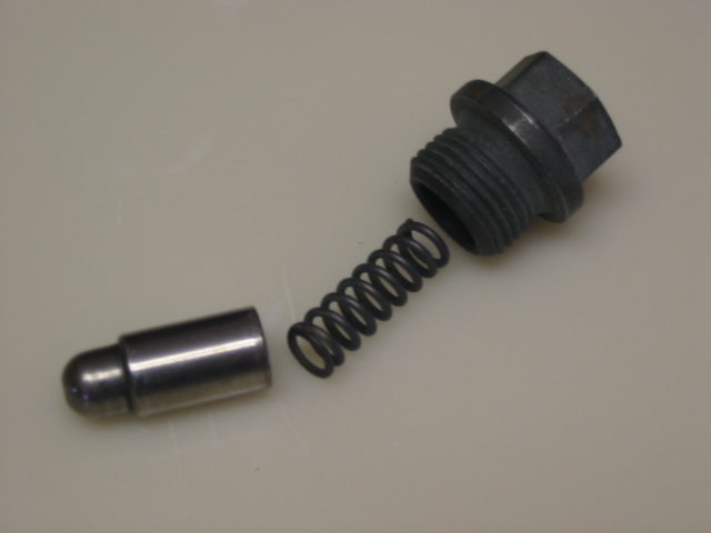

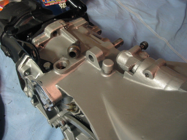

The problem with not being able to shift into fifth and reverse, which we thought was due to a missing detent, was actually an adjustment issue. That discovery was made when installation of a detent had no affect on the problem. A bit of adjustment of the cables and then the tranny slid into all gears regardless of whether the detent was in or out.
When installing the detent, we discovered that one does not simply crank it down. Doing so essentially locked up the shifter. A couple of washers on the detent housing took some pressure off the detent and now it works just fine. With the detent in place, one cannot shift directly from fifth to reverse; you need to go into neutral, a push to the left, then right and back into reverse, which hopefully is how it is supposed to work.

Rob:
That fish ruler is very special. It has the right 'scales' and it works great in wet locations. It has its own 'Perch,' so it can always be found in my cluttered garage. Ok. I am fin - ished.

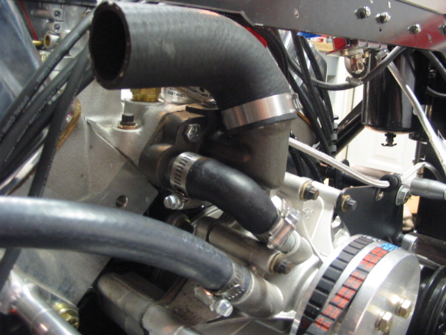

Coolant Hoses, Part II
We found a hose that had a flared section which fit the lower intake on the water pump. (Part number D71281 from Advanced Auto Parts.) It is a tight fit between the lower pulley, AC compressor and compressor belt, but with careful adjustment the hose was centered about a half inch from each of these three obstacles. This hose was connected to a hose with an 80degree bend long enough to reach the aluminum coolant tube (Part number B70541CS from Advanced Auto Parts). The lower end of the stainless pipe from the thermostat cover was connected with two 45 degree sections cut from two additional hoses (Part number E-70755CS from Advanced Auto Parts. You might as well buy six, because you will need four for the front end of the car). A lot of cutting and fitting of hoses was needed to make all the necessary connections. Short sections of 1 ½” stainless were used to connect the hose pieces.
The front connections required four 45 degree sections. Four more hoses were used. (Part number E-70755CS from Advanced Auto Parts). The two straight stainless pipes were inserted, but the heater hoses will not be connected until later, once we are sure the coolant system is working properly. Note that one of the angled hoses on the driver side is cut a couple of inches longer due to the offset of the tunnel.
