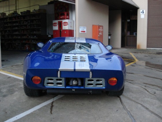

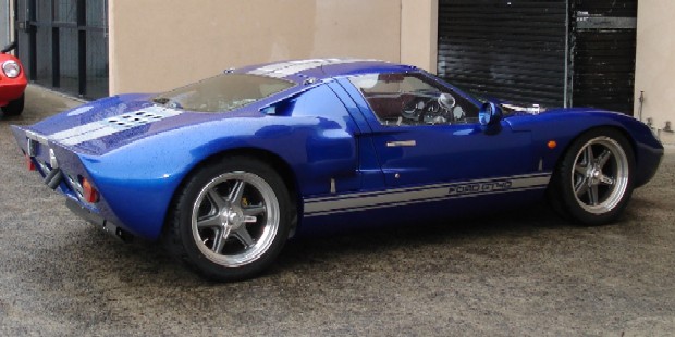

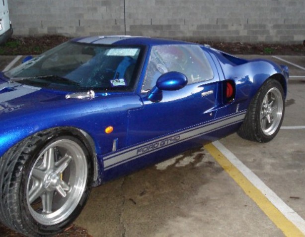

Just wanted to let you know that we have a new member of the RFGT40 team on our Aussie streets. After much heartache, frustration and the odd redesign on the way it passed Vicroads with ease and is now road registered. I would like to take the opportunity to thank Will Croll who took on the build after Robert Logan's demise. If there was one positive thing that I could name that come out of that whole RF mess it is that I finished up with a far better built vehicle. I would also like to thank the NEW Roaring Forties Company, Andrew East, Eddie Edwards, Chris Fahey and all the other Victorian GT40 owners (including the guys on this Forum from whom we constantly looked for new ideas and information) for their invaluable assistance and support.
I believe Will is going to post some build specs shortly.

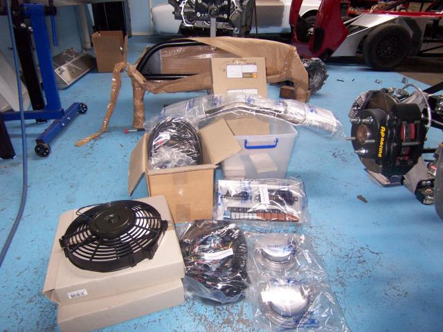

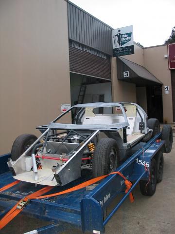

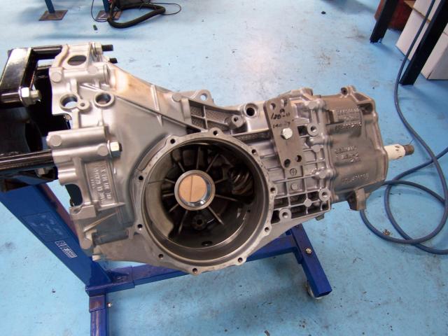

Ok Jack you have inspired me to get going on this one and I hope it sparks your interest.Just going through all the old photos and I guess the best place to start is at the very beginning when I picked up the car from storage with new parts arriving over the following week.Engine, fuel tanks,
LSD,6 speed gear box etc.
Will

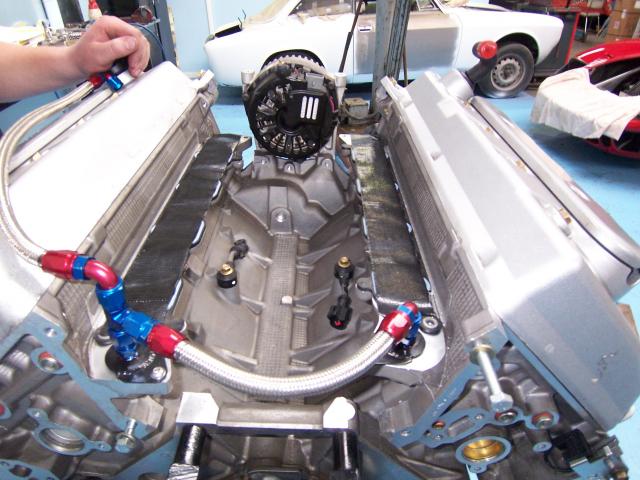

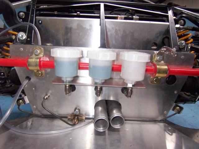

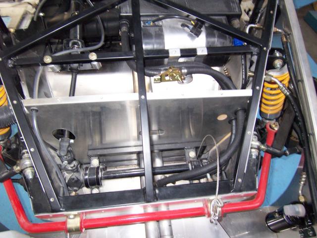

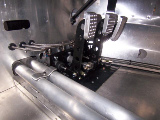

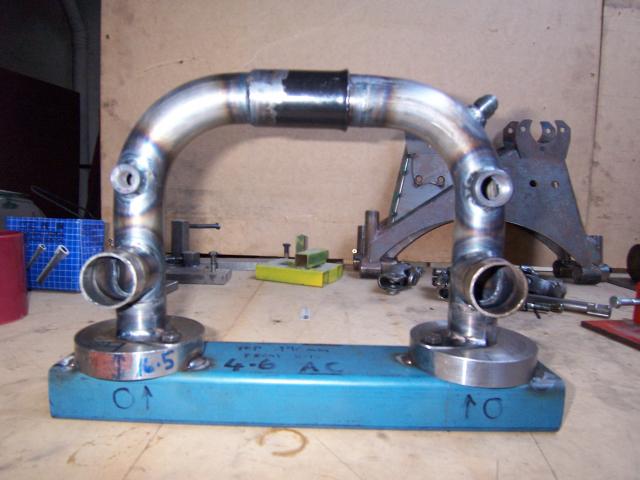

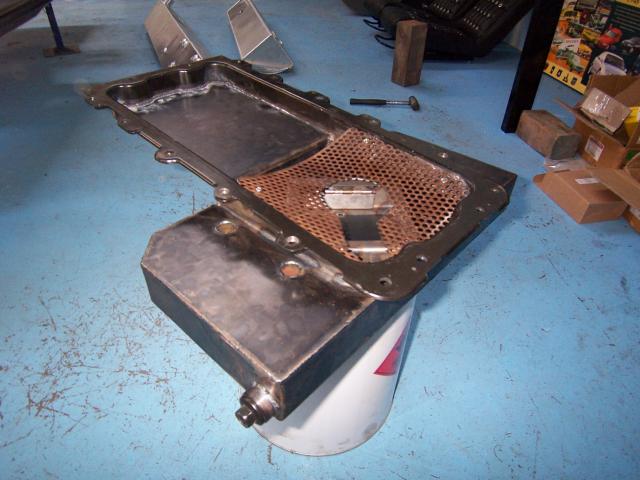

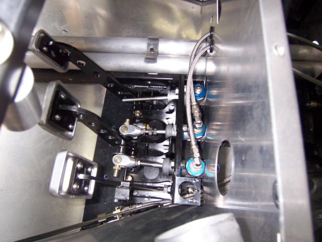

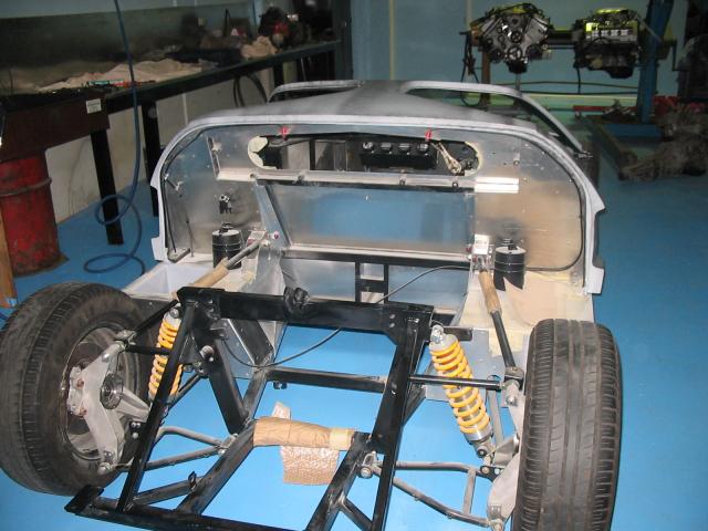

Got the car into place for the build and drew up a job list.I wanted to finish a majority of the plumbing on the car first brakes cluch fuel and some of the water and AC.When the engine bay plumbing was finished then I could fit engine/gearbox but there is still alot of mods to do to get the 4.6 in there.
Sump mod for ground clearance,remote oil filter,water outlet mods.

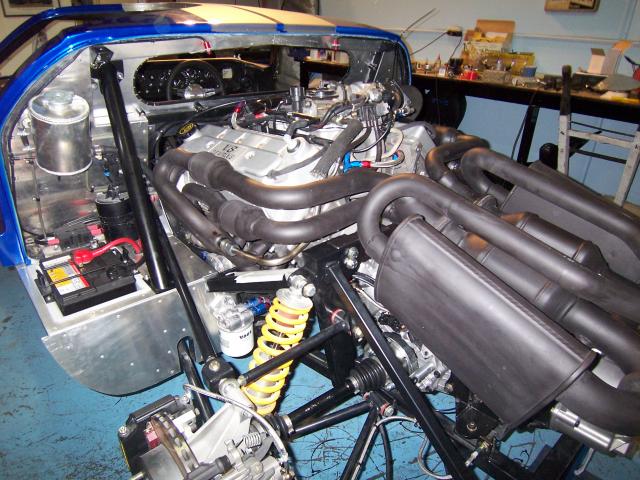

Exhaust is interesting four small precats and two larger cats weighs a fair bit too. Part of what former RF had to do to get the 4.6 engine through AUS emissions. Crazy stuff when the easier option of 5.4 was available for comparative emissions, which is what RF2 guys have now done.
Andrew

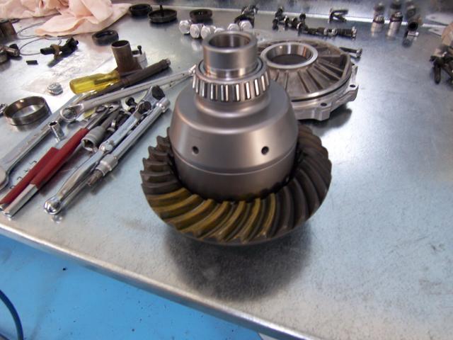

Thanks Andrew,

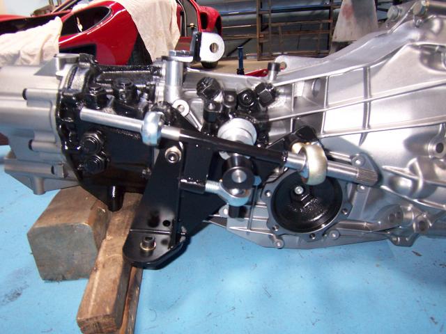

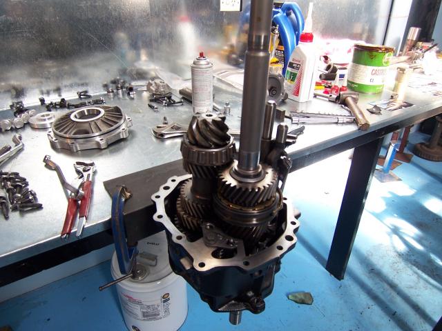

More parts arriving from RF2(exceptional job keeping up the supply of parts to me) and pressing on with the build now preping the engine, fitting the LSD to 6 speed sorting the gear box linkages.The development work on David's car was necessary because RF1 only really finished one 4.6.(2 or 3 under construction). The good news is the hard work on David's car has paid off now because all the development has carried over to RF2 and all nessissary mods are now current spec parts off the shelf.
Will

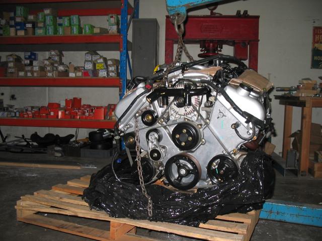

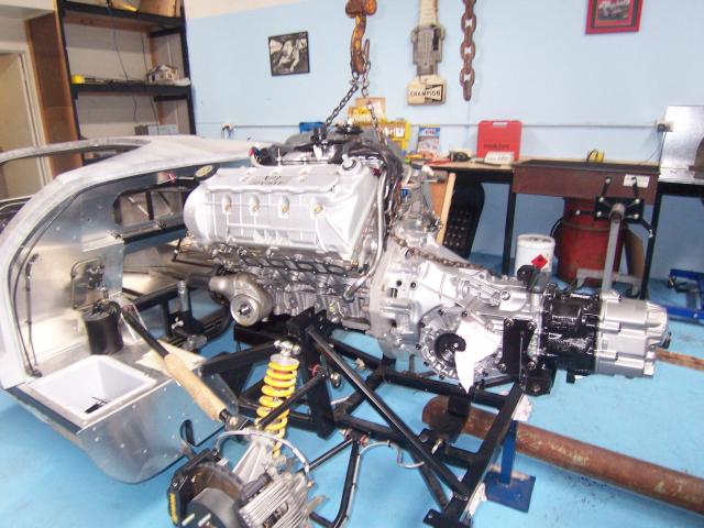

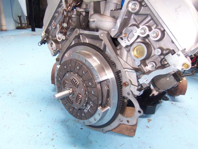

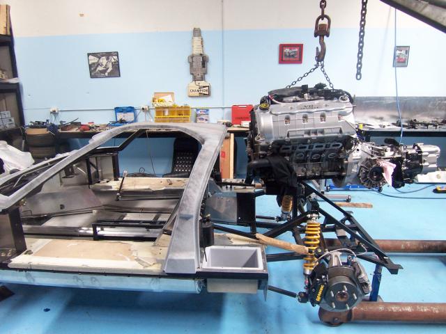

A bit more engine prep & then offering the engine up to the car.
Will

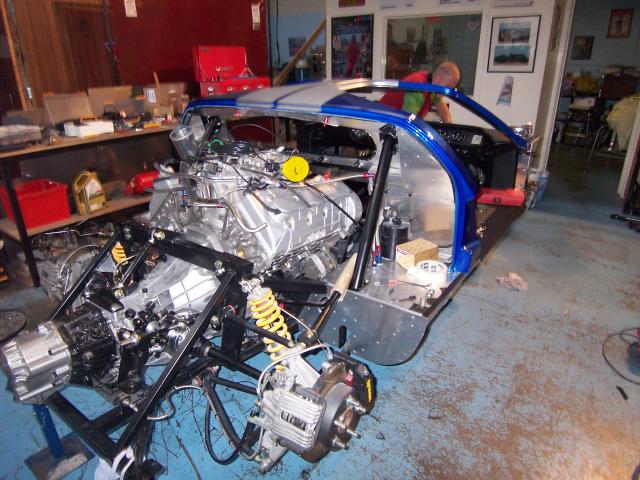

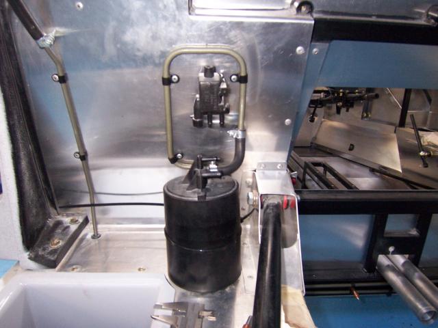

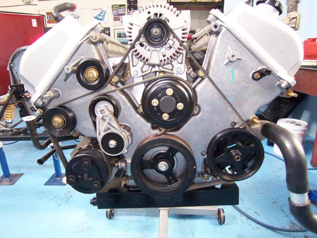

Car is really starting to come together here with the engine fitted we can press on with the plumbing to the engine.Fuel,water,romote oil filter etc.
Also note carbon canistor, we run 2, one for each fuel tank.
Will

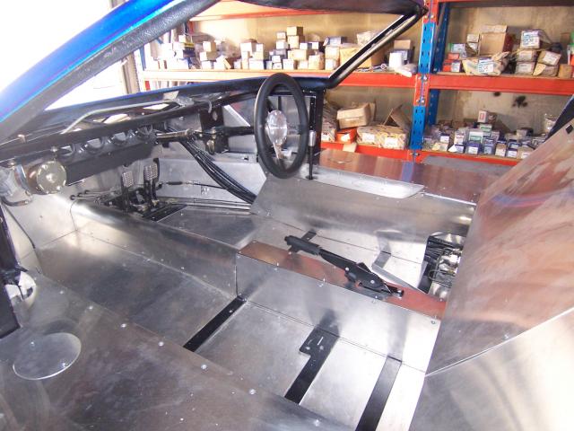

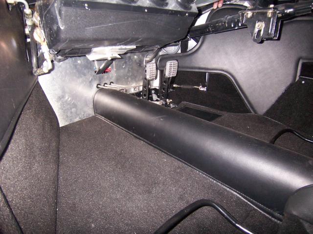

At this stage I am really focussed on getting as much done mechanically as possible before the car goes to the painters. Fitting up the front and rear clip plus door alignment, all went well. Seats and dash are wrapped up waiting for fitment. The plan is to get the car straight down to the trimmers after painting then back to the workshop for finishing and rego.
