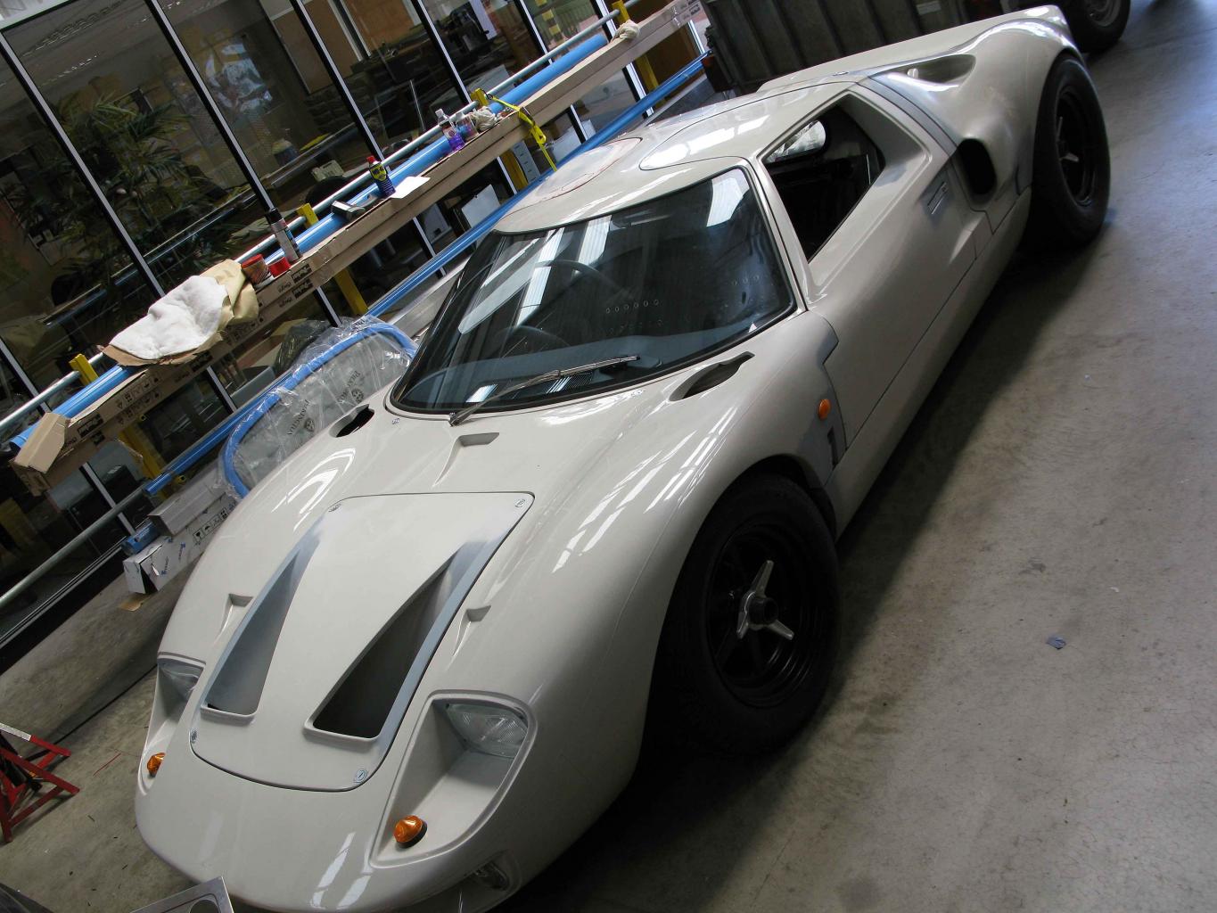

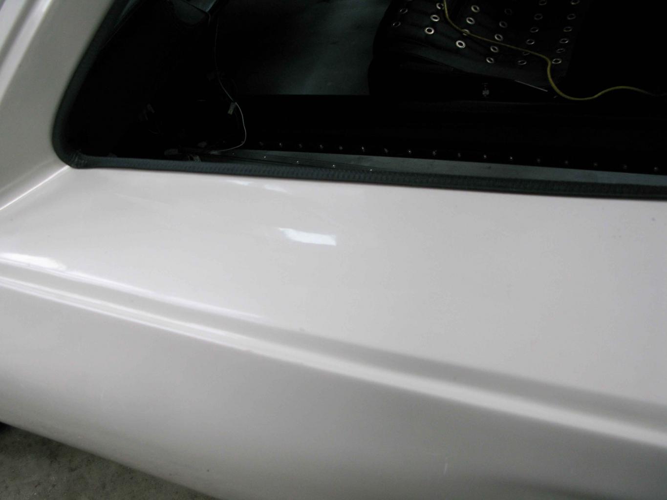

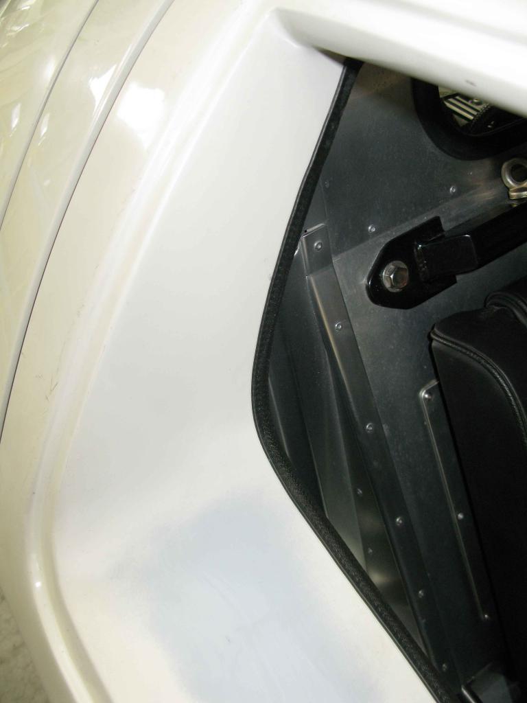

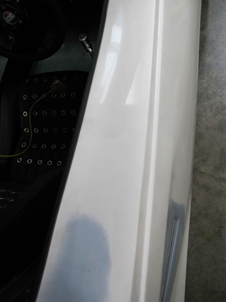

Replaced the drive belts for the alternator and air con pump for better quality ones.
Fitted the edging trim on the inside of the doors to meet IVA requirements. This means thinning the edges of the fibreglass a bit to ensure the trim fits snug. It will be re fitted after painting.
Started to de-trim some bits ready for IVA and had to cut the gear knob down as it was too close to the steering wheel
Not quite sure what else I did but it took most of the day. Trouble is the more you do the more you find to do.

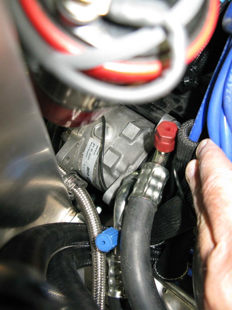

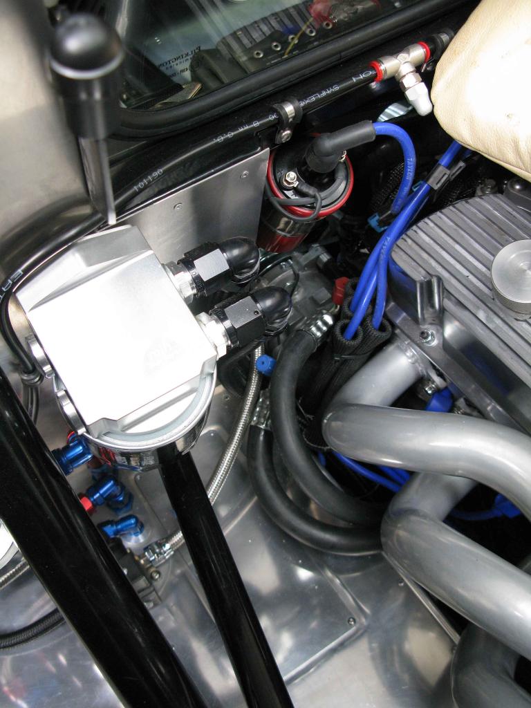

These are the air con filling connections that are built into the elbows that come out of the pump.
As you can see there's not much room in this area but just enough that nothing fouls the exhaust system, heat resistant boots cover the plug leads where they get close. I may move the leads later as I will most likely be fitting a turkey tray heat shield around the injectors, but for now there ok.

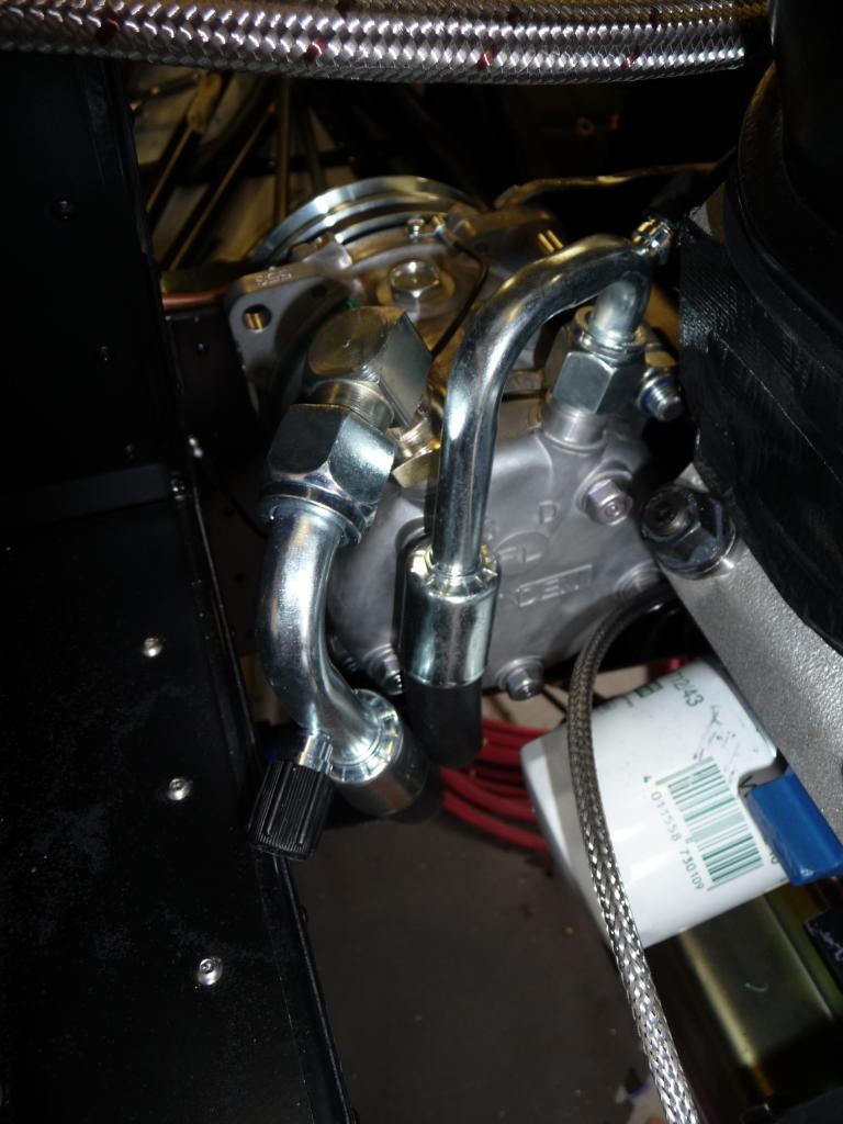

This is how I did my ac pipes.

Neat Martin,
I Noticed you dont have a remote oil cooler and filter also no exhausts on in the photo.
Must be a bit more cramped now ?
How have you found the air con,, early indications are that mine gets pretty cool

I didn't fit an oil cooler and have found I haven't needed one to be honest even after the high temperatures at the lat Classic Le-Mans. The exhaust pipes are quite a distance from the ac pipes but I have to add they are the second set fitted as the original ones sprang leaks. Your car looks fabulous can't wait to see it in the flesh.

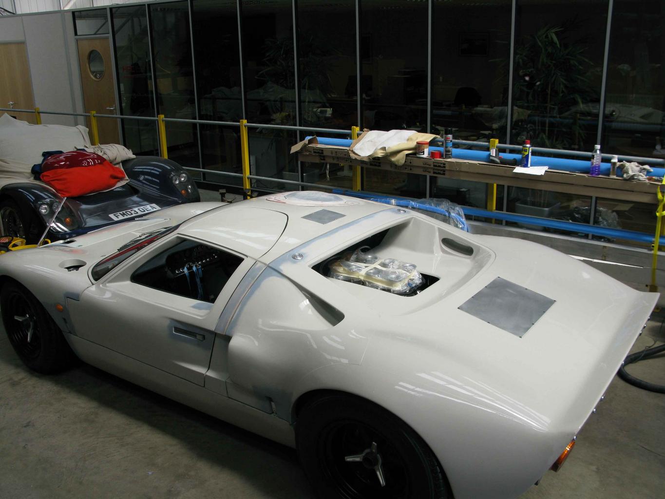

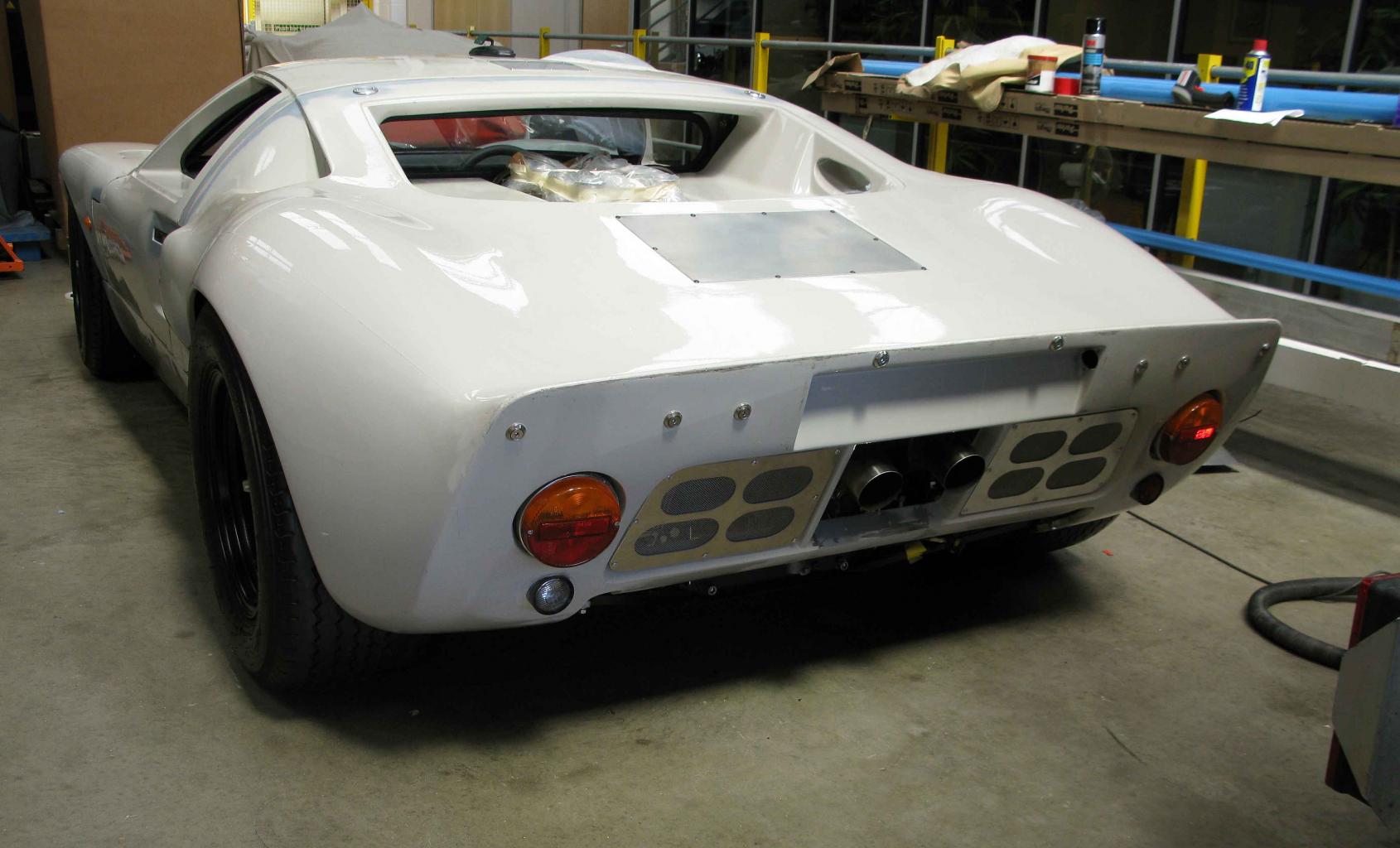

Fitted the new plugs and straight away it was crisp and responsive
fitted plates over where the grill goes
That's it for now
I'm doing no more, just got to wipe the body over and load it on a transporter.

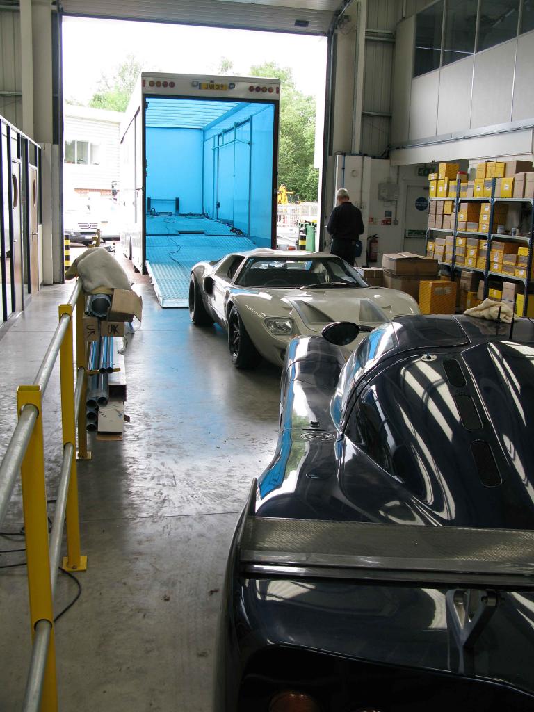

Old 2nd July 2012, 12:55 PM   #310 (permalink)
Keith Baker's Avatar
8 Tenths
Join Date: Sep 2005
GT40: Kent, UK
Posts: 805
Re: Keith Baker's Southern gt on the build

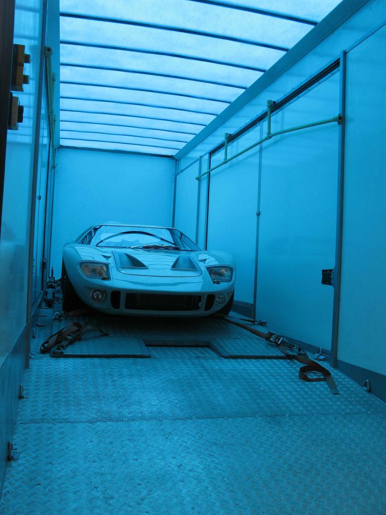

Car collected today.
Bit of an over kill.
Transporter could take 3-4 cars and mine was on its own.
Time now to work on one of the Ultimas while it's away
