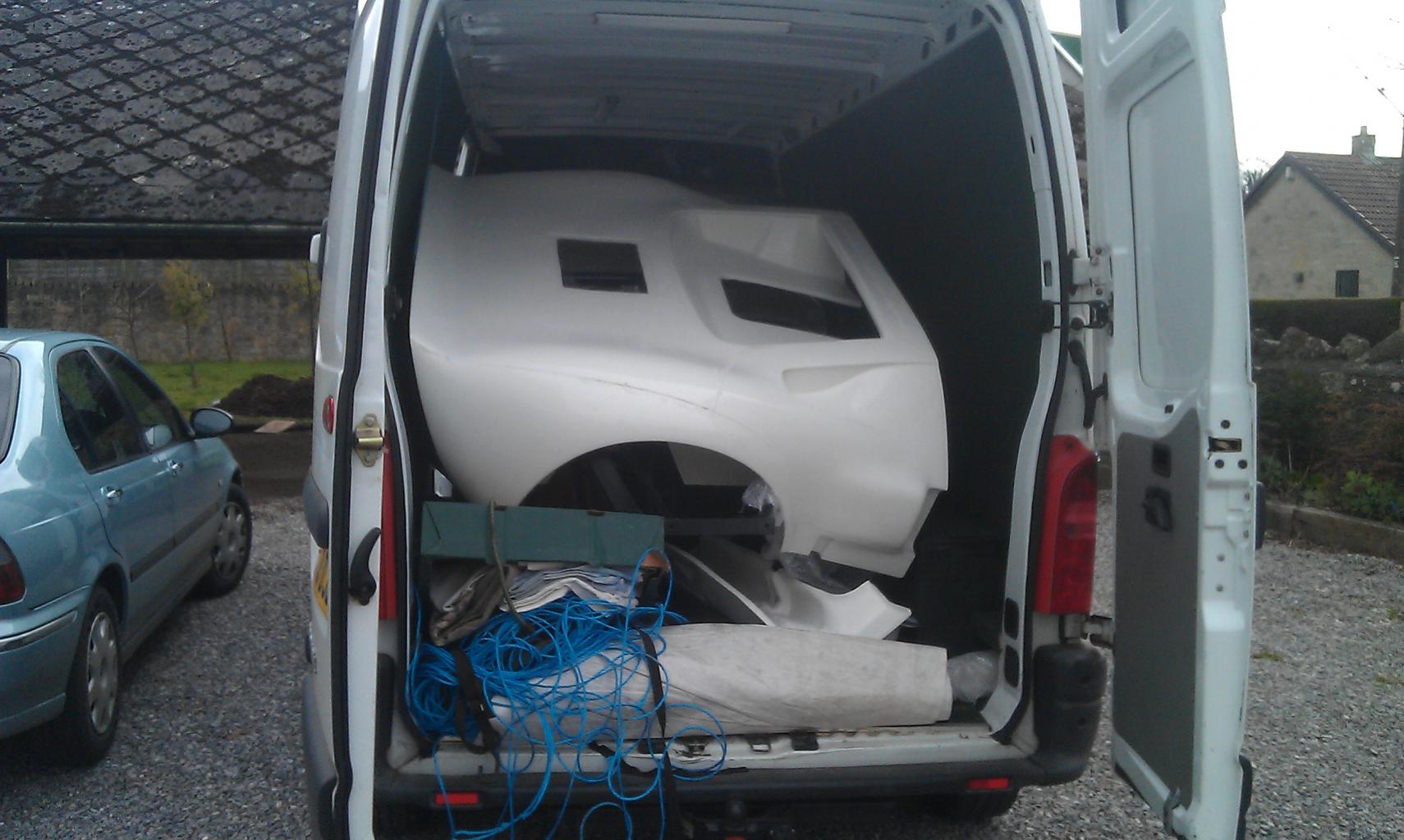

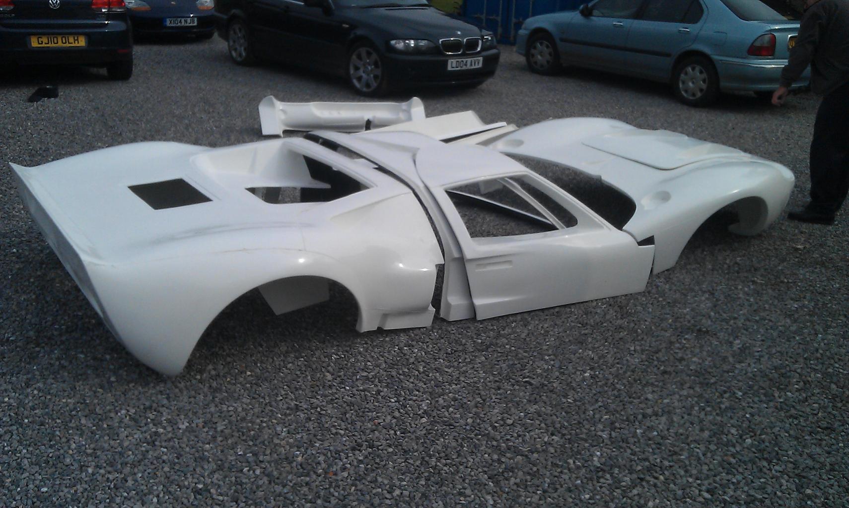

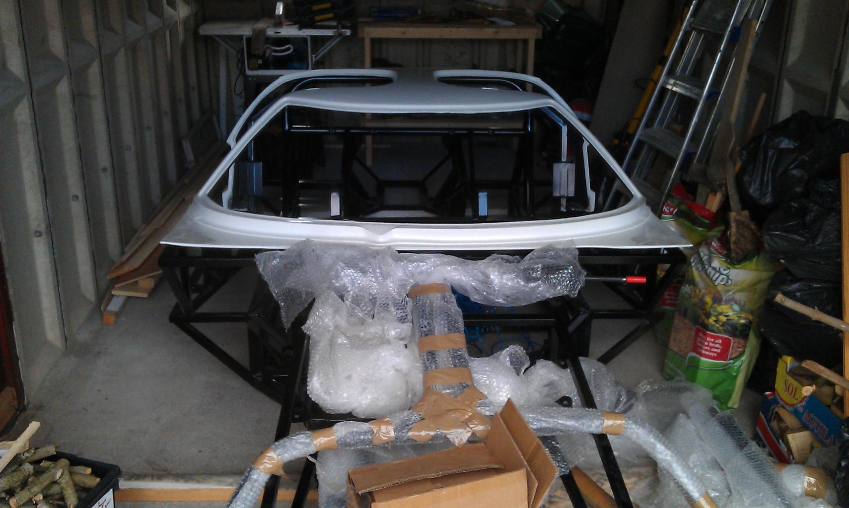

I picked up my GT Forte froms Darrens the other week. Placed my order at the end of February and had an email when I was over in Australia at my fiancee's sisters wedding at the beginning of April saying that it was ready to pickup! It said 8 - 12 weeks delivery time so I wasnt ready for the kit as you can see by my garage photo! Nice one to Darren for the fast delivery time and for all the help in getting it in the van, top bloke and has been kind enough to send me a set of panel drawings too! Cheers Darren.
I thought a Movano would be big enough to pickup the carbut we couldnt get the Ali sheet in as well as the other bits, brother is working in the area this week so will hopefully pickup the sheet plus the black springs (They sent Darren yellow by mistake!) and some suspension fixings.
I havent had chance to do much yet as I was away last week and was'nt prepared for the kit. Garage is nearly clear and organised and when I get the sheet I will be starting on the floor pan. I'm a complete noob at this sort of thing so you will probably find me asking alot of very dumb questions over the years so apologies in advance. I'm not putting any time limits on my build but if I can get it done within 5 years then I'll be chuffed.
So here's a few pic's of me picking up the car.

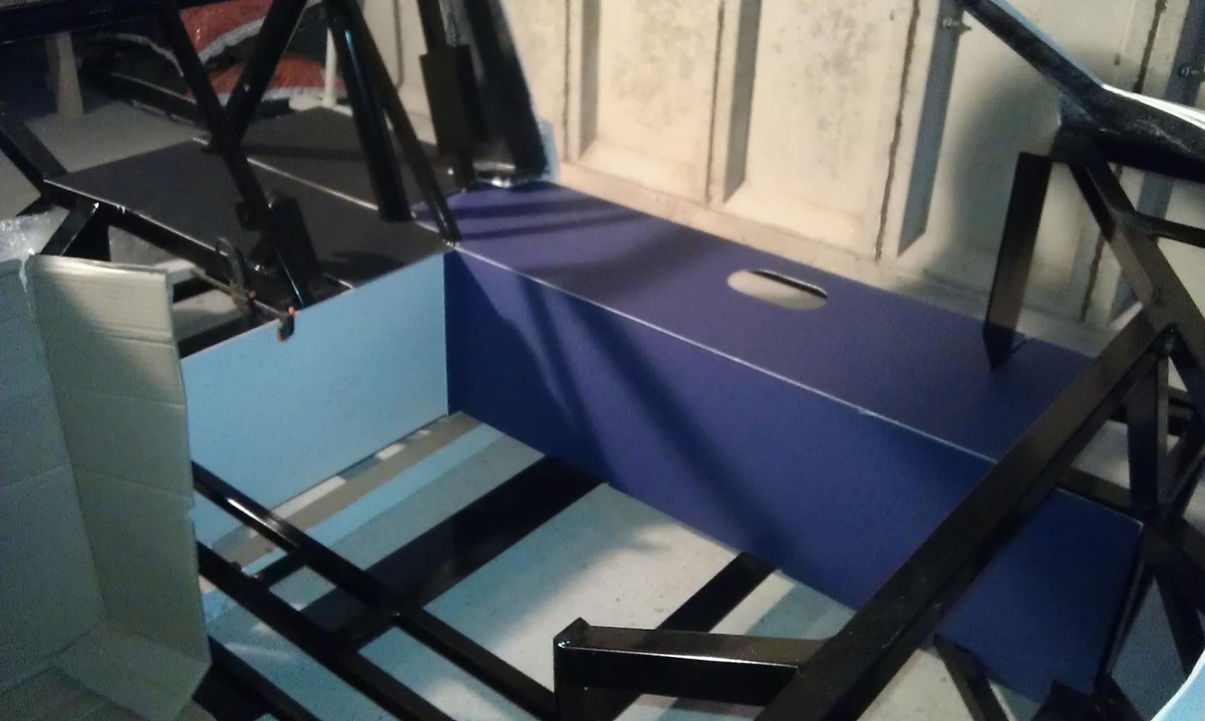

Still awaiting my aluminium so Ive been getting a few more tools courtesy of CBS and machinemart and making some panel templates out of card. Ive been using the drawings supplied and then double checking them and amending them as necessary and putting them into a build folder. These drawings will be sent to a shop to be laser/water cut when I get my ali. Concentrating on the 1.5mm panels first so done sill tops and will do underfloor panels when I get to turn the car. I'm awaiting the ali before I do this so I can get the whole floor panel process done asap so the chassis is inverted for the minimal amount of time necessary.

Just a few pics of my template progress so far. Going to do a few more tonight.

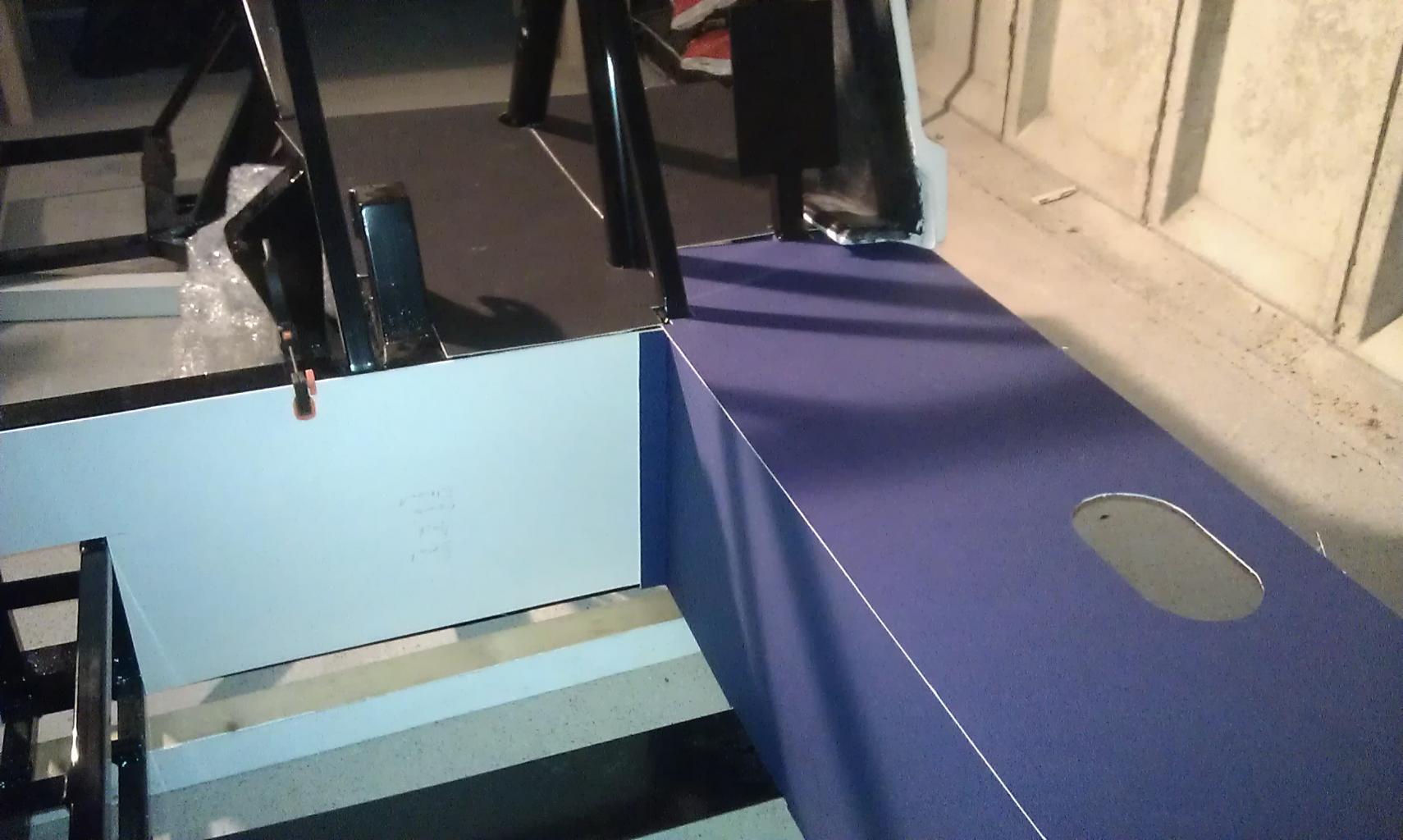

Heres the others

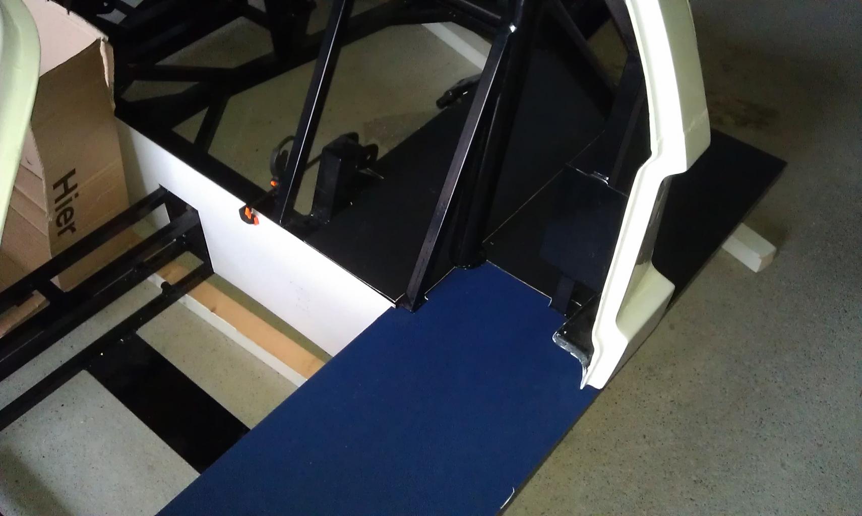

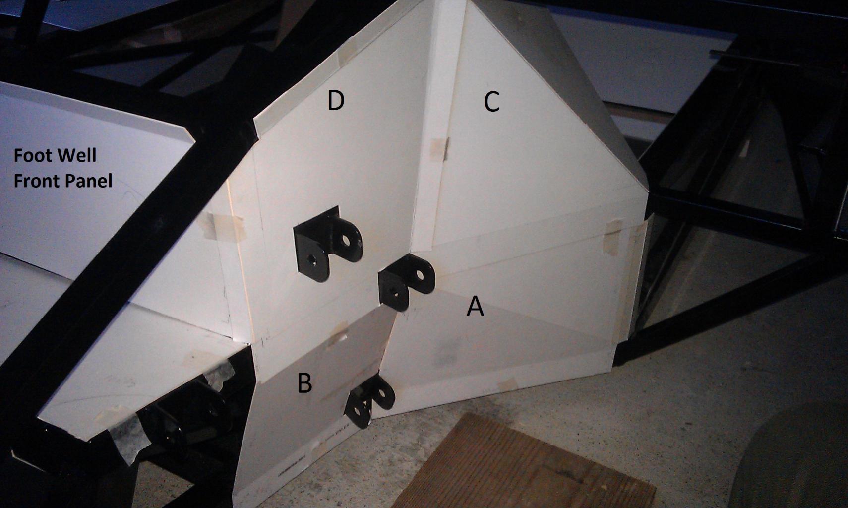

Darrens price is very good, I was tempted but it was something I fancied trying, I did get some drawings from him (Not quite complete set) which I have checked and amended as was necessary for my chassis. Ive been re-doing the drawings as I go, I think Ive done about 75% of the panel templates now which is good and a good timing because my ali turned up on monday. Got to turn the chassis over tonight to do the underside panels.
Ive been getting quotes to get the panels laser/water cut and for the 1.5mm panels only (10 panels) Ive had quotes ranging from £80.00 - £150.00 plus tax (20%). What do you guys think? Should I just go ahead and cut them myself?
Do you guys have an overlap between panels A & B (See drawing) on your wheel arches or did you just butt them together then apply some sealant between? Panel C has been awkward because there is no vertical bar to attach to at the back, I think Ive got a panel worked out now though
Also did you make your footwell front panel out of 2 sheets or one with a 90 deg bend?

Yes, overlap them.
I used two sheets, I think you'd struggle to make it from one.

B overlaps A?

Yes
