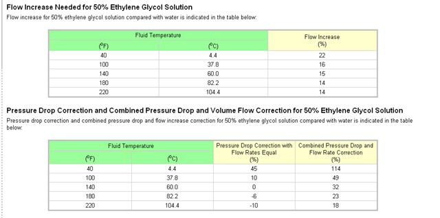

Another thing worth considering is that the dynamic viscosity of ethylene glycol solutions goes up from 0.48 centpoise at a 25% concentration to 0.88 at 50%. This, combined with a lowering of the specific heat of the solution vs pure water, require a flow increase of 14% for a 50% mix at 220 deg F to get the same heat transfer. The chart is from this site: Ethylene Glycol Heat-Transfer Fluid
