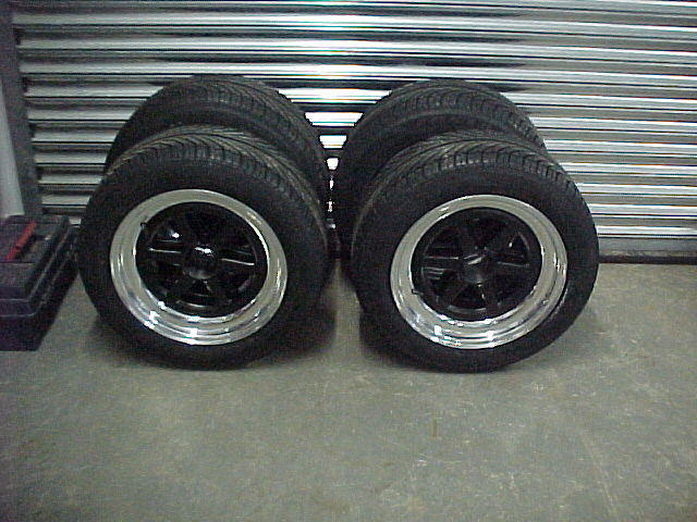

You won't be original with 17's. 16's look more original and there are some decent tyres available too.
Front try: 225/50/R16
Rear try 255/50/R16
J.P
P.S These are 16 inch. Jongbloeds.

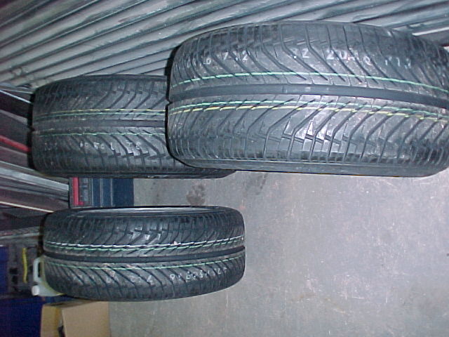

This first set of tyres are Kumho - These were an absolute bargain. I think the 255/50 size ,ZR rated, was £95 each. They were recently tested against Michelin Pilot Sports, the Kumhos came out on top. That is impressive
At this price they have to tried - if only to practice tire burnouts!
I am having another set of Jongbloeds made which will carry Hoosier DOT radials.
J.P
P.S Here is a shot of the tread pattern.

JP,
I have done some extensive searching for 16" tires in 225 &
255ZR16, and haven't found too many with a tread pattern
that I like. The Kumho tires sound impressive in tests,
pricing, and don't look too bad either! Thanks!

I think the most important thing to remember is to make absolutely sure you have the right insets and offsets.
There is no point just buying a set of wheels for your 40. Buy your wheels for your car, measure up properly and ensure they will fit just inside the wheel arches. The difference this can make if profound. [img]/ubbthreads/images/graemlins/wink.gif[/img]
Otherwise you might end up looking like a Gimp! [img]/ubbthreads/images/graemlins/grin.gif[/img]
