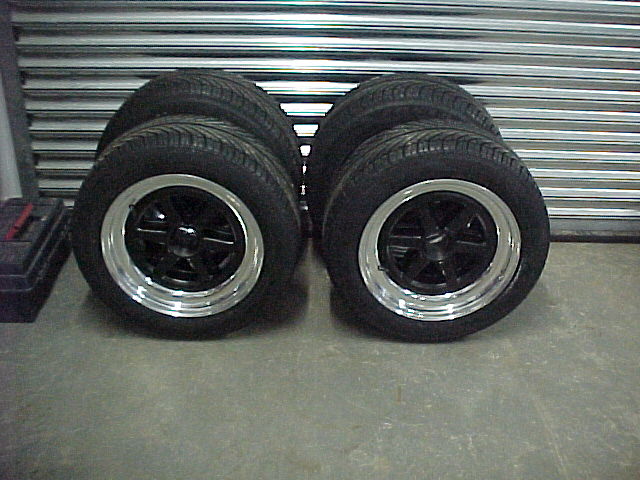

Front try: 225/50/R16
Rear try 255/50/R16
J.P
P.S These are 16 inch. Jongbloeds.
These are a really nice looking set of wheels. I know wheels are a personal thing but I saw a Cobra a few days ago with highly chromed 20inch wheels bearing no resemblance to a normal style. I just wish I'd had a camera with me.He was running normal sized brakes and they looked like they were off a shopping trolley. Be careful out there. Regards

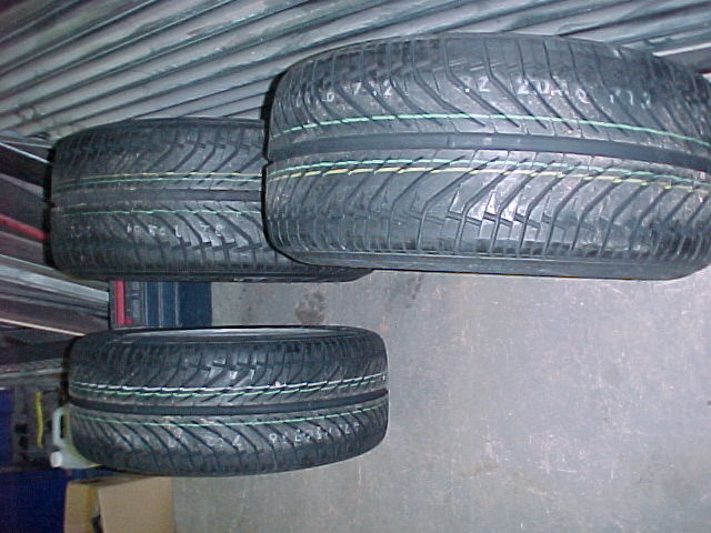

Bill,
This first set of tyres are Kumho - These were an absolute bargain. I think the 255/50 size ,ZR rated, was £95 each. They were recently tested against Michelin Pilot Sports, the Kumhos came out on top. That is impressive
At this price they have to tried - if only to practice tire burnouts!
I am having another set of Jongbloeds made which will carry Hoosier DOT radials.
J.P
P.S Here is a shot of the tread pattern.
