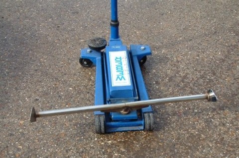

Jacking Front End
I have been struggling with jacking the front end once the front clip is mounted. Many thanks go to Dave Morton for his sending pictures of how he solved the problem. (Yes, I have permission to post!)
Thanks again Dave

Re: Jacking Front End
And the modified jack...
Last one. Well done Dave!
Brilliantly simple!
This Weber jack in the pictures above is the lowest profile
jack that I can find in the UK. I will measure it today and post the height when I get back from work.
Dave
The wheels on the Weber jack are the limiting height at 3" and the centre 'spinner' sits below that with the rubber disc removed. With the Rubber disc it will measure 3.4".
I am not advertising but if anybody is interested send me an email and I can give you the companies details (in Essex, UK).
We also use an air bag jack on our F1 trailer which can lift a Mercedes Sprinter at 3.5 tonnes. I think about 1.5 inches is the minimum height to slide the bag underneath.
