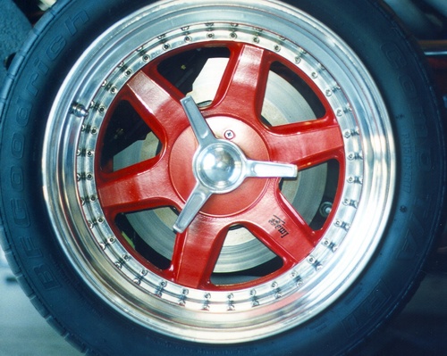

The wear marks on your rotor suggest that the rotor is slightly thicker at the outer dia or that it is warped a little. Did you mic the rotor to check that it is the same thickness at the major and minor dia's of the brake swept area of the rotor. If it is warped or tapered a clean up cut on a lathe should fix your problem. My setup is very similar to yours (except that I have 13" rotors front and rear), and with heavy use of the brakes I experience very little fade even when they get almost red hot.

Hard to tell from a photo, but it looks like hard spots in the rotor casting. This is not uncommon with some cast irons. Typically the hard spots look more shiny than other parts. The hard spots generate a lot of heat compared to the rest of the surface and from the photo it appears that this is the case. Hard spots are best removed by grinding the rotor rather than machined in a lathe.

The marks on the rotor look like hot spots to me. But as you run single pot solid disc rear brakes your fronts will be heavily overworked. GTD dropped the use of solid rear discs after a while and only sold vented rears. My car originally had the solid rear discs and they eat up pads with little braking effect. My record was set of pads gone in 80 miles in one day at Goodwood, lots of brake dust!
From seeing your front brakes my suggestion is to change your rear brakes to either more Wilwoods to match the front or just to the vented single pot caliper set up typically found on GTD's. Your existing caliper will not be alterable to suit a vented disc, discard it! However it is not just a matter of changing calipers and discs over, you also need to mod your rear upright so that the new position of the caliper is better for brake bleeding etc. The steel uprights you need are available from Roy Smart I beleive.
My standard recommendation to owners with cars like yours is to always upgrade the brakes before the engine. Keep your stopping and go power in balance and you will live!

The engine was never touched since i own the car for 7 years now, but i must agree that the 350 hp it gives are quiet hard to stop sometimes ...
I think a grinding of my front discs could be a no wasted time.
