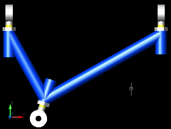

Variations
Moving the weld points as close to the rod end jam nuts as possible will help straighten the load path.
