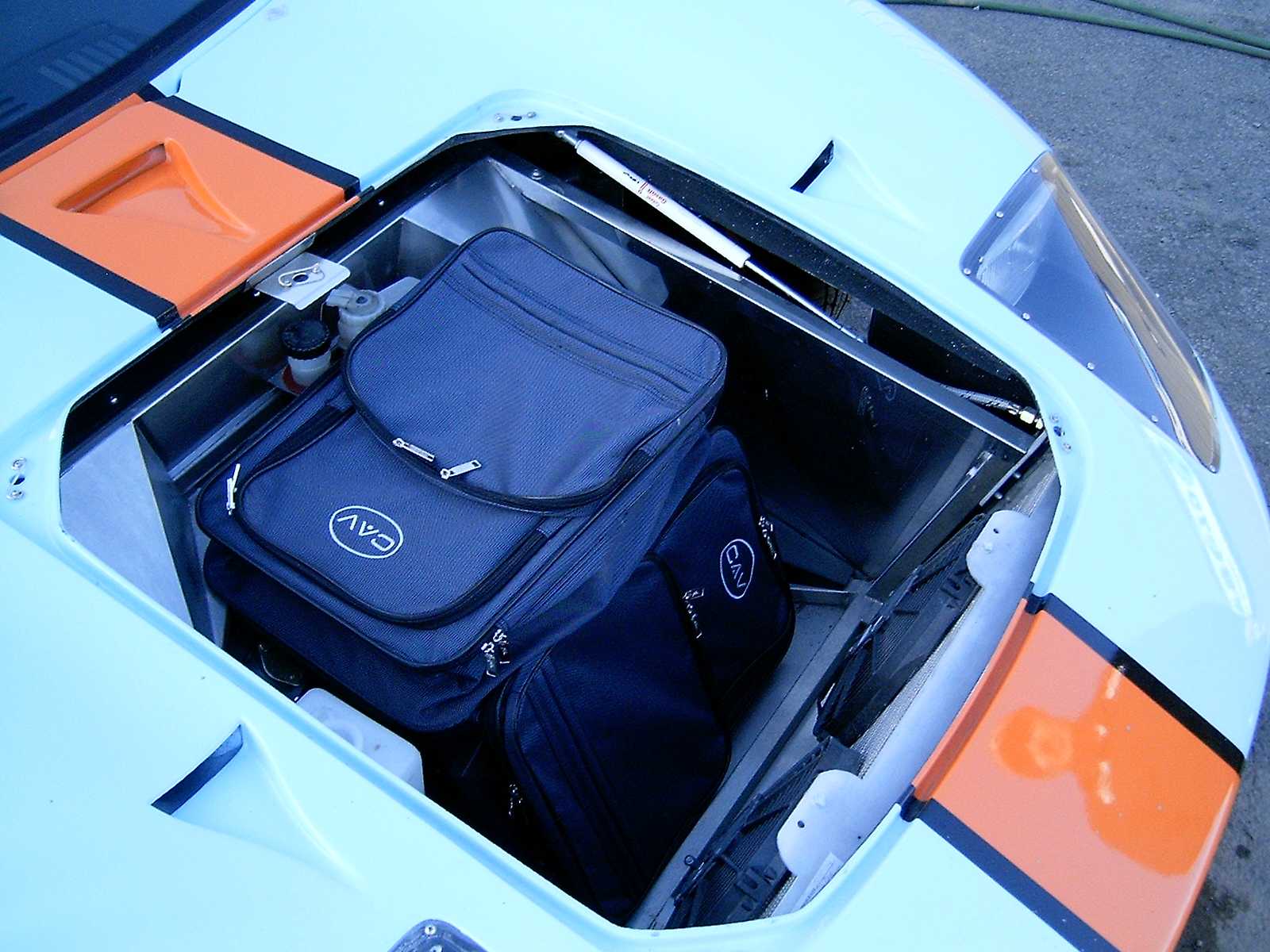

Hi Roy, That's CAV luggage in our cars! Lightweight you know! But I have to have room for a cup holder, Canadians are addicted to Tim Hortons coffee. It's a national epidemic This is Johns' 1076 fitted with our remote brake booster kit and a set of luggage in the nose.

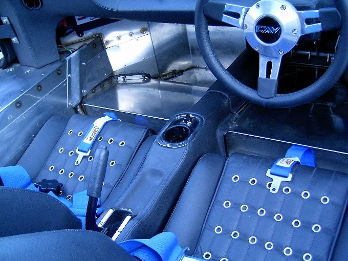

and a cup holder! The plug ahead of the cup holder is the 12v jack for the radar detector, legal in Alberta Nobody stole the shifter, it's right hand shift.
