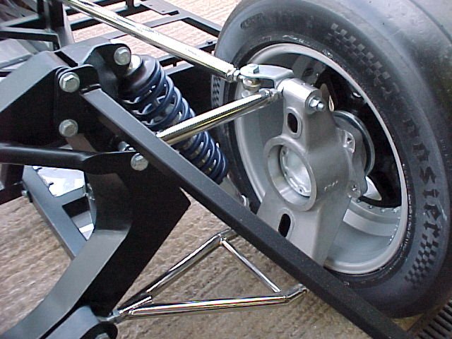

Here is a picture of uprights I have built by modifying Jaguar Xj6 rears the attachment is a casting that is bonded(special epoxy)and then bolted to the existing upright which already has all the hubs, bearings, caliper brackets etc they work good and are pretty easy to come by. these one are from what we call Jaguar X300 (about 1993) not sure that it is called X300 in the states
Denis, try to resize the picture; I'd like to see what you've been doing.
The Thunderbird option is one I hadn't thought of.
Aaron

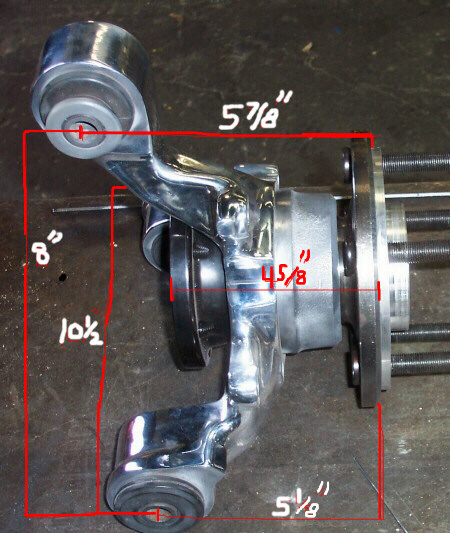

All we use is the Lincoln mark 8 up right,and Timken baring. The hub in the pitcher is the prototype. The Hub we have now is one piece and out of heat treated steel. The micro shaft spindle and hub has a larger spline than a mark 8 and we made to fit the 930 Porsche CV. We made them for the Giant at 720 HP and 2800 pounds and large contact patch I have axles to fit this set up to and can do then in any length. I have used all we made so far. If there is enough interest I could do moor. PS. we can do any wheel pattern you wont Bill E

I hope I haven't missed this, but,if one were to use your uprights, how will that alter(or will it) the position of the tires. What I am getting at is, will the wheels that I already have work, or will the offset have to be changed, waranting a new set of wheels. Will they use the other hardware or will that have to be changed/altered as well(rod ends,arm lenghts etc.). I like the idea of the 930 axels as I am using a 930 box.
