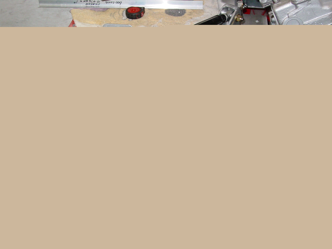

Upright 5 on 5"and 5 on 4 1/2" it will take a 930 CV and 13"brakes I have moor pitchers

I have been looking at the T-bird hub as well and am trying to decided whether to go with the Ford front(mustang II type)/rear Tbird hub or the C4/5 corvette donor suspension set ups.
After seeing your hub, I am definately leaning to the Ford setup. I like the idea of keeping with the Ford name on all my parts if possible.
Is the driveline attachment point/adaptor a standard Porsche part or a Ford that will bolt directly to the Porsche axle?

All we use is the Lincoln mark 8 up right,and Timken baring. The hub in the pitcher is the prototype. The Hub we have now is one piece and out of heat treated steel. The micro shaft spindle and hub has a larger spline than a mark 8 and we made to fit the 930 Porsche CV. We made them for the Giant at 720 HP and 2800 pounds and large contact patch I have axles to fit this set up to and can do then in any length. I have used all we made so far. If there is enough interest I could do moor. PS. we can do any wheel pattern you wont Bill E

I hope I haven't missed this, but,if one were to use your uprights, how will that alter(or will it) the position of the tires. What I am getting at is, will the wheels that I already have work, or will the offset have to be changed, waranting a new set of wheels. Will they use the other hardware or will that have to be changed/altered as well(rod ends,arm lenghts etc.). I like the idea of the 930 axels as I am using a 930 box.
