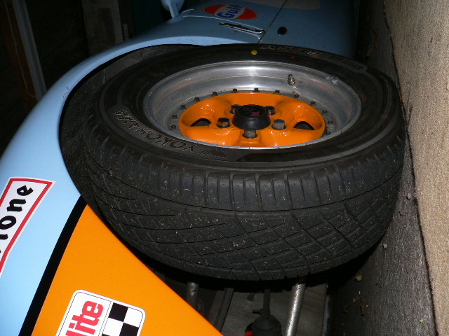

Dave, Last year I was in the same quandary,but eventually found some Yokohamas that were exactly the same dimensions as the BFGs. These are fronts A539 sized 215/60-R15, and rears Y352 sized 265/50-R15.They are both H-rated tyres (upto 130mph)- which is enough for me!
The A539s fronts are commonly used in production car racing, so are clearly up to the job, and are easily available and more to point dead cheap!Currently they are listed on the MyTyres site at £50.90 each delivered. The rears were more of a problem, but MyTyres eventually found me a pair of the Y352s.They are descibed as 4X4 tyres in Europe, but a bit of research indicated that they are also fitted to cars (as per some reviews that I read).So I ordered them and they turned out to be the closest thing imaginable to the BFGs - pattern/construction/weight etc - but just a lot newer and cheaper. I got my 4 tyres for under £200 and to date they are proving to be excellent.If you go for the Y352s prepare for a long wait!
