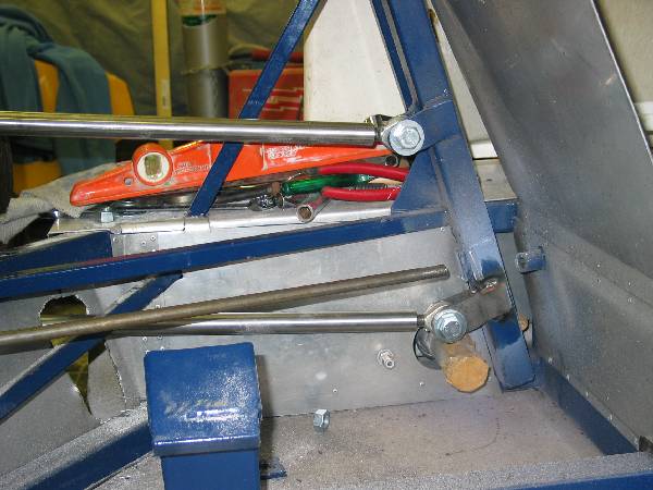

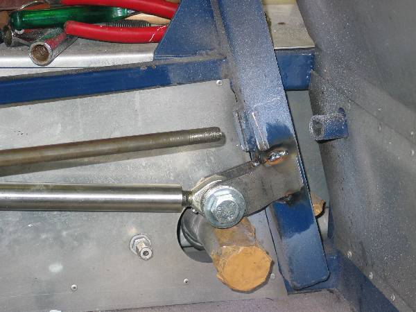

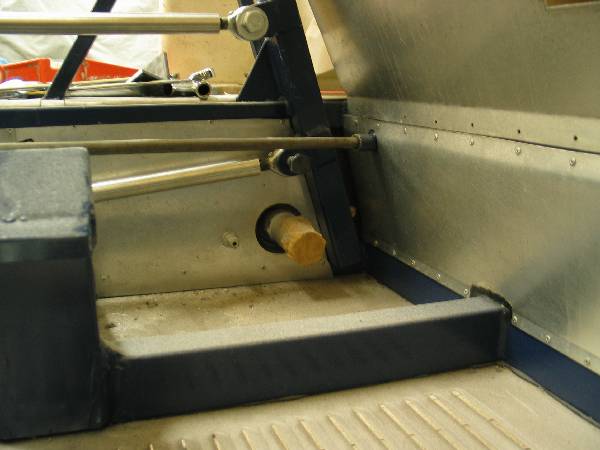

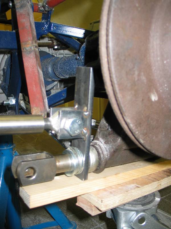

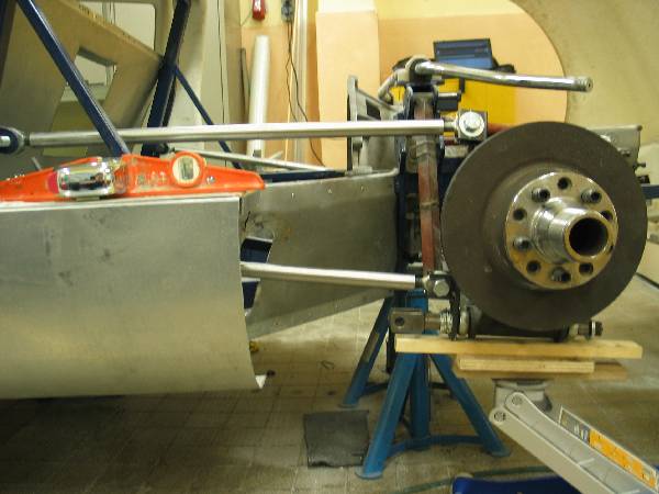

I have finished up a new front suspension that includes quick/easy adjustment rod ends for the upper arm and polyurethane for the lower. Adjustable rod end for the tie rod permits bump steer adjustment. Shown HERE.
The rear that I have been running for the last year has now seen the one rubber joint upgraded to nylon. It can be seen HERE.

Hi Ron,
We're running .750 bore Aurora Monoballs with PTFE liners on our updated suspension systems and Aurora Rod Ends (PTFE) for the toe adjuster too.
I was concerned about ride quality, however it hasn't been a problem and the teflon lined balls should last along time in street use when kept clean and lubricated.
