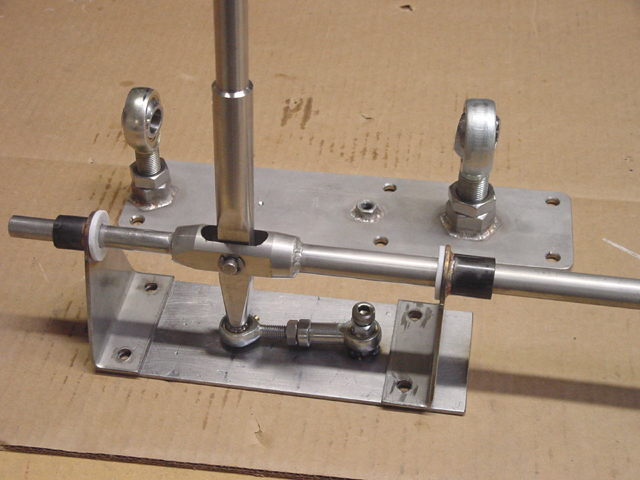

An alternative method of actuation is where the handle directly rotates the shaft and the fore/aft motion is controlled with a rod end. There is a u-joint welded to the shift rod and a rod end at the bottom. Plate structure is aluminium and the shift rod is a fine 1/2" all thread. This allows adjustment of the handle length to suit driver taste and the adjustment of the rod end "throw ratio" at the bottom. Works very well!

As best as I can tell there are only two basic “rod” shifter styles or methods being used on our cars. And now thanks to Ian and Gary we have pictures of both styles.
One design has a pitman arm attached to the transmission rod. The force to rotate the transmission rod, and move the rod back and forth is applied by the shift lever out AT THE END OF THE PITMAN ARM. The stock CAV shifter, and the examples shown by Ian, use that method.
A second method attaches the shift lever directly inline with the transmission rod so all the force applied for rotation and back and forth are exactly CONCENTRIC WITH THE TRANSMISSION ROD. The picture with comments posted by Gary is an example of the second method.
Each of these methods has some advantages which essentially are the subjects of this thread. As I worked with the stock CAV shifter I realized that the overall structural rigidity of the shifter is the key to a crisp feel and a no wobble shift pattern.
The first patch I made to the stock shifter was not enough. I added the two rod ends on a separate mounting plate, and then added an additional base plate just for more structural rigidity. The whole assembly was welded together and bolted to the stock mounting brackets on the floor of the CAV. The improvement was day and night but I was looking for perfection now.
Holding the transmission rod fixed, I could still move the shift lever and see the rod ends flex to the left and right and I could also feel the plastic parts in the pitman arm compress. This picture shows how the transmission rod on the unsupported shifter lever end acts like a pry bar to move the rod ends left and right.

As you can see I used the steering shaft plate mount ball bearings to the alum plates as well as a similar mount near the engine compartment bulkhead. I have a total of three shafts. First joint at the bulkhead next near the starter.

The one Ross uses function exactly like mine. Different support methods.

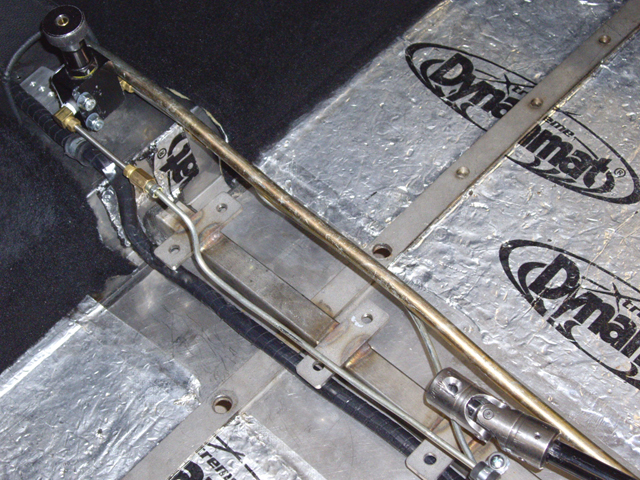

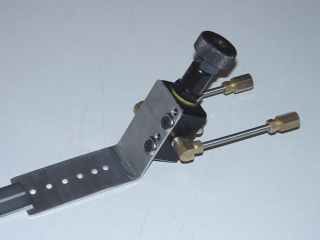

Here is a picture of the space available in a CAV for the shifter. The water radiator pipes are in the side pods and so there is more space available than in some replicas. Good news. On the other hand the brake bias valve on a CAV is mounted ON the stock shifter and it was now in the way of the front rod end of the prototype shifter. The easy solution was to just relocate the brake bias valve 3 inches forward on its own independent mounting bracket. It can be mounted standing straight up like in stock form or it can be tilted back toward the driver with the knob ending up more in the original position. Good news again.
Shifting was absolutely transformed with Jim’s basic prototype. It worked exactly the way Gary and Ross both described for their own versions of this concept. I love the simplicity of the design but Jim and I both thought it needed to go on a diet.

Supporting the transmission rod between two big rod ends is convenient but unnecessary. Since they are always perfectly inline, they could be replaced with plain bushings and Teflon inserts. Likewise the long heavy base could be replaced with a shorter cradle that held the Teflon bushings at each end. The small rod ends that stabilize the bottom of the shift stick were retained. Here is the next step in the sequence of making a trimmed down prototype.
