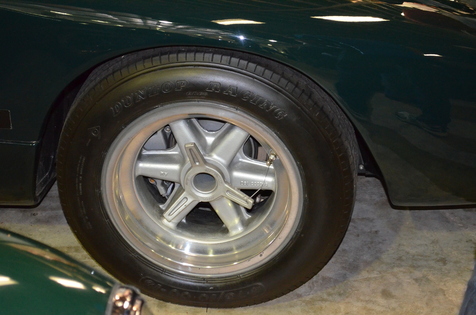

OK, it's a MKII, but this is how 1046 is done....
I did mine just like this - wrapping around the spoke. I protected the spoke by threading the safety wire through a small diameter clear plastic tubing.

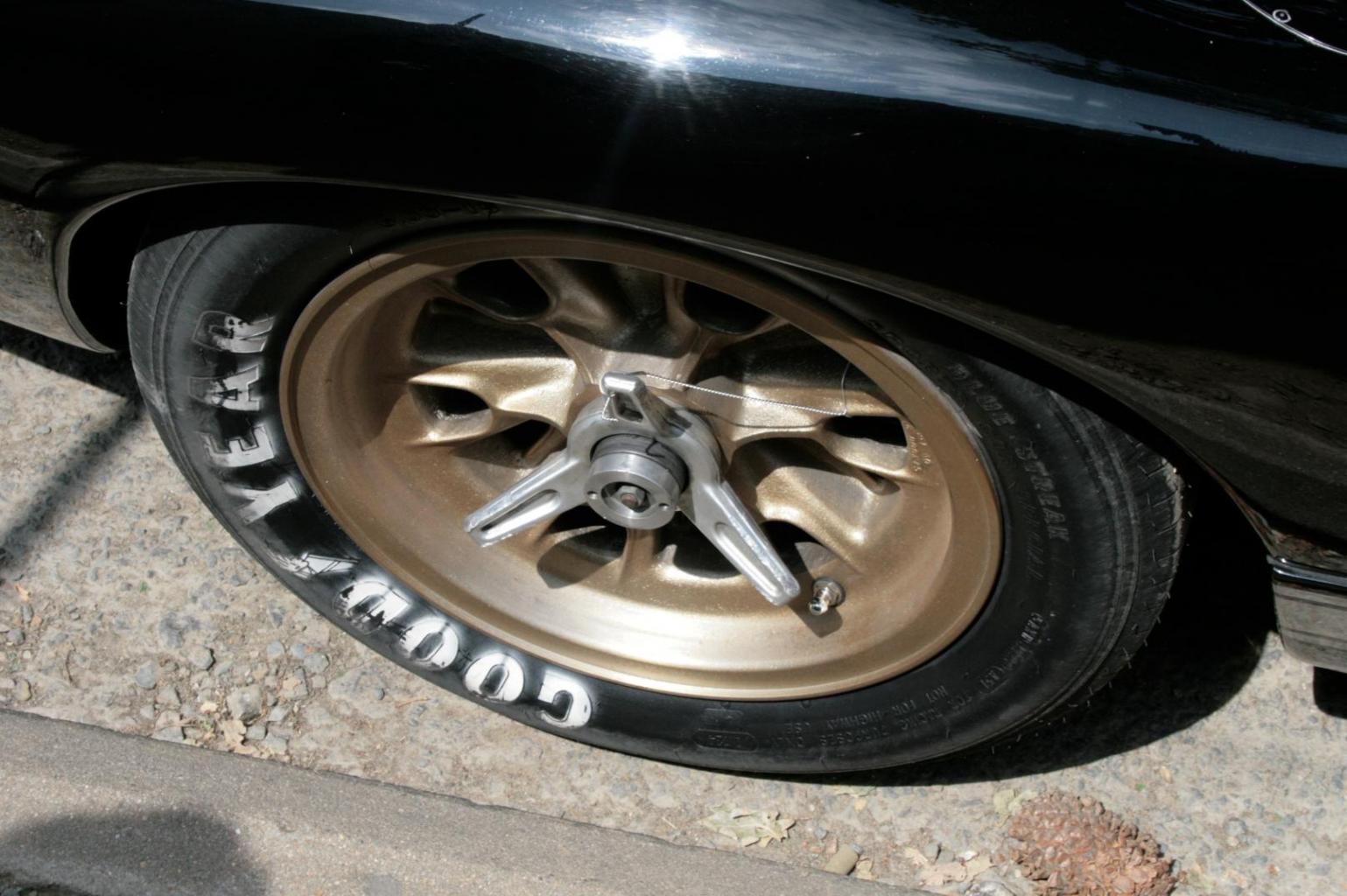

This is how it is done on P1034.
