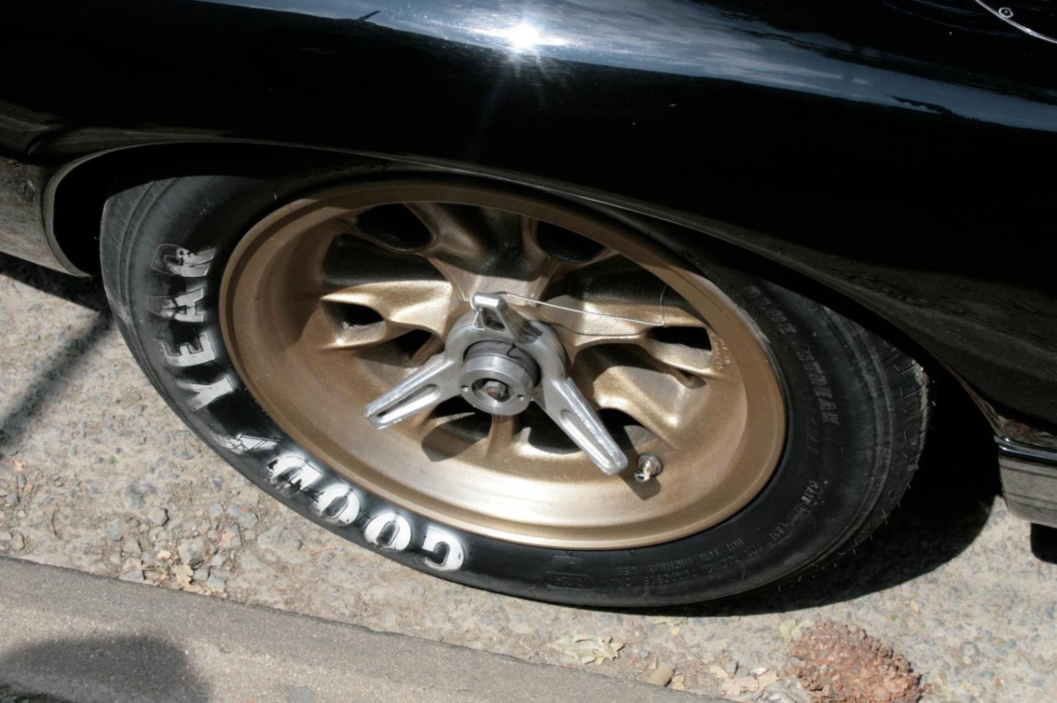

OK, it's a MKII, but this is how 1046 is done....

Drill a hole in each one of the spinner ears. That way no matter which drive pin your re-mounted wheel ends up on, as Jac Mac mentioned, one of the ears is in the right location.
