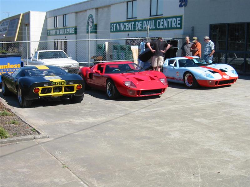

There is a red DRB which has a Lexus v8 in it, it apparently is putting out 220kw at wheels with no mods other than aftermarket computer. Goes well, sounds different but most of this is probably due to 1 pipe per bank exhaust (no crossover)
Regards Des
