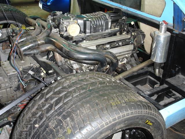

The owner of the twin turbo GT here in Perth has taken me for a couple of rides and it is impressive, to say the least. It was featured in a magazine spread recently.
As for blown GT's, here's a photo of mine with the engine in the tub. Snug, but it all fits.
Lance
Name:	DSC01108 (Small).JPG
