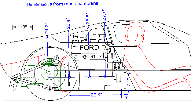

This is the space on an ERA. (That's a special short water pump too.)
It seems to me that if you want to be foolish, there's much more room for turbochargers.
B&M used to have a blower for the SB Ford, but it would not fit in a 40. I really do think there is a market for a Tbird SC type Eaton manifold and kit for the SB Ford. Hell, if I had time I might be interested in making one - I did go so far as to acquire a 3.8L blower manifold to look at while thinking about doing it.
There would be a market for it because you simply can't beat a positive displacement blower - Lysholm, Roots, Screw, etc. Those centrfigual blowers are okay, but they don't provide that proper supercharged feel.
If you are using a SB Ford in your build then a centrifugal is, I think, the only thing you'll be able to fit if you must have a blower. You'll be able to fit it in there, you'll just need to fab all the brackets etc. to mount it. Use a serpentine front dress with the 94-95 Mustang style water pump and you'll end up with a front dress shorter than what Bob describes without special pumps so you can get off the shelf bits and pieces.

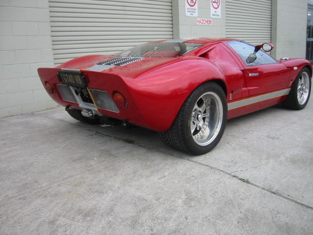

Flatchat and Ron you are both spot on.. But don't the flares and the fat tires look cool? /ubbthreads/images/graemlins/1poke.gif
