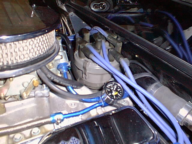

Here are couple of photos of mine, I use the large distributor cap and have no problem at all!!
The car is GTD, the engine has not been lowered and the transaxel mounts are original GTD stuff.
Distributor is cheapy Ford, the cap is an up grade kit the I bought from Jegs. Basicaly turns the small cap Dis. into a large cap (JEGS, ford section of the catalog).

Malcolm...... I would say that the front end (waterpump)of the motor has not been lowered. The engine crossmount has not been modified nor has the motormounts. The two rear donuts that mount the rear of the gearbox were replaced with ones that I dug up in a local parts store that are about 1/2 the thickness of the ones that come from GTD with the kit 3/4" thick instead of about 2". This causes the motor to sit in the car just about perfectly horzontial thus lowering the rear of the motor(flywheel) but not much lower overall. Lowering the rear of the gearbox does a lot of good things, straight driveshafts for one, and about 1 more inch clearance for the headers for another . Hope this helps.
