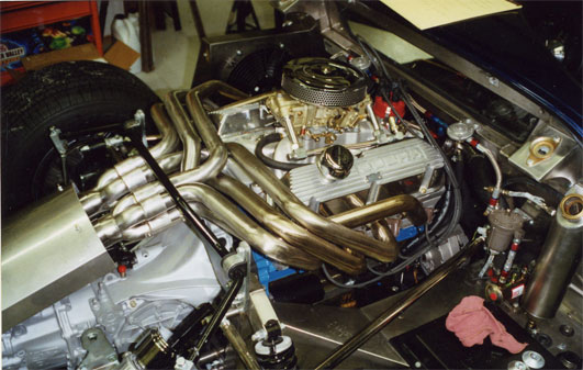

I put one of the svo 345hp crate motors in my CAV. It has the svo aluminum X heads, 600 holly and a 9 qt Kevco baffled oil pan. I went from 0 to 100 with another CAV that had the same motor except it had the gt40 heads and 4 Webbers. Guess what? Both cars went nose to nose the whole way. I guess I saved 3 grand by not going the Webber rute.
