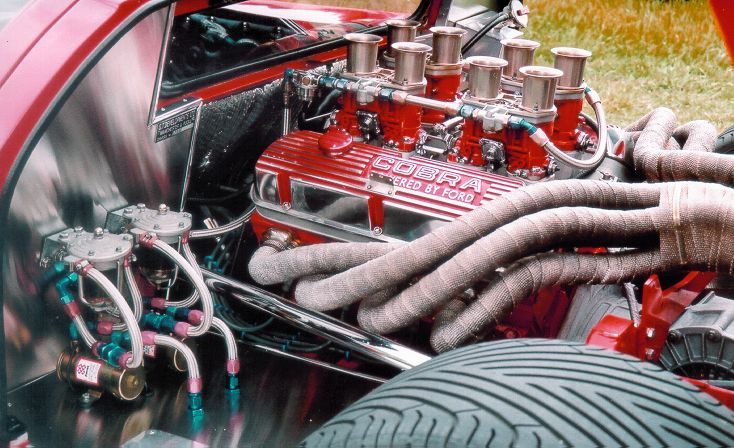

Ron, as you can see mine are jet hot coated and wrapped. After about 4 years I rewrapped them, when I removed the old wrapping the headers were like new. All I can say is that I think they look good and I probably have one of the coolest (temperature), engine compartments found in a GT-40.

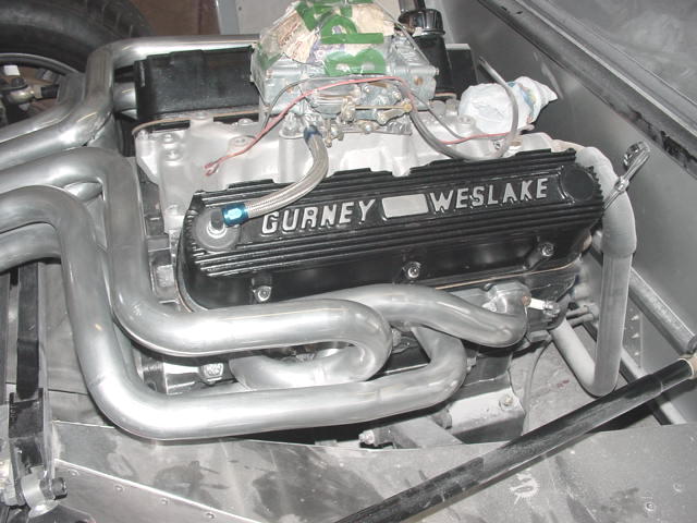

Ron I have had mine ceramic coated inside and out in silver that looks like chrome when finished. The ceramic coating is supposed to reduce the heat/ energy by keeping it in the inside of the which is said to give an increase in HP.Here is a pic of my pipes the motor belongs to Dave Bache
