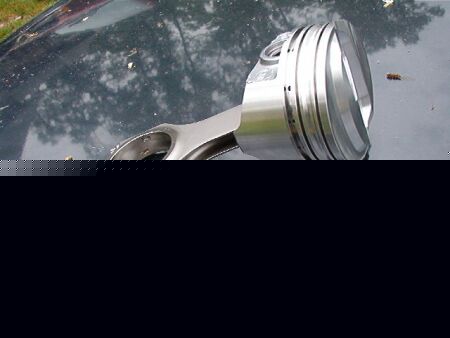

Posts: 226
Rep Power: 9 VICTOR A is on a distinguished road
Re: Pistons for std bore; where?
Here is a pic of my piston and Rod
Vic
