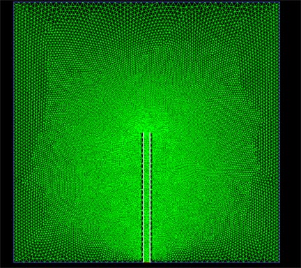

What we are going to investigate is the effect of runner inlet geometry on flow. I have chosen this because it is a very simple case that doesn't require much computer power.
For our baseline case, we are going to look at a simple pipe pulling air from ambient. This could be an inlet pipe sticking way out of a wall into an empty room, or a webber carb with a really crappy velocity stack on it.
In our model, we are flowing air at standard temperature and pressure. We are applying a static pressure difference if 28 inH2O across our test piece. The test piece is 2" wide and 40" long. I know from experience that it takes a length of about 20 tube diameters for flow to become fully developed in a straight duct. This is important because we want to measure the total losses realized due to the inlet geometry. If we were to use a tube only 10" long, we would not be accurately measuring the losses due to the inlet. Of course no engine in the world has runners that are perfectly straight and 20 diameters long. We just want to accurately quantify the effects of the inlet. Anyway, on we go.
Below is the mesh used to simulate the pipe sticking into ambient. All the green lines show the cells that the area is broken up into. Generaly speaking, the more cells, the more accurate the result. If you squint, you can see the pipe walls in white. Don't wory, it will be more clear in the next picture.

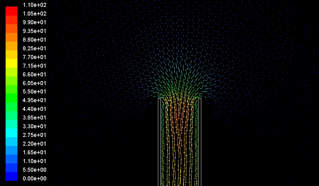

So now we are going to look at the velocity and direction of air flow at the inlet of this pipe. We have zoomed in to look only at the first few inches of the pipe to better see what is going on.
The arrows show the direction on flow. The color indicates the velocity. In this case, blue means zero velocity, while red is 110 m/s, or roughly Mach M=0.3.
The vlocity is practically zero only a few inches from the pipe inlet. As it gets closer to the inlet, it is rapidly accelerated into the pipe. Notice that once it is in the pipe the velocity is not uniform across the diameter. The velocity is higher in the center than at the sides. This is the primary source of the flow losses at the inlet. The little patch of red in the center indicates that there is effectively an area reduction as all the air is trying to squeze into the inlet of the pipe. After the air gets in, it then wants to redistribute itself so that the velocity is relatively uniform again. This is primarily accomplished through turbulent mixing, which is not good.
Also notice that some of the air is actually making an almost 180 degree trun to get into the pipe (the air that is below the inlet and outside of the tube). This is important to notice for later comparison.

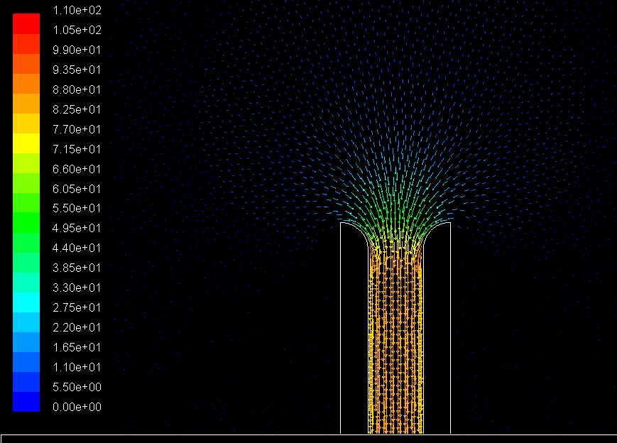

So how are we going to get this thing to flow better? Let's try putting a raduis on the inlet.
Now our inlet looks like some of the better velocity stacks that I have seen.
Although I have simulated several sizes I will only display the largest radius investigated. Here the radius at the inlet is equal to 50% of the pipe diameter. So if the pipe is 2", the radius is 1".
So what do we notice? Well more of the air outside of the inlet is moving toward the pipe. More importantly, there is no red spot in the center of the inlet. Instead the flow velocity is very uniform across the diameter of the pipe. Some may point out that although it is uniform, the velocity is pretty high. Good! That is what we want, the higher the average velocity, the more airflow into the engine.
Something is still bothering me however. Some of the air outside and below the inlet is making a 180 degree turn to get into the tube. Think about it. If you are driving along at 60MPH and make a turn, which is going to cost you more energy, making a 90 degree turn, or 180?

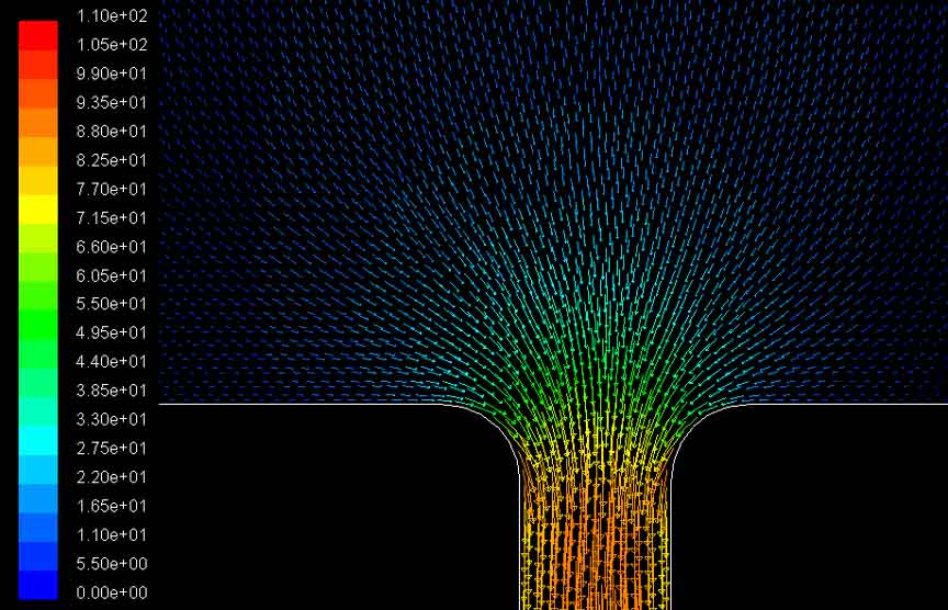

To limit the angle in which the air is alowed to turn, we now mount our pipe inlet flush with the wall. It is no longer sticking out into the room. Now the air can only make a 90 degree or smaller turn into the inlet. In a way we are guiding the air in. Of course after I have compressed the bejesus out of the picture to fit under the size limit you can no lnger see the wall, but trust me, it is there.
Well that is a pretty picture. Look at all that air trying to get in. Compare this to the our baseline nasty sharp pipe in the first post.

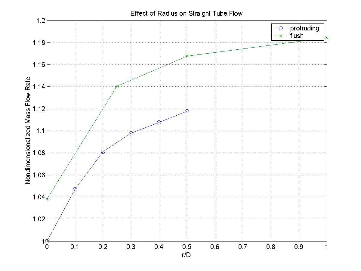

So now we look at a plot of the mass flow rates for the inlets tested.
On the x-axis is the size of the inlet radius (r) divided by the tube diameter (D). For our baseline case it was zero, while the maximum of all tested was 1.
On the y-axis is the nondimensionalized mass flow rate. This is the mass flow rate of each configuration divided by the flow rate of our baseline case. So a nondimensionalized flow rate of 1.1 means it is 10% better than our baseline sharp inlet pipe.
There are two curves, one for the pipe that protrudes out into the room, and the other that is flush with the wall.
The flow rate is increased with increasing inlet radius. There are diminishing returns however. The maximum increase in flow tested was about 18%. That is a huge increase for such a simple modification.
The flush configuration beats the protruding configuration for all radii tested. Why does everybody have thier stacks just sticking up into the air? Even if you just used a piece of sheetmetal with holes cut in it and laid it over the stacks, you would get more airflow!
So does this mean that if you use flush velocity stacks with an inlet radius equal to the diameter of the primary runner that you are going to see an 18% increase in flow through your engine? Unfortunately not. The inlet to the primary is but one resistor which is in series with many other resistors. The largest of which is the intake valve. Still, every little bit helps!
Because our simulation is generic, the results can be applied to any case where flow is accelerated into a duct, be it the primaries, the throttle body inlet on a fuel injected engine, brake duct inlets, you name it.

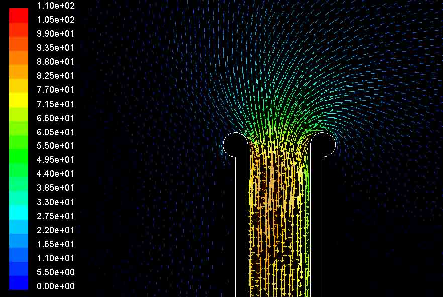

What was supprising to me was the velocity distribution. It took some time for the model to converge. As it was running I wondered if this could indicate that the flow pattern was somewhat unstable for some reason. Sure was. Look at how much air is coming around the right lip, while almost none is coming around the left. The result is that the velocity is not as uniform in the pipe. Pretty interesting. Now some may wonder "if the model is symetric, how could it of came to an asymetric velocity field". Well the pipe is symetric, but the mesh is not. I bet that I could remesh it and get it to preferentially pull from the left side as well.
Anyway, in the end we have illustrated that the greater angle you force or allow air to turn, the greater the flow losses. Any of you guys remember your high school physics? Work=Force X Distance A force is being applied to turn that flow around 180 deg to get it in the bellmouth. This work is not for free, it results in a greater flow loss.
