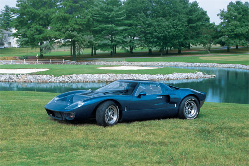

If the GT-40 you saw at Hooter's was blue and was near Kenasaw it was my CAV. You must have a lot of money if you want an ERA and want to waite for years to get your car. [img]/ubbthreads/images/graemlins/cool.gif[/img]

OOPS, I sent the wrong colored car that you saw.

I think you saw the solid blue one. This is it. Joe

The #6 car that I sent first IS a BIG SHOW OFF!!! Joseph [img]/ubbthreads/images/graemlins/grin.gif[/img] [img]/ubbthreads/images/graemlins/grin.gif[/img] [img]/ubbthreads/images/graemlins/grin.gif[/img]
