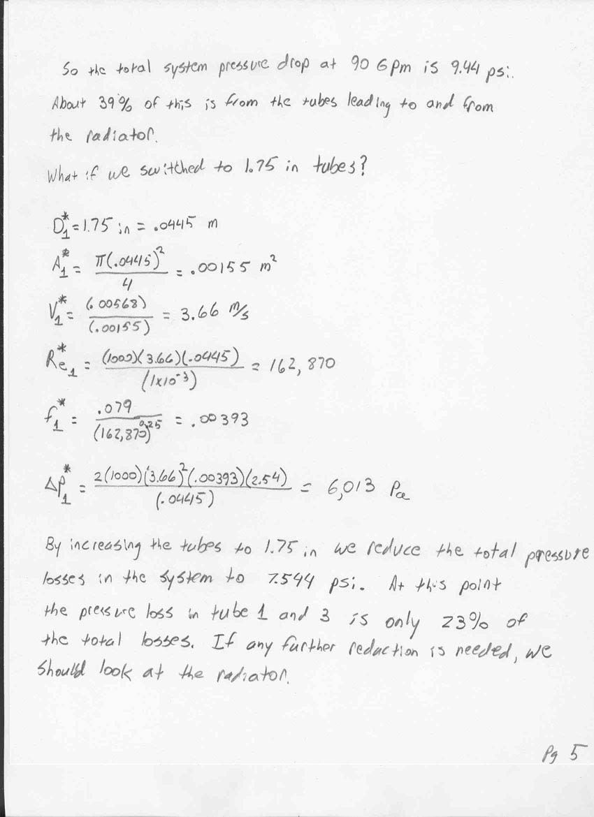

WOW!
I knew I should have kept at my engineering degree instead of switching to geography... [img]/ubbthreads/images/graemlins/blush.gif[/img]
I guess in the end though I am still an Air Force pilot with a 4 year degree that I use on occasion [img]/ubbthreads/images/graemlins/wink.gif[/img]
So Adam, from what I am interpreting from your awesome engineering of the example system is this:
Increasing the size of the transfer pipe to as large of a size as possible is GOOD (weight increase aside)
If that is not possible, then look at increasing the size of the radiator surface area (if possible) GOOD
However, overall, in a system that is lets say maintaining an overall pressure (at the radiator cap) of 16psi...the water pump should be able to at least generate a pressure of somewhere between 23-26psi in order to keep proper cooling and flow.
Am I thinking right? And if so, what can most "standard" waterpumps produce as a PSI at idle? (or is this really an issue?)

awesome Adam,
So your end result figures are
1.5 tubes 3.64 PSI drop
1.75 tubes 1.75 PSI drop
radiator 5.8 PSI drop
1.5 tubes and rad total 9.44 PSI drop
all at 4,000 RPM and 80 GPM (I'm assuming that the typed entry before the calcs, that says GPH, is a mistake because in your scanned calcs you use GPM.
Percentage wise your figure is 5.8/3.64 = 1.6 times more drop in the rad compared to both 1.5 tubes.
IF (dohh) I had added the 1.5 return line my figures would have been
1.77/1016 = .00175
.00175/.00095 = 1.84 times more drop in the rad compared to both 1.5 tubes.
So I got close even though it was probably luck and all I ended up with was a percentage comparison, not hard numbers like your PSI.

Well not too bad for some calculations on the back of a bar napkin eh? We got pretty close. Last night it did occur to me that the engine coolant passages represent a significant restriction. We really don't have a good way of estimating it however. I guess I could strap the coolant system, block and all, to my flowbench. [img]/ubbthreads/images/graemlins/grin.gif[/img]
I had that SAE paper and didn't even think about looking at it. Kalun, you have the sample calculations, run through it for the cross flow for us. Maybe I'll look into estimating the horsepower loss. It will only be an estimation though.
Wolfman, you are confusing your pressures. The pressure rating of the radiator cap is for the pressure difference between the radiator and ambient (atmosphere). If the pressure difference between the radiator and atmosphere is higher than the rating, then the cap will open to vent pressure. This is to prevent blowing hoses off and splitting radiators. The pressure difference we are talking about is between the inlet and outlet of the pump. This is a completely different quantity.

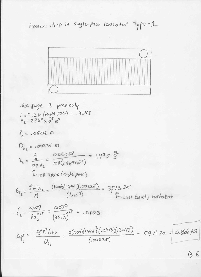

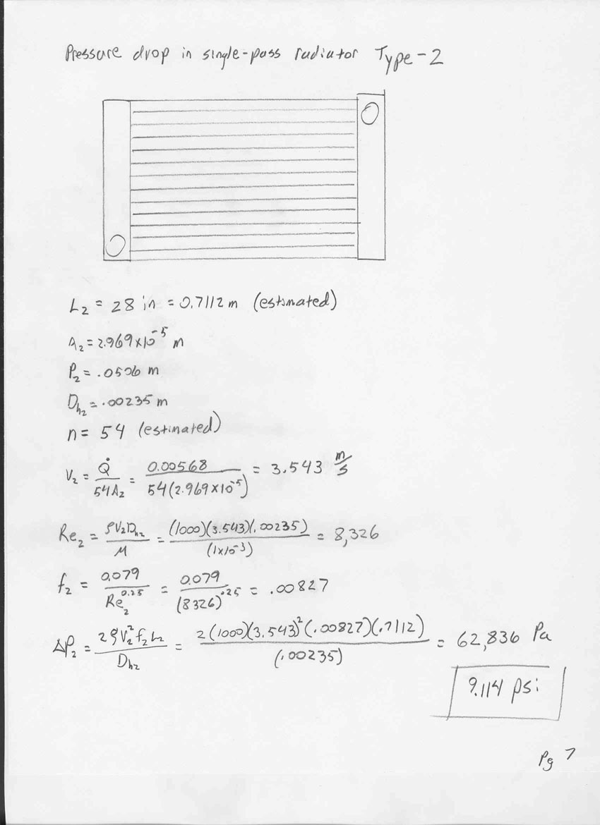

STANDARD CROSS FLOW TO DOUBLE BYPASS RADIATOR COMPARISON
(Using the shade tree engineer numbers because I can't understand Adam's numbers enough to be able to calculate with different initial numbers.)
Standard rad. 5.8 PSI drop
Double Bypass with 1/2 the cross section and double the distance. Something that's confusing me here though is that the Standard rad has the same exact same wall area as the double bypass.
So 1/2 the cross section area adds 5.8 PSI to the drop and double the distance also increases the drop by another 5.8.
So 17.4 PSI total drop for a double bypass rad? So 3 times the drop going from standard to double bypass.
Just a guess here Adam. Please if you only do one more calc make it the comparison of the standard rad to the double bypass instead of the PSI horsepower conversion.

OK, so here you go. I did both single pass designs. I had to guess at dimensions for the cross flow design however.

pg7

""That being said, when you go to a radiator shop that does business with Griffin, Becool, or whatever, they will only be interested in four or five things, your HP, the size of your tubes supplying the water to the radiator, where YOU want the inlet and outlet tubes, whether you want straight or bent connectors and if you want a radiator cap or a plug for a vent line.""
Ahh, but where did you get your information? Did you copy from a previous builder or did you ask where and how they got those figures?
I think if nothing else this has been an exercise that demonstrates the enormous amount of thought that can go into a vehicle in the design and development stages, especially one that may be raced.
""They probably use the formulas mentioned earlier in their computer to determine what is needed.""
Building a GT40 is different things to different people, it all depends how far you want to go. I want to know what is needed and WHY it's needed before I even go to the rad builder.
""If you want to go to double pass, then they will build it, but it will cost you much more than is needed to. Besides, you have those cooling fans, right??""
Most of the cost increase is incurred in the difference between an upright flow and a cross-flow, due to the base cores used to construct. 600.00 for a cross flow, 900.00 for a upright with these dims, regardless of double bypass.
In an optimized system cooling fans are only necessary for when the vehicle is moving slowly or stationary. At speed they shouldn't even turn on.
""As to weight, the numbers are interesting from a purely discussion point of view, but I think with 4-600 HP,,,,,,who cares. My wife's overnight bag weighs more than that!!! Bill""
Racing builders and teams will kill for a few pounds. Let's see going from a
1-3/4"x.049 tube (original car) at 40.8#'s (tube/coolant),
to a 1-1/2"x.035 tube at 28#'s you just saved
13#'s. THIRTEEN POUNDS.
