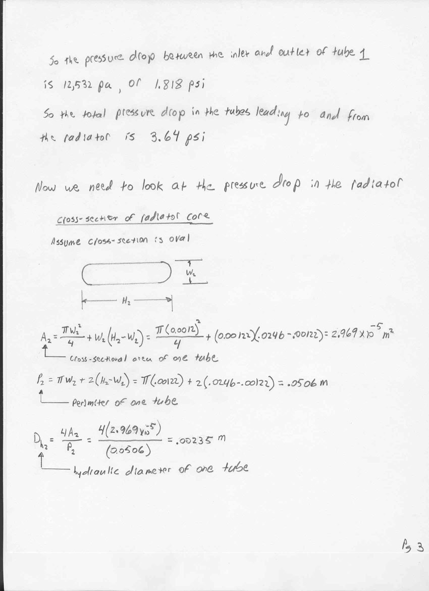

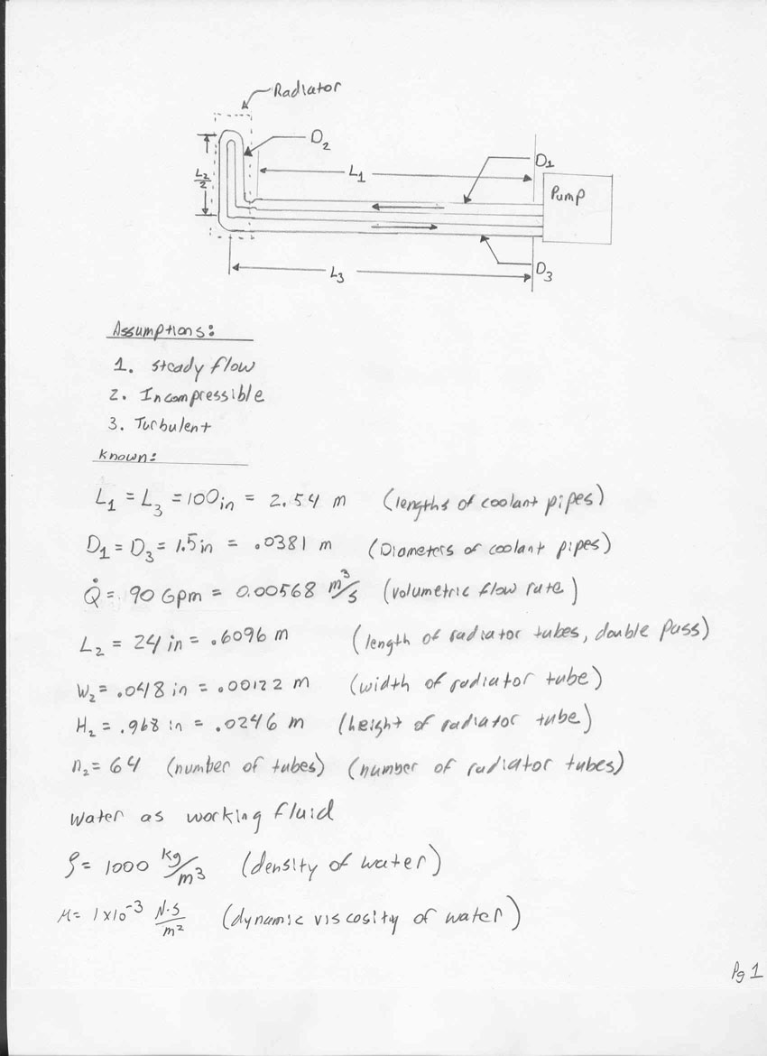

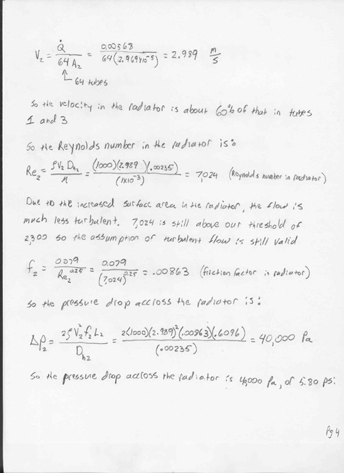

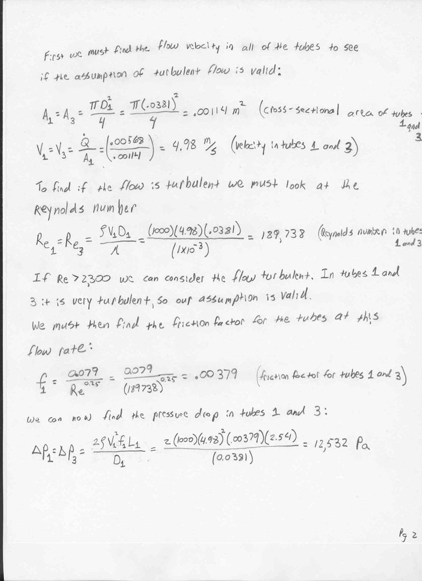

Let's crunch some more numbers and see what dominates, the radiator or tubes.

OK here are the sizes, carefully measured with wire gauges made up of bailing wire, wire feed wire, electric fence wire (reminding me of a shocked cat), solder wire, and a couple other wire sizes that were laying around. Inserted down in one of the rad tubes via the inlet neck of the radiator. The bailing wire came the closest at .048.
The outer dims of the rectangular tubes are 1.00 x .080. So with the .048 wire fit, that means a wall thickness of .016 which sounds about right. So the inner dim is .968 x .048.
The ERA spec rad has 2 rows of tubes with 64 tubes per row so total 128 tubes @ .968 x .048 x 12" long. Or 64 tubes 24" long with a double bypass. At first I thought why not just add up the cross sectional area, which totals 5.95 sq. in. which is way more than the 2.4 sq. in. of the 1.75 tube. But I'm guessing you can't do that because of that FRICTION culprit, which exists at the walls of the tubing. So somehow you have to bring the wall area into the equation.
I think you need to compare the ratio of wall surface to cross section area of the total rad tubes to the same ratio of the transfer tubes.
I'll compare total cross section and total wall area. I'm assuming it's correct to only compare the transfer tubes going one way to the radiator because of the series/resistance thing. (Maybe that's why on some production cars the return line is smaller than the supply line to the radiator, hey why can't we save some size/room/weight here too?)
OK, a 1.5D tube has a cross section area (A = pi*(D^2)/4) or (pi x radius^2) of 1.77 sq. in.
the wall surface of that same tube with a circumference (pi x D) of 4.71" x 108" = 508 sq. in.
So the ratio of cross section to wall surface of the 9' x 1.5" tube is 1.77/508 or about .0035.
The radiator has 128 tubes with a total cross section area, wait a minute, let's go with a double bypass. So the radiator has 64 tubes .968 x .048 so total cross section of 64 x .968 x .048 = 2.97 sq. in.
The total wall surface of the rad tubes .968 x 2 + .048 x 2 x 24" x 64 = 3,121 sq. in.
So the ratio of cross section to wall surface in the dbl bypass rad is 2.97/3,121 or .00095.
so comparing the two ratios .0035/.00095 = 3.68. So this radiator has 3.68 times the resistance/FRICTION of the 1.5"x 108" tube in question.
This is shade tree engineering math only, it may be TOTALLY incorrect, please grind the numbers Adam.

Good try, you are on the right track. No laughing here, I just like to see others give it a shot so I don't feel like I'm just lecturing into cyberspace and the whole class is asleep.
Using your dimensions for the radiator, I worked the problem using an assumed flow rate of 90 GPH. This is half what stewart warner quotes at 8,000 RPM. The calculations are somewhat long, so I am just going to post them as attachments.
Buckle your seatbelts, here we go!
