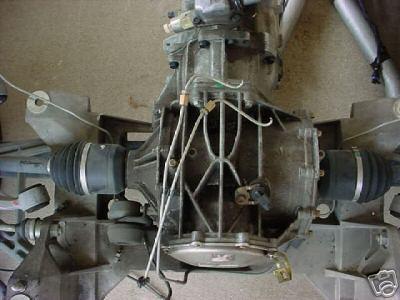

[*] The Corvette C5 / Z06 6-speed. Too big for a GT40 and would need to be adapted from torque-tube configuration to standard clutch setup. Capable of handling lots of power. Cheap - I saw the one in the attached picture go for less than $500 on Ebay a couple months ago.
I considered the C5 transaxle (well...it's kinda a transaxle hehe) but I think it will push the engine too far forward. The car in question is dimensionally simmilar to a GT40 in size and wheelbase (slighly longer) but it's still in the mockup stage.

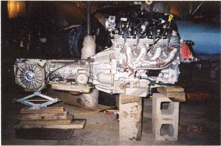

This is a pic I found of a LS1 bolted directly to the C5 transaxle, in case anyone was interested.
James

But, just looking at the pic, the trans tip to centerline of the half shafts is about 30" or so. Total, there would have to be 4'8" worth of engine bay just to get the combo to fit. Don't see that happening.
Audi 5spd will most likely be what goes in.
