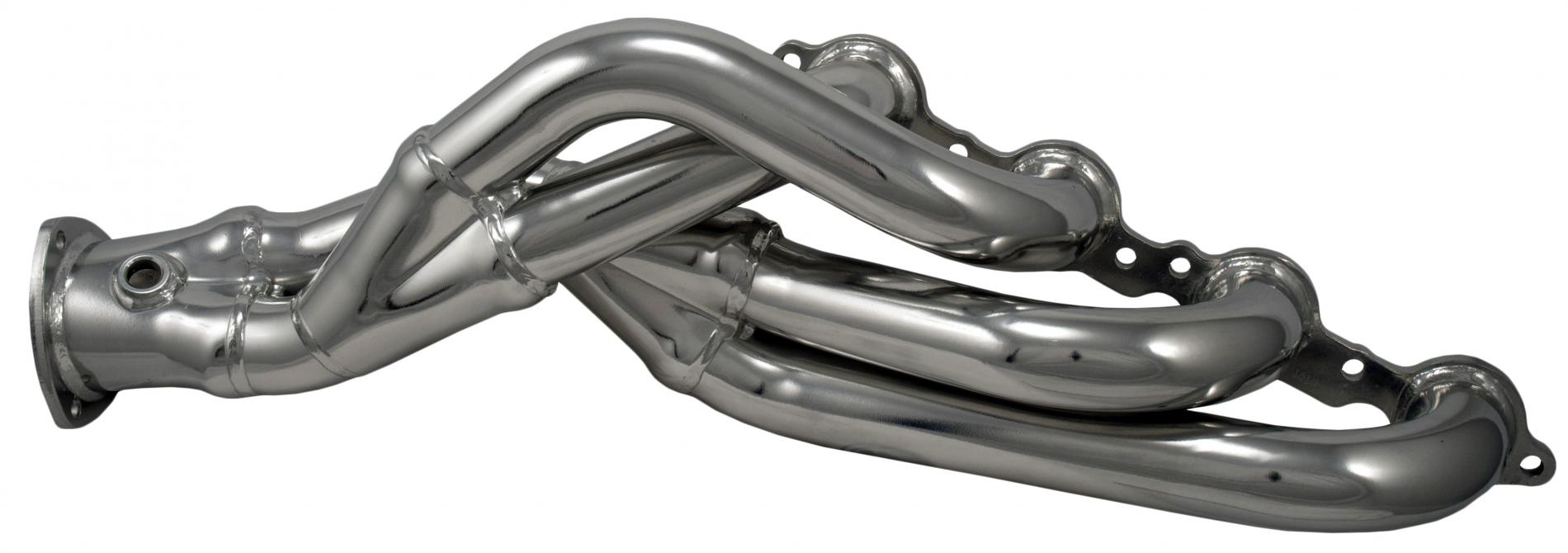

Secondly, you could simplify further by using conventional shorty up and forward turbo headers ( https://www.summitracing.com/parts/big-12152flt ) and bringing the two main pipes together above that same area as they run toward the back of the car.

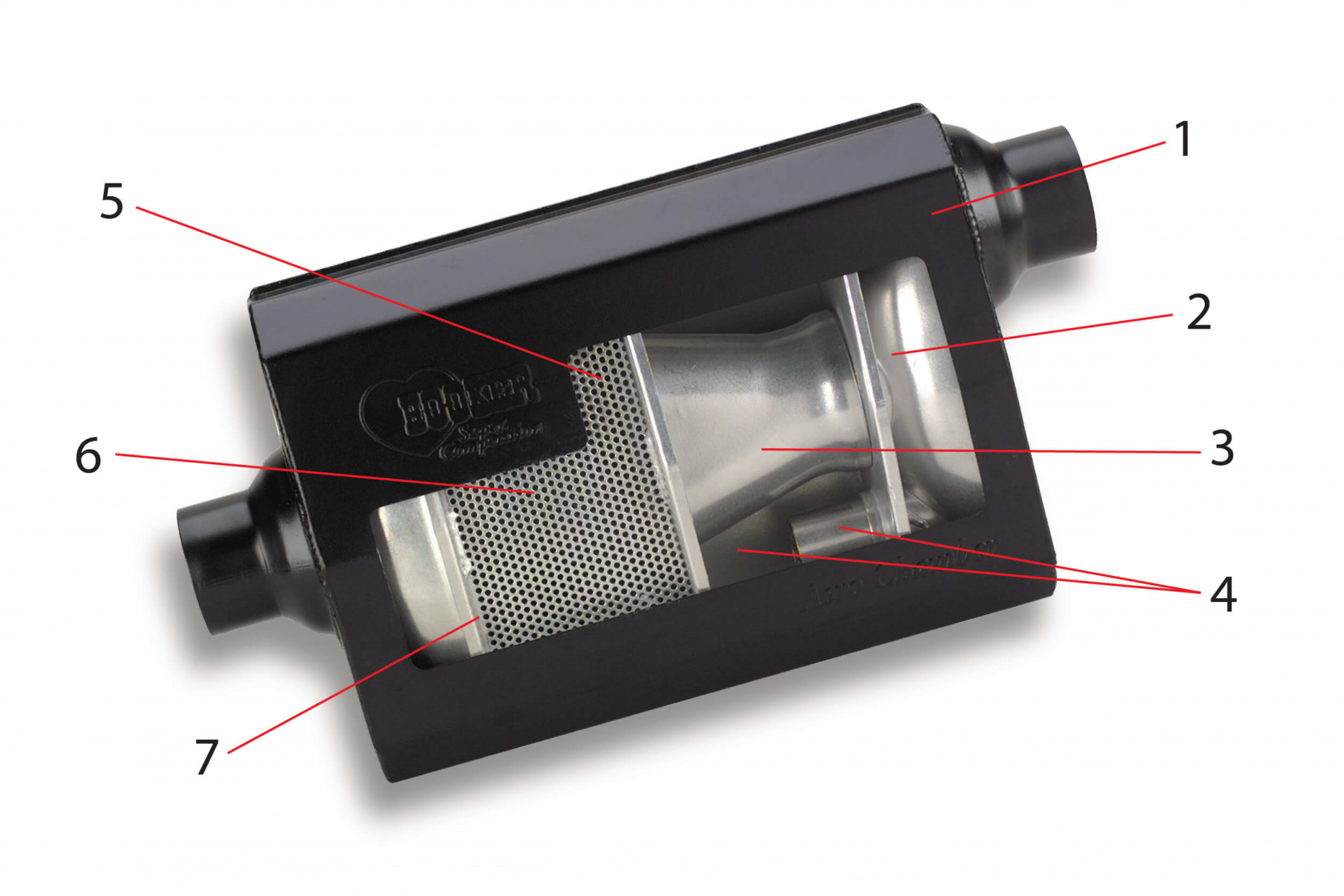

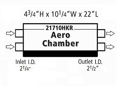

Hooker Aerochamber muffler. 21720HKR. Single inlet, dual outlet. Single inlet can be simple converted to dual inlet by welding a connection pipe on the oposite side.
Its the same muffler as the 21710HKR I am using that has dual inlet, dual outlet but that one seems to be sold out everywhere.
This muffler has a collector inside & an expansionchamber as secondairy chamber.
But any Aerochamber muffler can be converted to dual inlet, dual outlet. I am using these mufflers on all my toys.

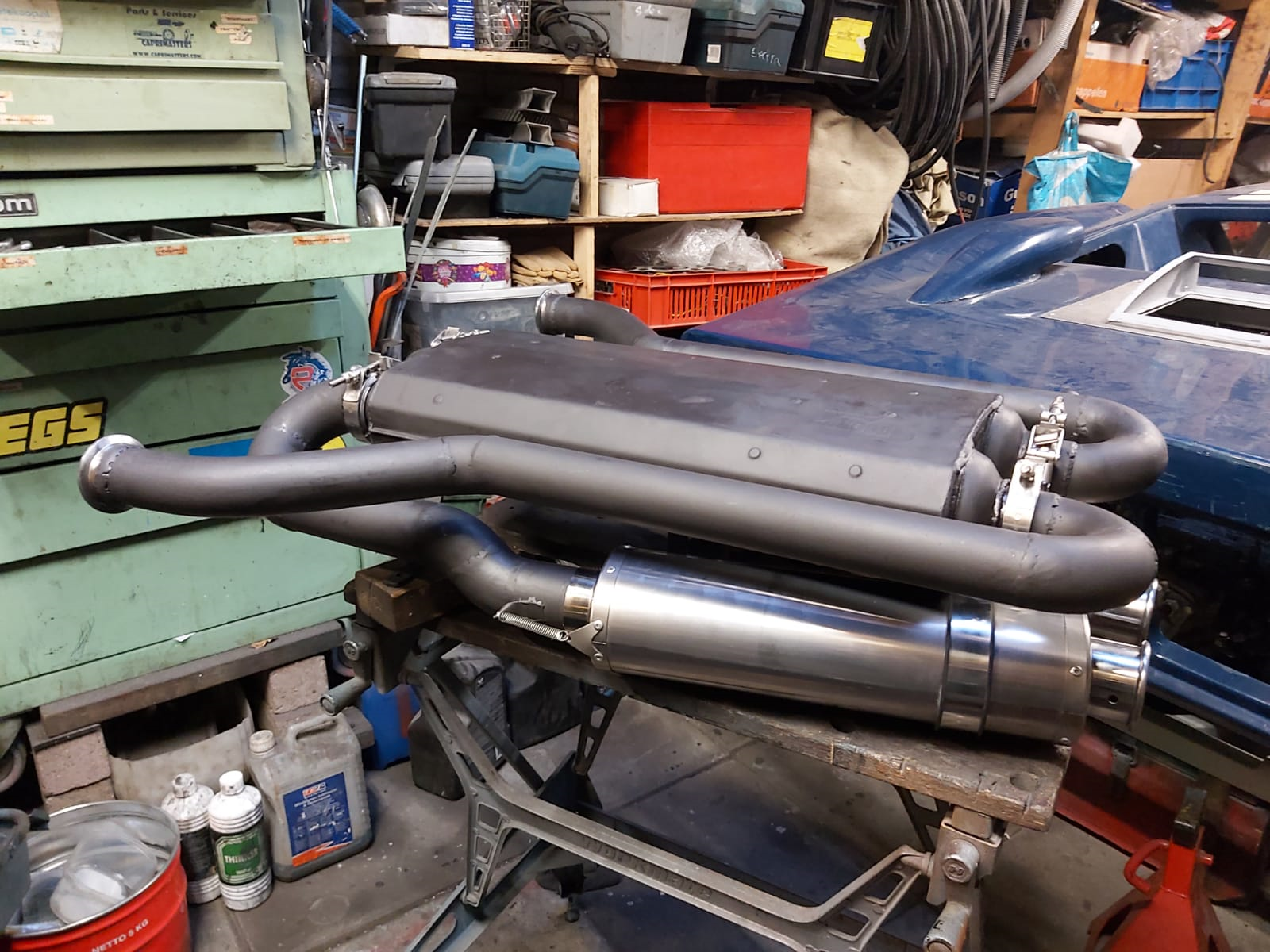

This is my outside the box thinking creation
Basicaly what Jac Mac describes, 4 into one, 2" narrow pipes to speed up exhaust gasses, the collector chamber will act as a balancingpipe. The second expansion chamber will help scavenging. I added two titanium slip on akropovic mufflers as insurance for DB regulations.
Engine did not run yet as I am not finished.

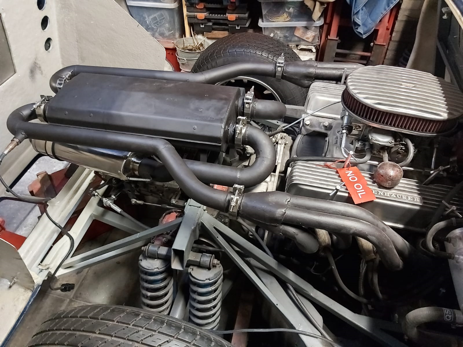

I should point out that I built my own mufflers, that way you can tailor the size etc to the space you have available. Be careful looking for mufflers off other cars that might fit the space ,but are designed for 1 in /1 out on each end from some front wheel drive applications.
