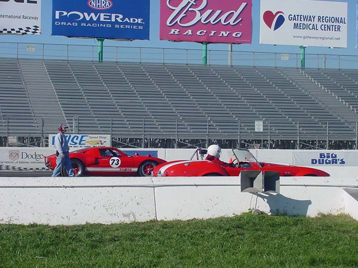

I watched Rick at the tree and I still think his launches were still a little on the safe side. I really think his times could have been a little quicker.
