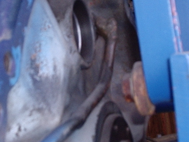

Hello
My experience is:
High rpm kills the ford smallblock engines with stock blocks. A simple modification of oiling system solve partly the problem though.
An external 1/2" oil line mounted with a T unit at the oil pressure senser mounting. Locate the oil tube on the left side of the engine, goes to rear of the engine block where main bearing oil line is(between flywheel and block). Second problem is the rods, they need to be replaced with steel units that are made for hig revs.Your heads and induction system needs no other attention than a service.
The most important, the valve train, NOTHING else than a roller camshaft combo will do the trick of streetable race engine combo. Reed cams (reedcams.com) has the perfect choice, the R300ULX 300 degree roller with ,667" lift with 1,6 roller rockers.Other cam manufacturer have of course usable products but personally I like the reed factory because of their high quality products. In the early 90 s I had a dragster with a 500 cui ford 385 svo racing engine, block, crank, heads an a intake for a single holley dominator carburetor. We used a REED all roller valve train in that motor. The camsaft was an earlier version of the R332ULX, 332 degree and ,817" lift. The engine cranked 887hp at 7800rpm and had a steady 800rpm idle with maximum 9500 rpm that is aboat the best you can get.This engine is now used in a street car. That is the reason I´m recommending reed and the R300UlX camshaft and related parts. Using roller camshaft makes the engine produce better low and mid range power without reducing top rpm power
regards
Ingvar
