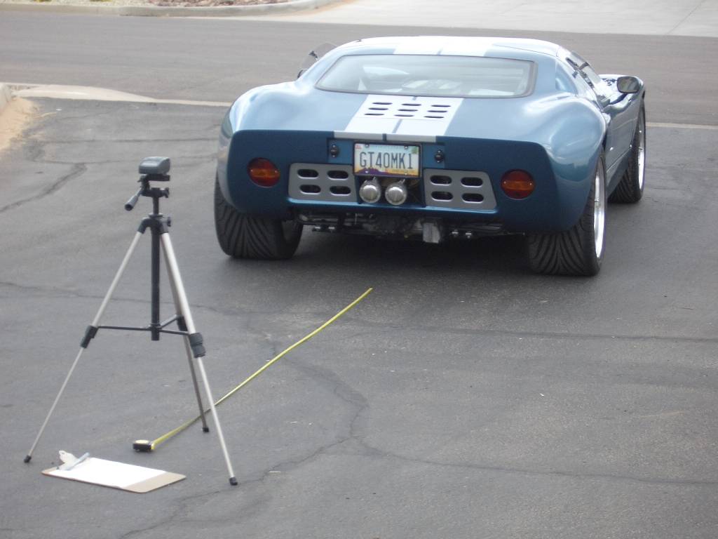

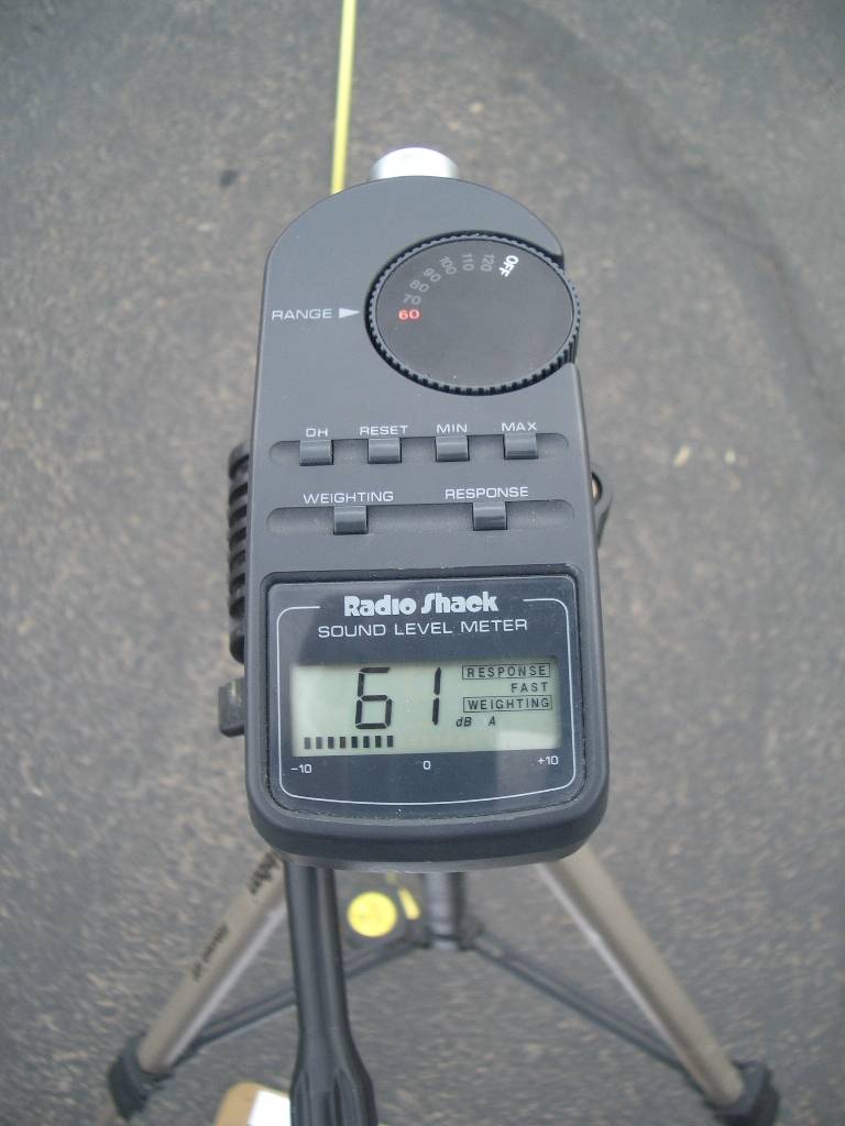

All measurements were made with the db meter 3 feet high and 10 feet directly behind the muffler. I used a medium quality Radio Shack brand meter set to the A-Scale. I also borrowed two brands of baffle mufflers to test but I cannot find the actual numbers I recorded (how convenient). Nevertheless, both brands of baffle mufflers were VERY noticeably louder than the stock CAV muffler so I returned them to the owner. The mufflers tested are listed below. I concluded that the stock CAV muffler is actually pretty good. A 3 db reduction was easy to get just by adding the SuperTrapps but I do not know how horsepower was affected. I do know Frank Catt has done a lot of work on this with a design of his own and maybe he would have something to say here. Here is my data, meager as it is, and with some missing records and a few pictures:

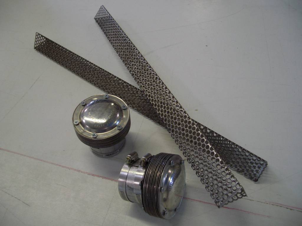

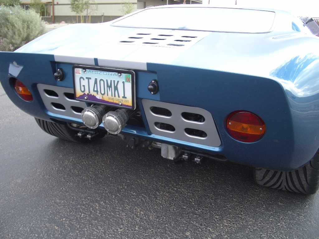

B 1 CAV + 2 SuperTrapp (P/N# 444-2503 4 in diameter with 12 plates)
C 1 CAV + 2 SuperTrapp (P/N# 444-2503 4 in diameter with 6 plates)
D 1 CAV + 2 home-made baffles (1 ½ in equilateral triangle x 24 in long)

B-----81----82----88----91
C-----77----81----85----88
D-----83----81----88----89

thanks for the great input! I have the same basic Radio Shack sound meter and was going to do the same types of measurements.

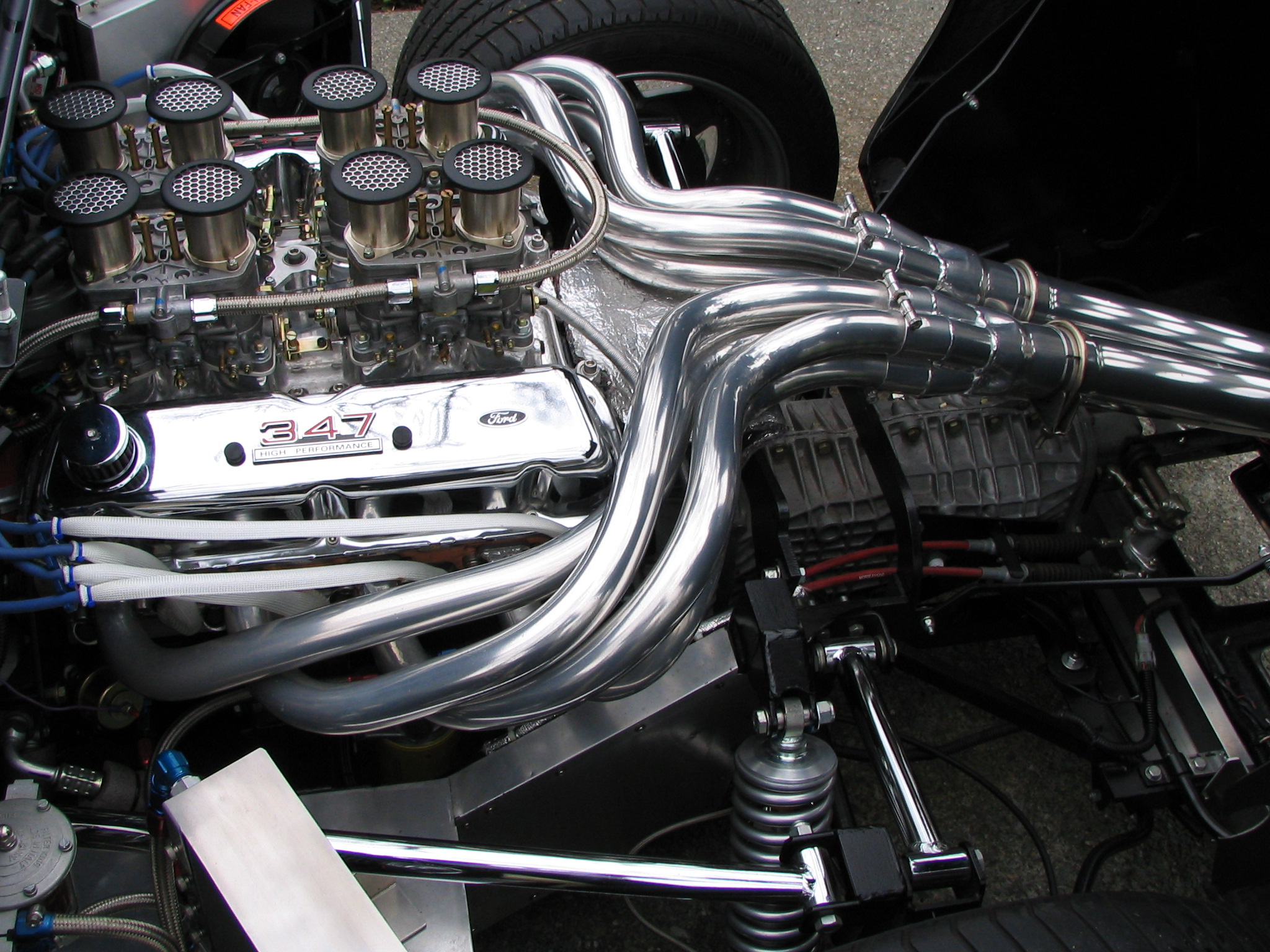

Here is the link. http://www.carchemistry.com/tubemufflers.html
If you call them they will make any sizes/length you like. You can have up to 3 inserts inside for the sound. Mine are 3" in/out about 15" long (I think). They come ceramic coated

Faili F.-That engine is incredible looking! Looks very nice.
