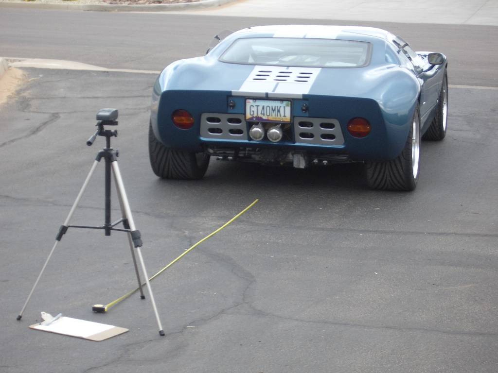

All measurements were made with the db meter 3 feet high and 10 feet directly behind the muffler. I used a medium quality Radio Shack brand meter set to the A-Scale. I also borrowed two brands of baffle mufflers to test but I cannot find the actual numbers I recorded (how convenient). Nevertheless, both brands of baffle mufflers were VERY noticeably louder than the stock CAV muffler so I returned them to the owner. The mufflers tested are listed below. I concluded that the stock CAV muffler is actually pretty good. A 3 db reduction was easy to get just by adding the SuperTrapps but I do not know how horsepower was affected. I do know Frank Catt has done a lot of work on this with a design of his own and maybe he would have something to say here. Here is my data, meager as it is, and with some missing records and a few pictures:

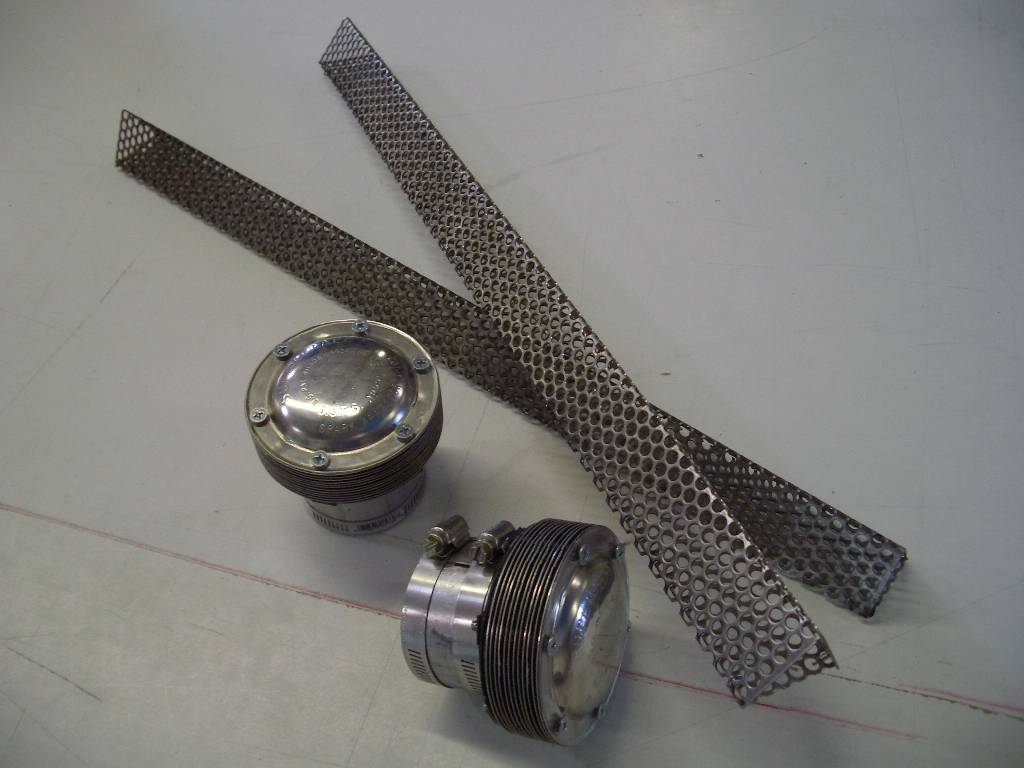

D 1 CAV + 2 home-made baffles (1 ½ in equilateral triangle x 24 in long)

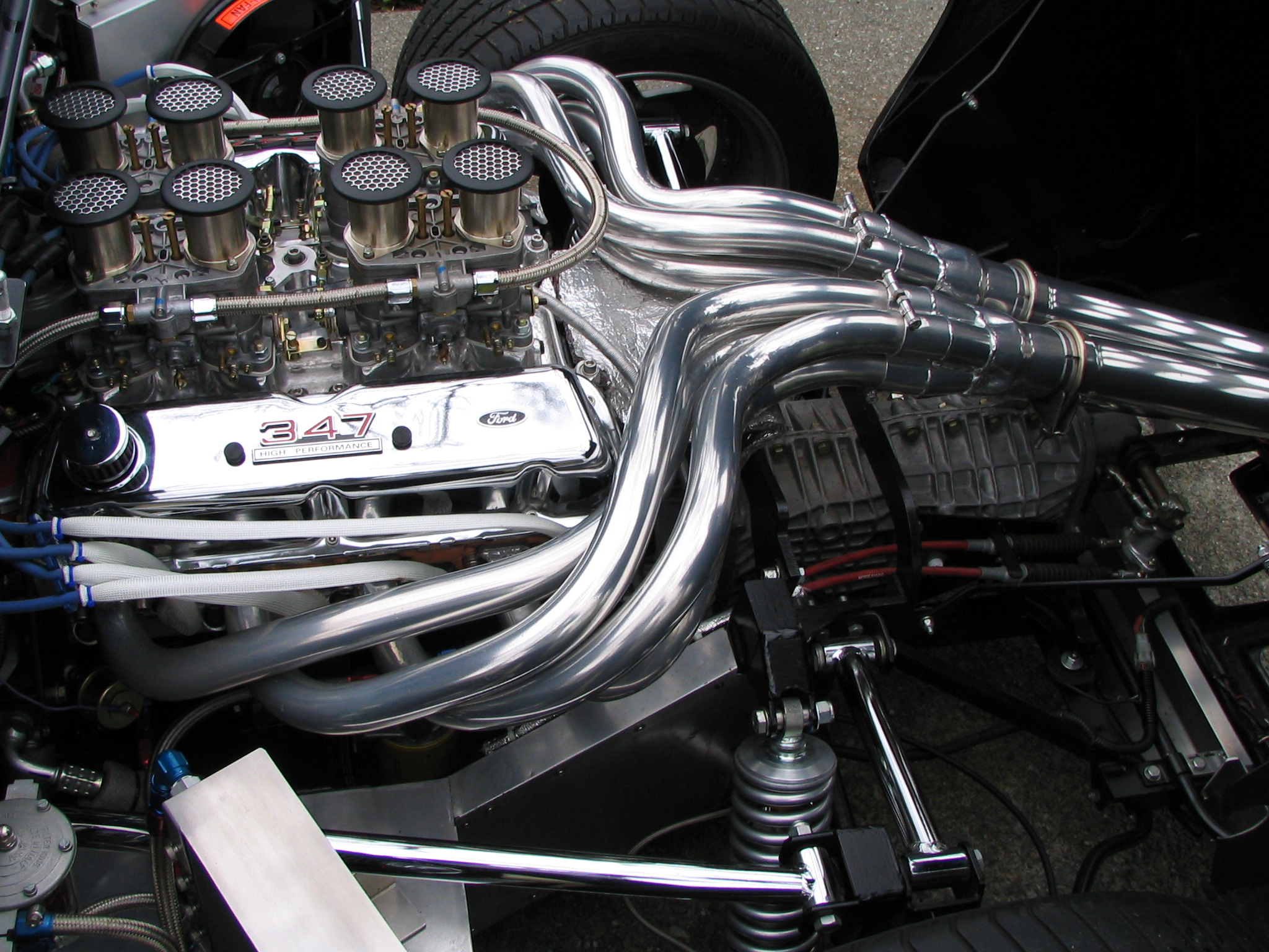

Ping Farhad Faili - he just put some new mufflers on his after the 347 stroker installation - they sound great - I think that they will be loud enough for you on the outside!
Graham ("Wine cave man" - cuz he digs caves for wineries here in the Napa/Sonoma counties in Calif.) has an original GTD with straight thru pipes. If he keeps it around 3000 - maybe 3500 rpm it's not TOO loud - - but after that it's basically wide open so you get full song - sounds great, but the local constabulary knows exactly which streets he's on anywhere in the county!!
cheers
Dave Harris- Thank you for the information. I really appreciate it a lot.
Faili F.-That engine is incredible looking! Looks very nice.
