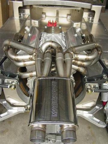

The one that is on my RCR40 is a Magnaflow. Exhaust is 2" tubes. It looks bigger (longer) in the photo and I was assured that it would be loud... Mission acomplished I don't have the model number but should not be too hard to find from their site.
[edited, forgot the photo]

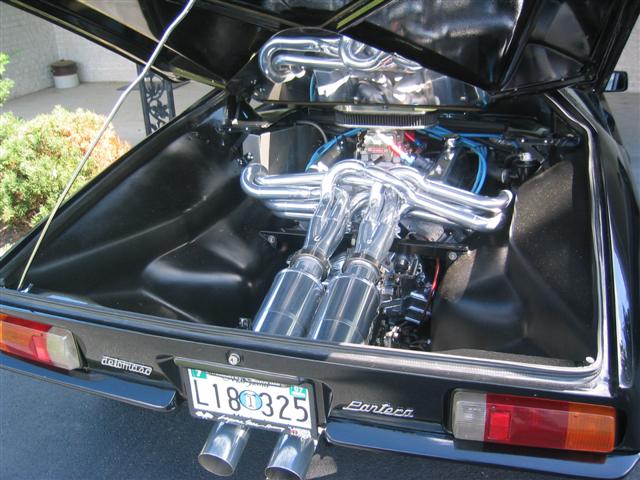

My Pantera has 180 deg. headers with two seperate Magnaflow mufflers. To me,at idle nad cruising speeds,it isn't too loud.At full throttle,it is quite loud.It has an incredible sound!!
Ron: you are absolutely right about the single muffler masking the crossover sound.I tried several; configurations on my car .A chambered muffler(Flowmaster,etc...) will also mask the crossover sound.

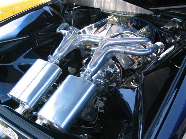

One of my old configurations.
